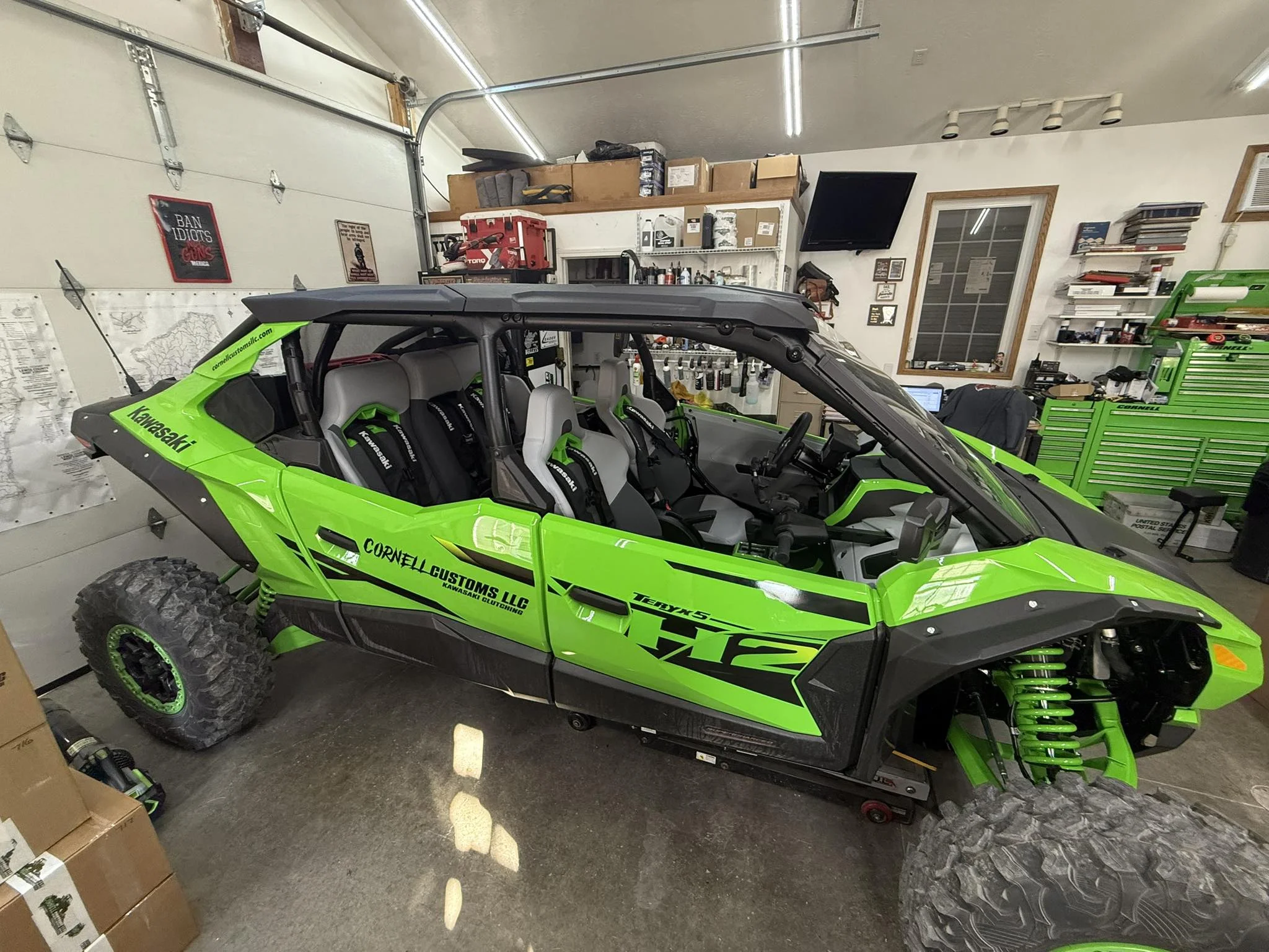

Did a little playing around with the H2 Sunday, didn’t do any timed runs as I just wanted to get a “seat of the pants” feel for it.
Really happy with the results so far, I’m running the KWI Hyperdrive weights with 3 screws in the holes closest to the tip and our overdrive spacer links and delrin washer on the factory spring, I tried different lengths and stiffness of springs but the factory spring works best with this setup….
Nice smooth low engagement and the power comes on lower and gets rid of a lot of that initial lag on the bottom, I saw 103 speed wise and it was still climbing but here in WV not a lot of room to run that fast for very long, I was impressed with how smooth and planted the machine felt at high speed.
I’m still sourcing a different belt that will allow us to work on getting some lower gear reduction with secondary modifications but today was just a fun ride
