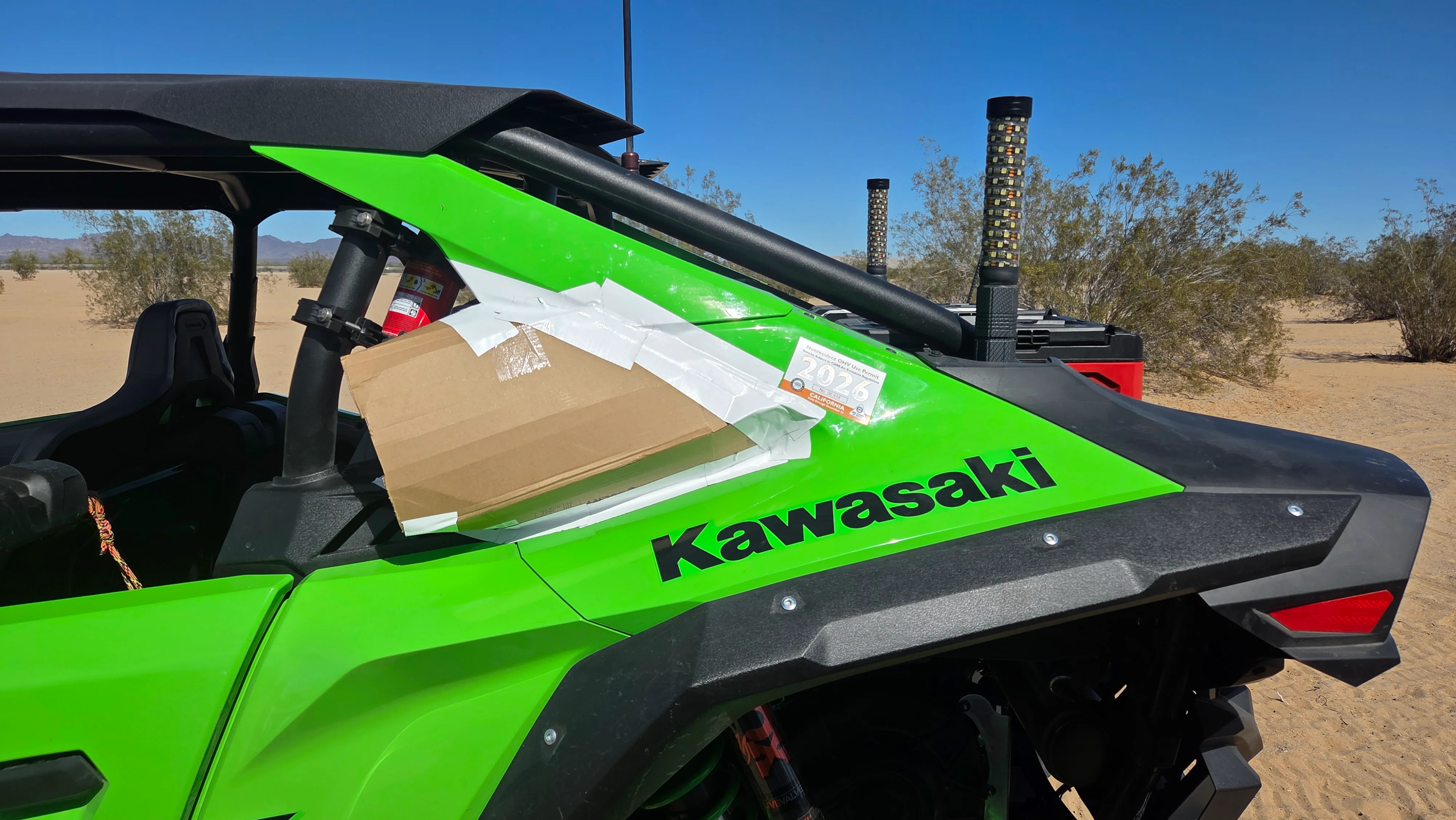

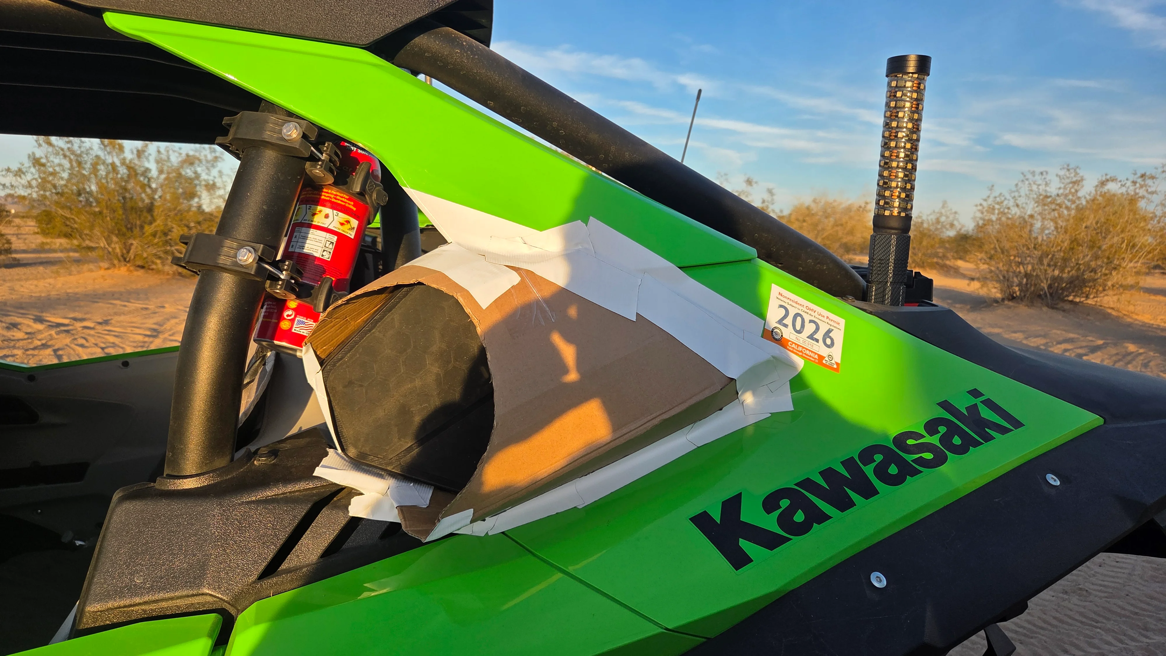

I tested a ram air scoop i fabbed from some cardboard in the dunes. I think it actually worked some if you ran above 25-30 mph, but it may have been counter effective idling and slower speeds. It was fun to try.
I do know, I've put my leaf blower on the stock inlet and held my hand behind the outlet when it was hot and it pushed so much air through that it felt like a blast furnace. That outlet is in a ridiculous spot sandwiched between the header and exhaust pipe. Should have been straight out the back.
I think thats what @Raidernut was seeing with his RPM fan.

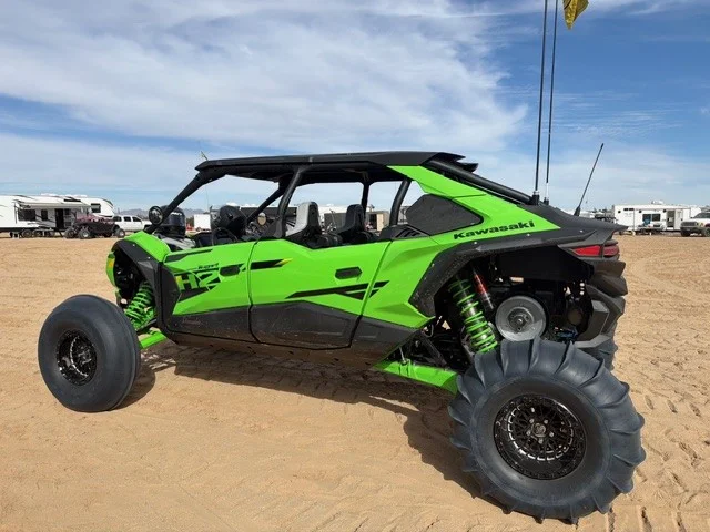

I have not measured them. I have other friends that run them and I believe they said it measures a true 34". It is a big tire and a hell of a lot cheaper than STUs, Sandcraft, or Rogue tires. I got all 4 tires for less than what a pair of rear 35" tires are from the others. You can also order them comp cut from Packard if you want to shave some weight.
Yeah, they look good! They have to be pretty close to the same size as SS365. I don't think there would be a noticeable difference. I just don't want to have different proportions.
