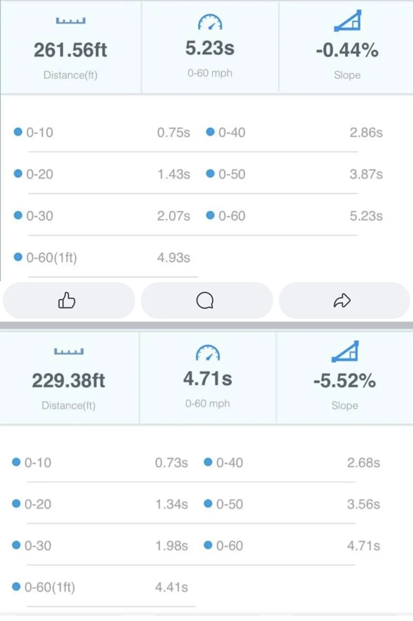

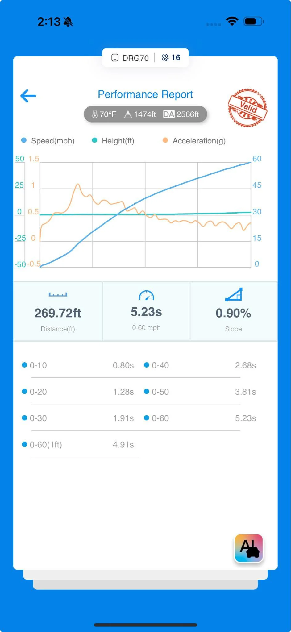

We have been testing the KWI Hyperdrive weights and have improved our 0-60 times from 5.23 to 4.87, the engagement is now lower and very smooth and gets rid of a lot of that hesitation on the bottom end.

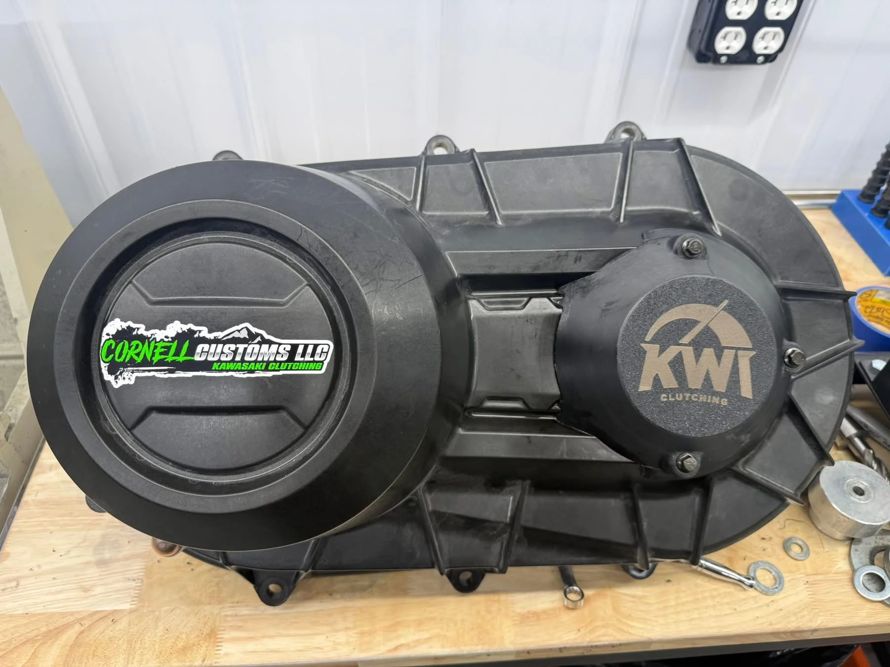

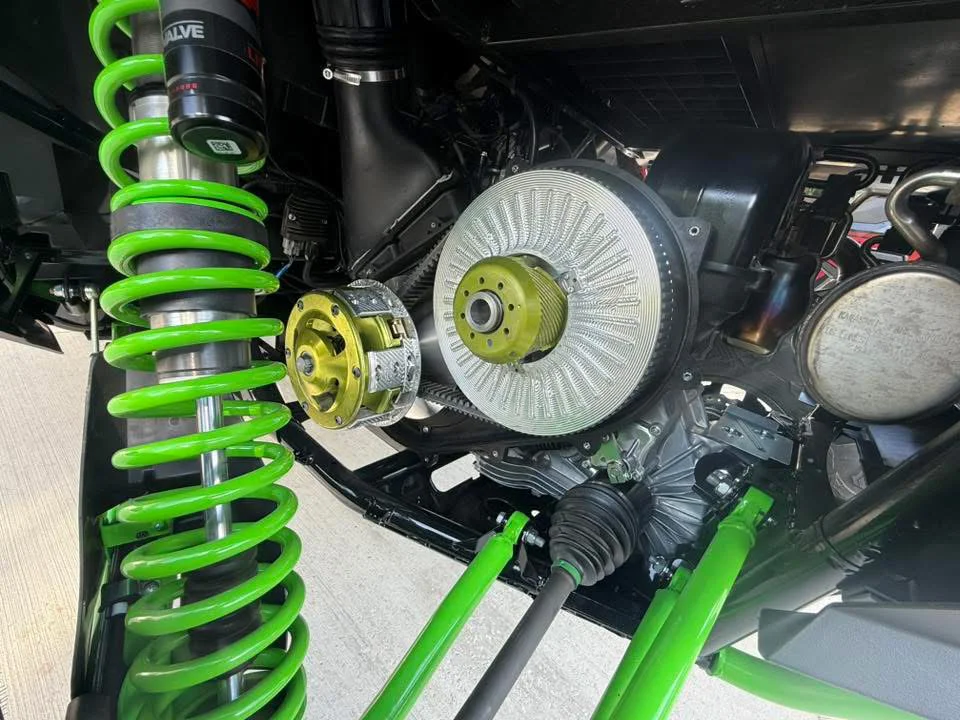

KWI Clutching
May 8, 2026
Did some testing with the KWI Clutching setup today and it’s gonna be good news for the rock crawlers!!
Nice smooth low engagement at around 1500 rpm, it can crawl a 25% grade at 1-2 mph.
15% reduction and was still able to hit 96 mph before hitting the limiter!!
But…. We think we can make it even better, even lower engagement!
Stay tuned, the primary is going back to KWI for a couple more modifications and we’ll be doing more testing when we get back from Moab on the 26th.

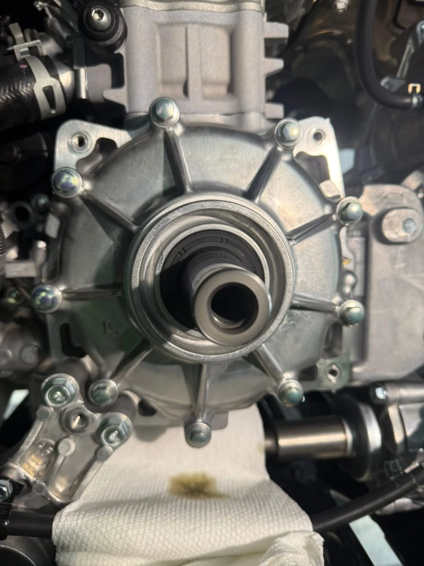

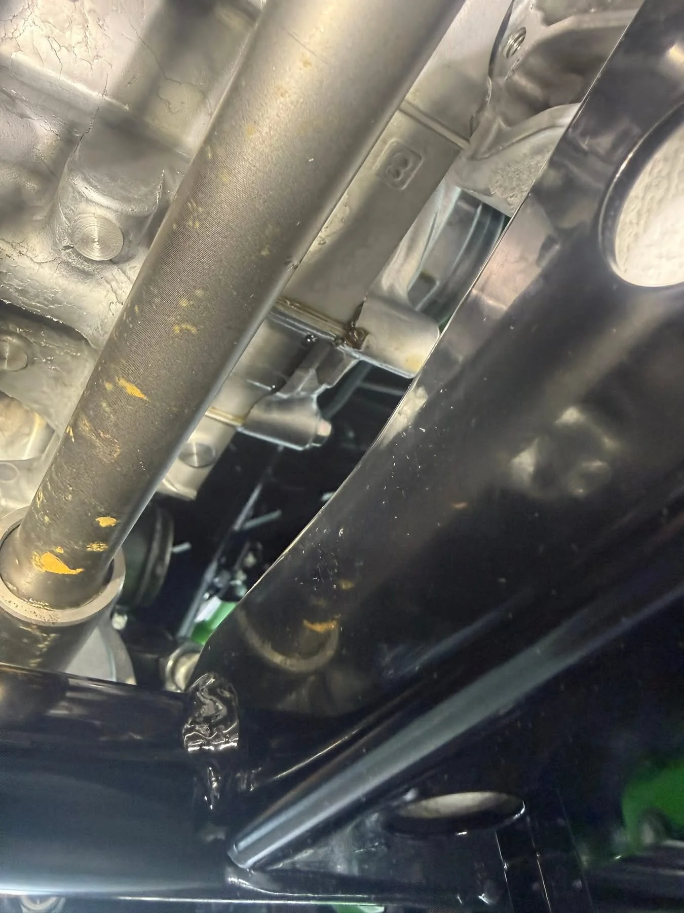

Oil leak on the H2, might want to check…
After doing some clutch testing yesterday I had a lot of oil in the skid plate and over the engine / transmission, got it all degreased today and removed the clutches and enclosure and found the leak, all 9 of the bolts on the drive pulley shaft cover were loose, not just a little loose but not even finger tight, I torqued them all to spec (13 foot lbs / 156 inch lbs) and the leak seems to be fixed..
Something you may want to check / keep an eye on.

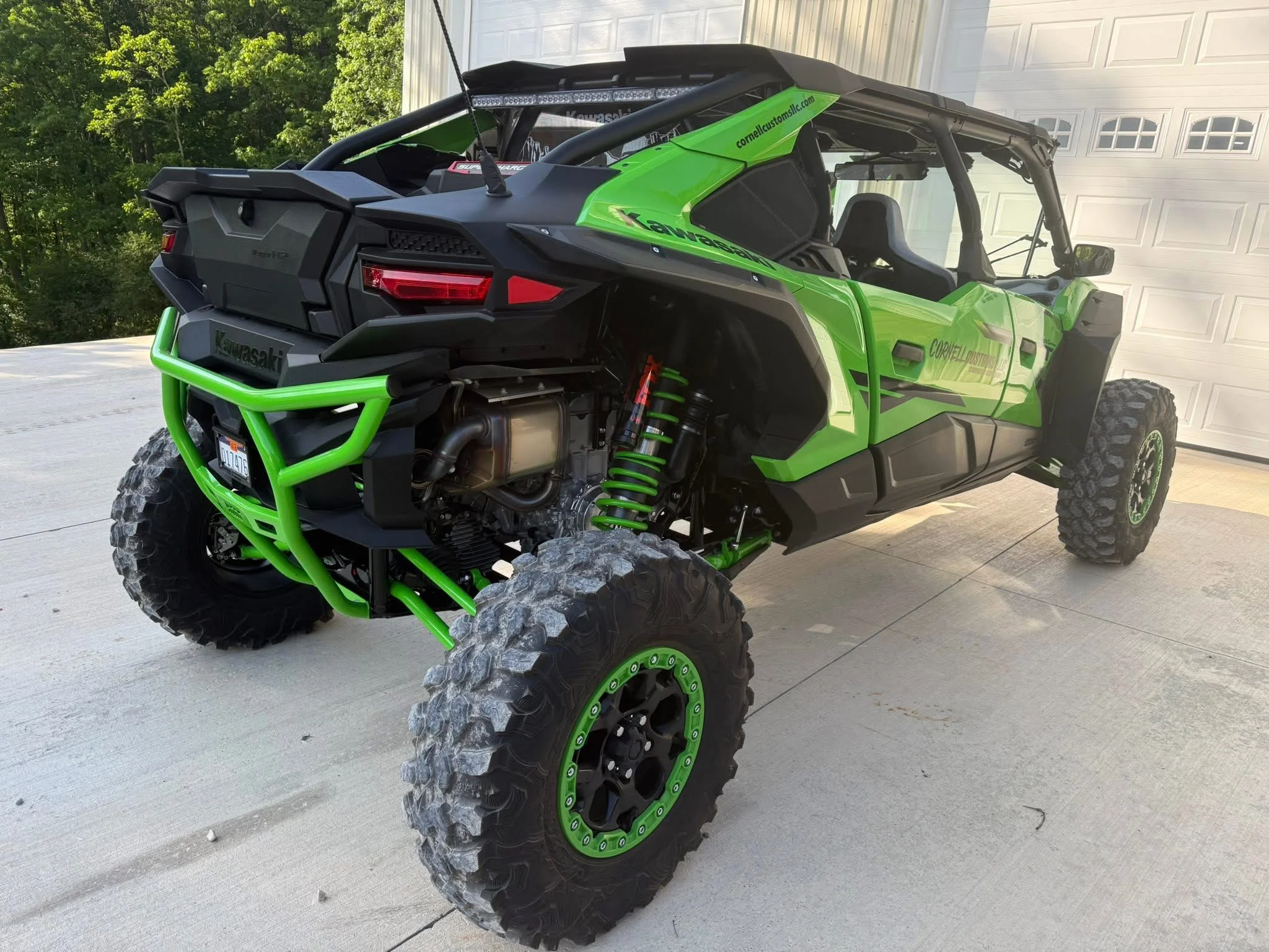

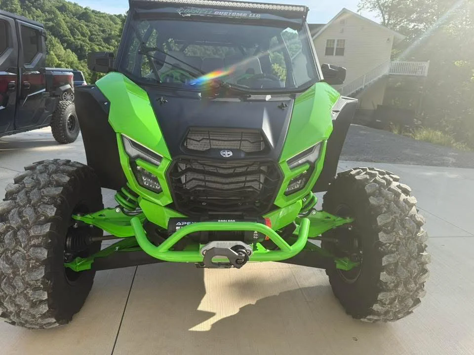

May 29,2026

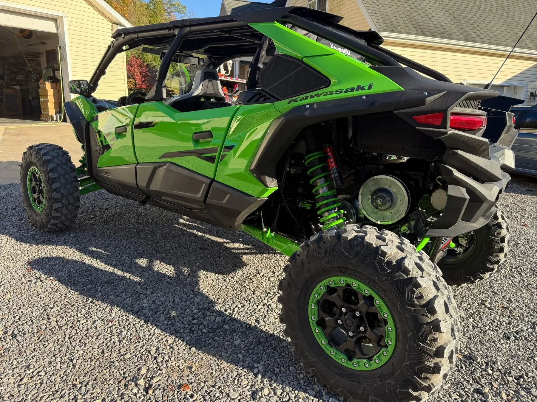

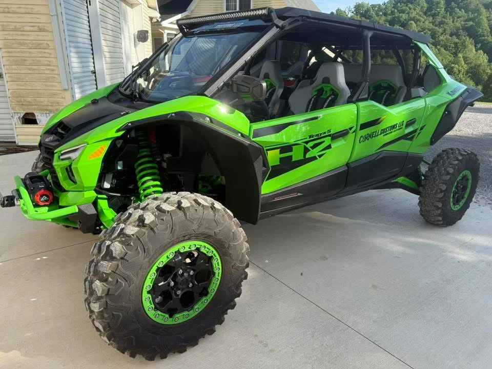

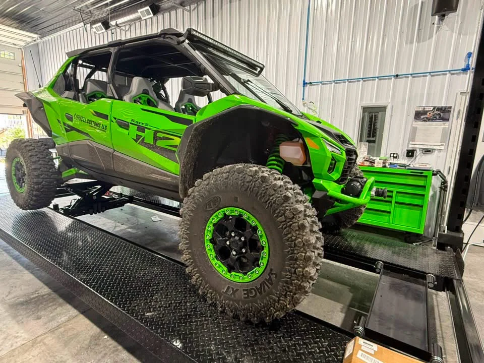

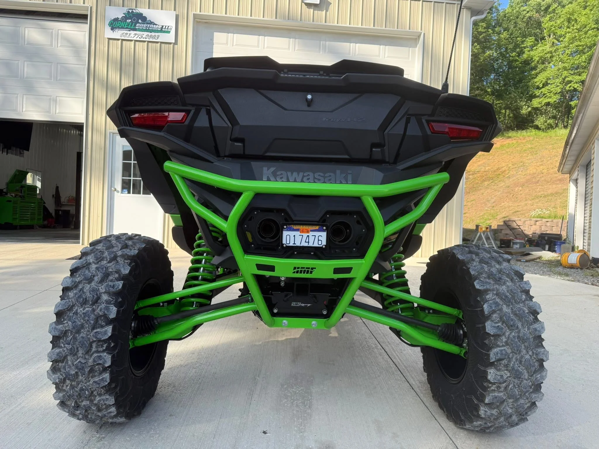

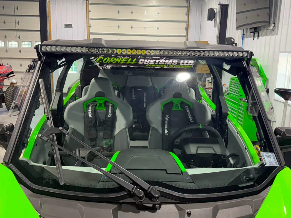

After this thing’s been sitting all winter time to get to work on it!!
A15D winch bumper and 5500lb winch
HMF rear bumper and hitch
Kawi tail box
Kawi A-Arm and Trailing arm guards
Kawi wide fender flares
Kawi light bar
Chase light with turn signals/ backup lights
Kawi glass windshield and wiper kit
Skid plates.
WD street legal kit

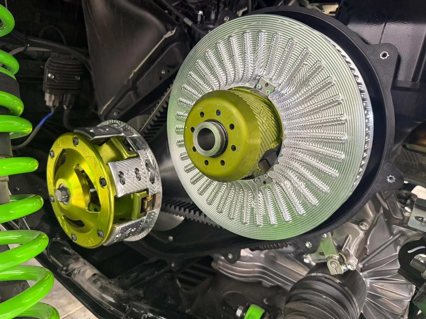

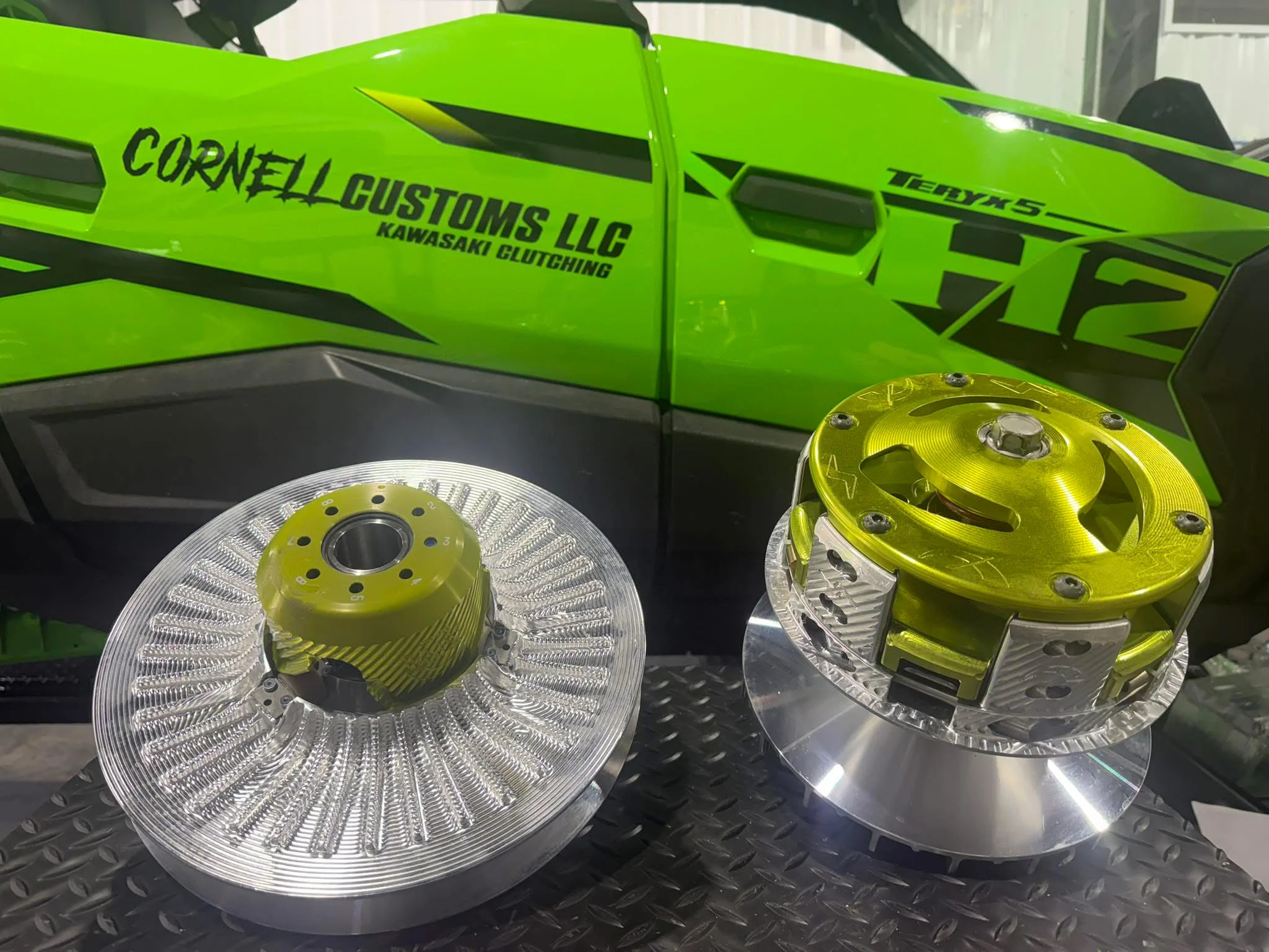

And….. THE KWI Clutching billet primary and secondary which we are getting dialed in for crawling… currently at 15% reduction and still able to hit 100 mph, plus super smooth low belt engagement!!
June 5,2026
15% clutch reduction and still able to get to 100 mph
The new KWI Clutching Fusion billet primary and secondary are working awesome, super smooth on the bottom end with belt engagement right above idle, you have the ability to run different belt lengths and weight profiles to set up the clutching for slow crawling (which is how we currently have ours set) or wide open desert racing.

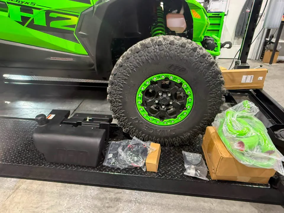

July 7,2026
Lots more stuff to get installed on the H2….
Evolution Powersports. BRV, charge and recirculation hoses, and catch can.
RPM Powersports. Auxiliary fuel tank.

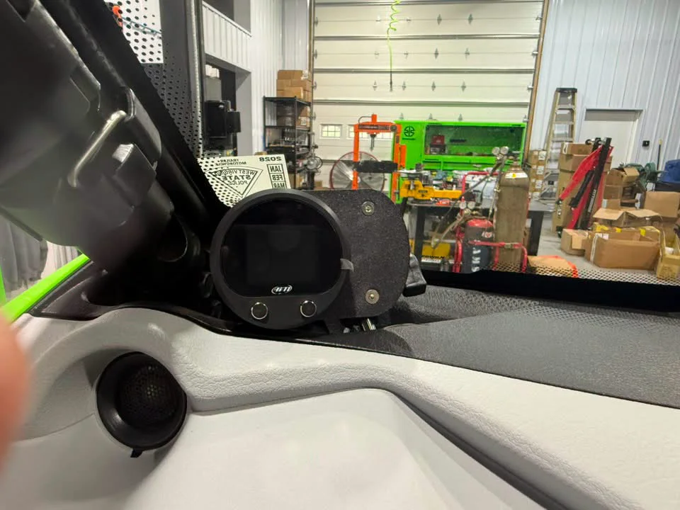

AIM infrared belt temperature gauge.

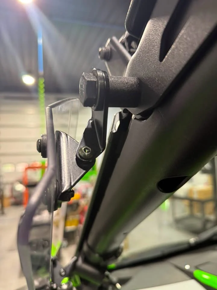

Tusk wing vents (highly modified to fit)

July 12,2026

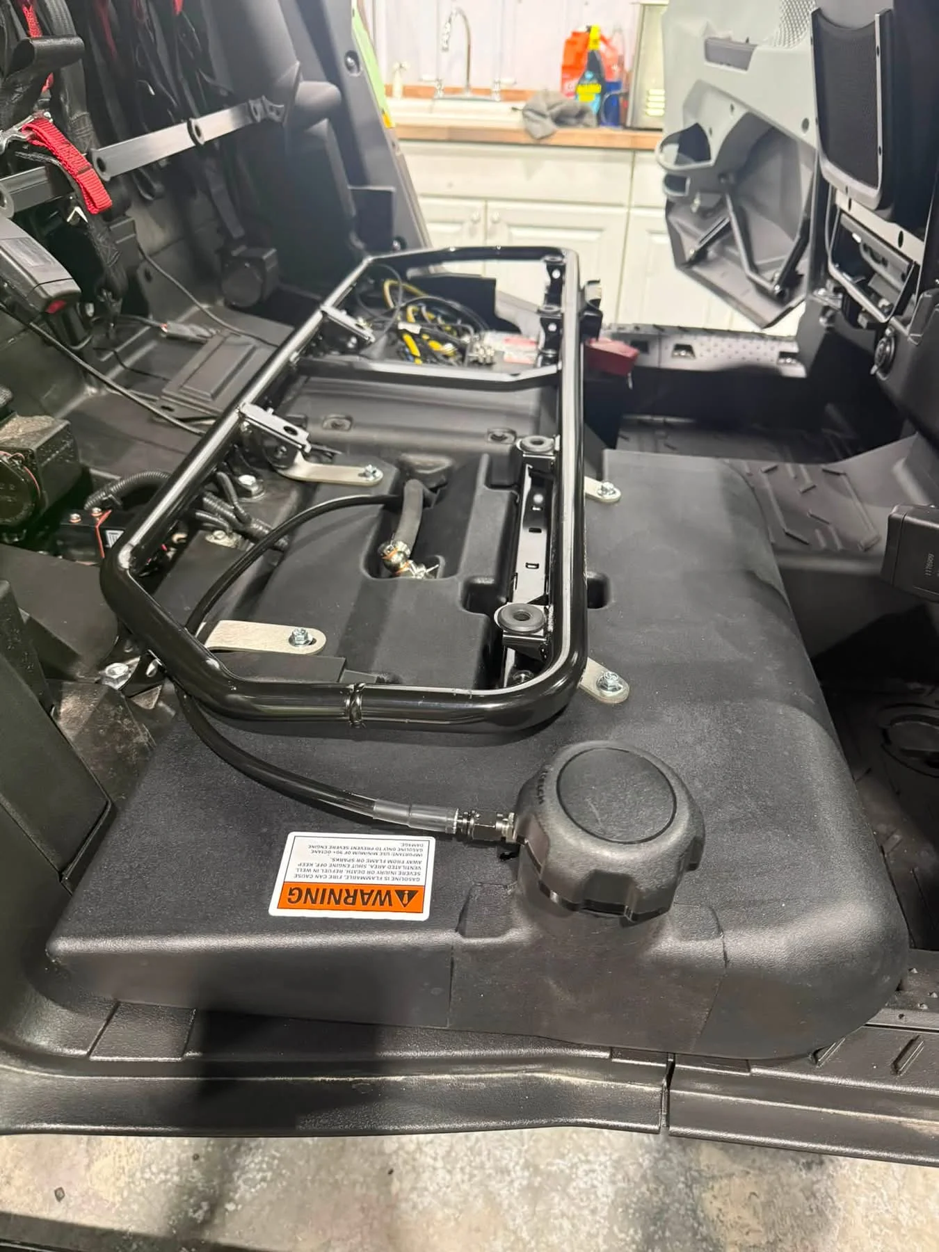

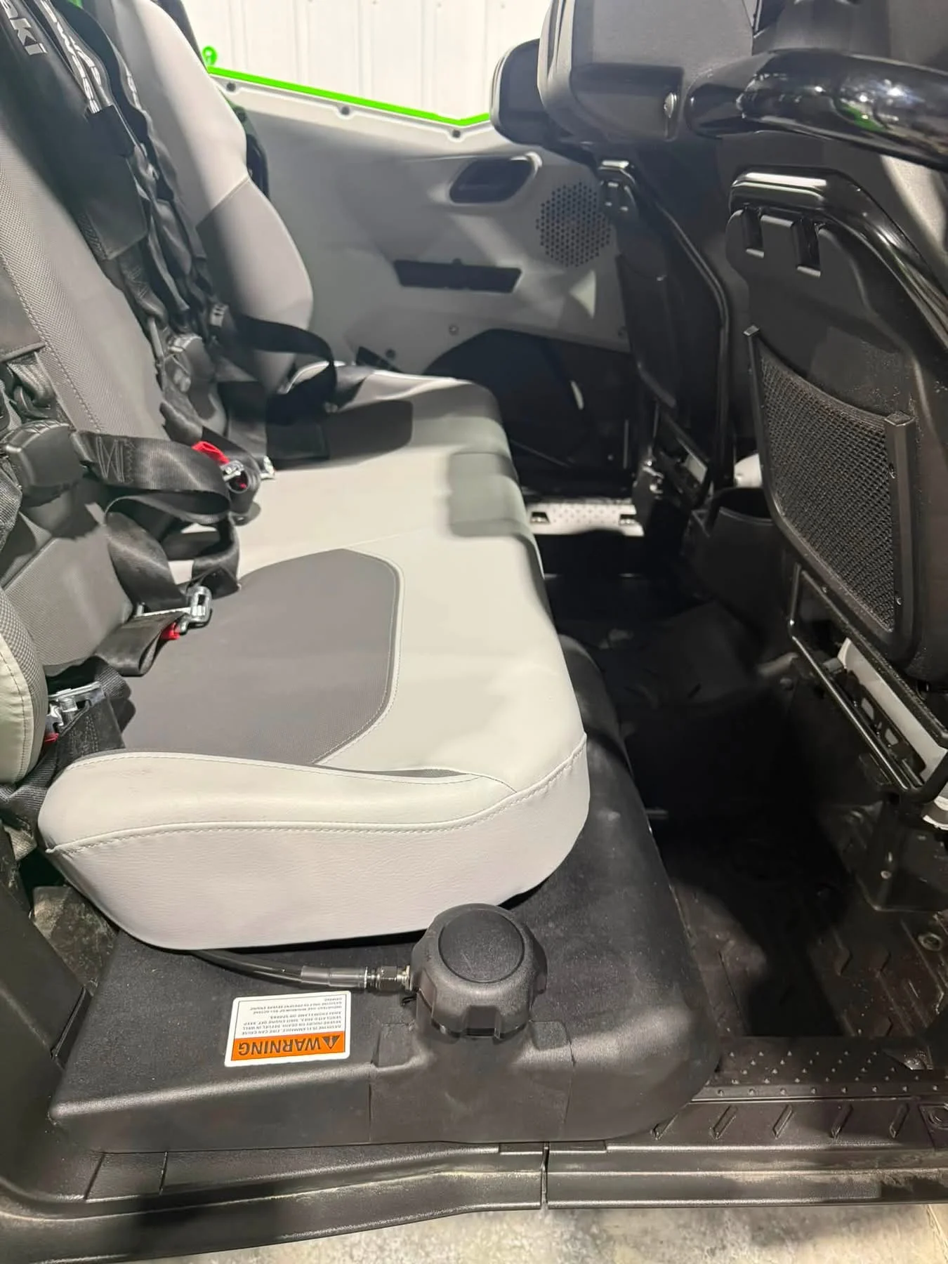

The RPM auxiliary fuel tank is installed, not too bad of an install but time consuming.
6.8 extra gallons of fuel onboard now without needing to mess with the rotopax

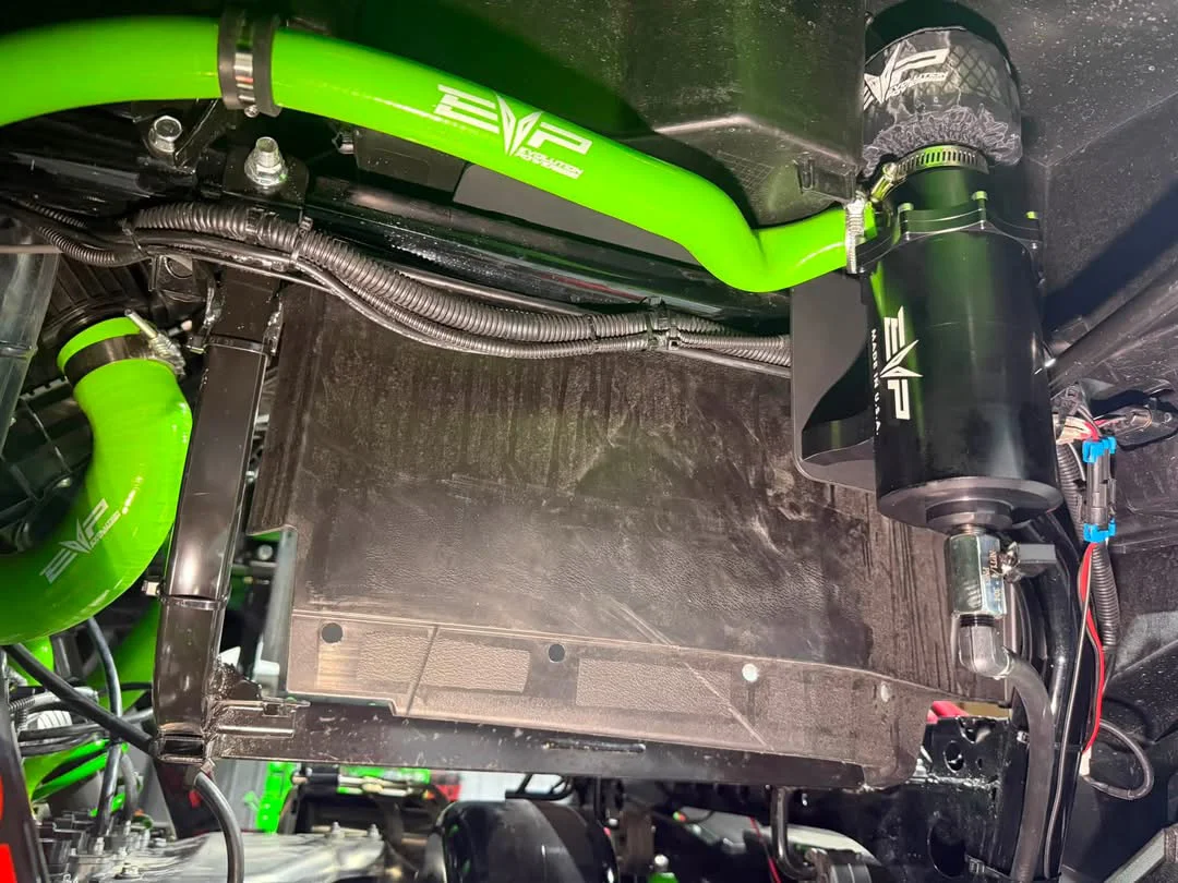

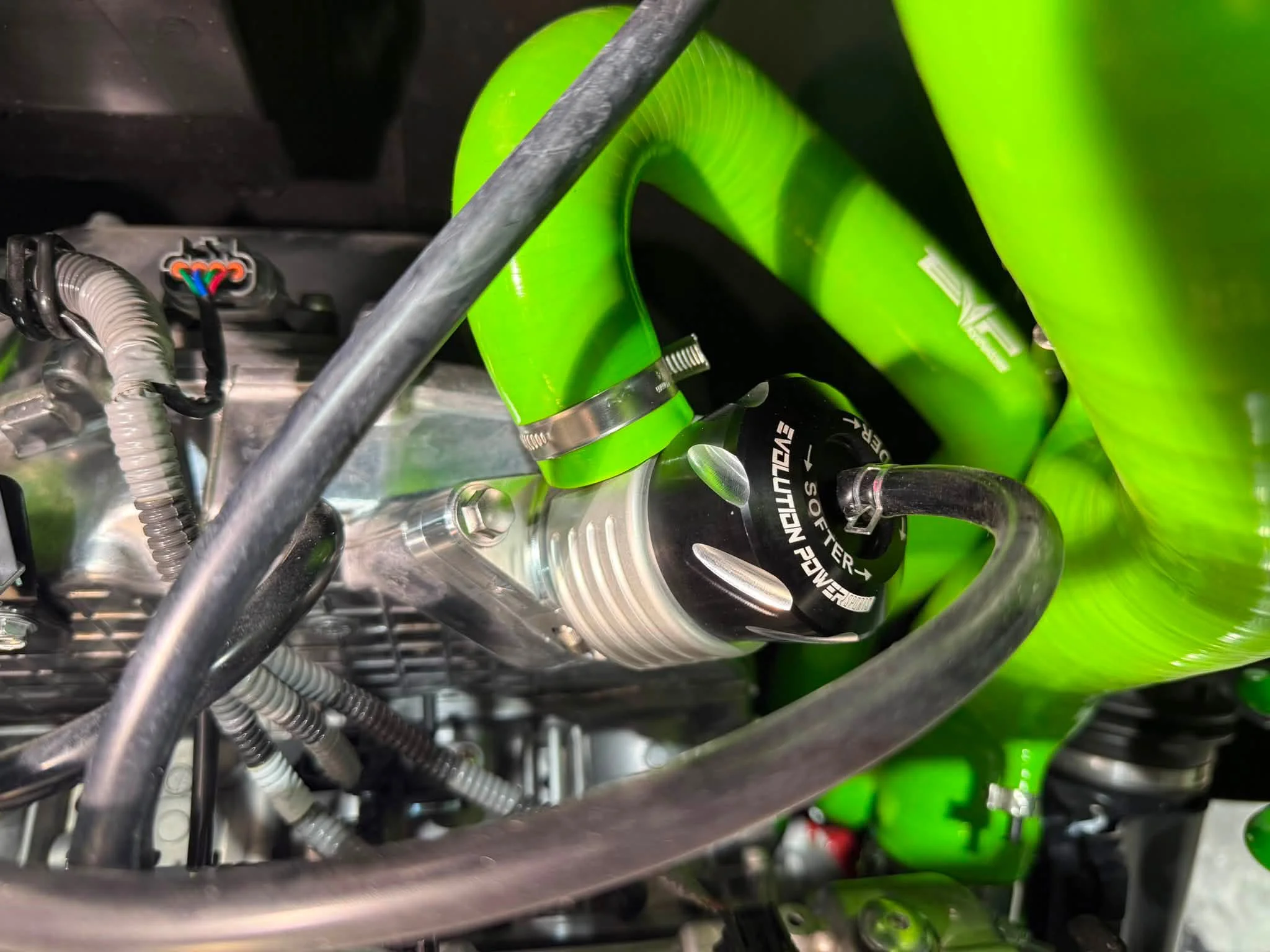

July 12,2026

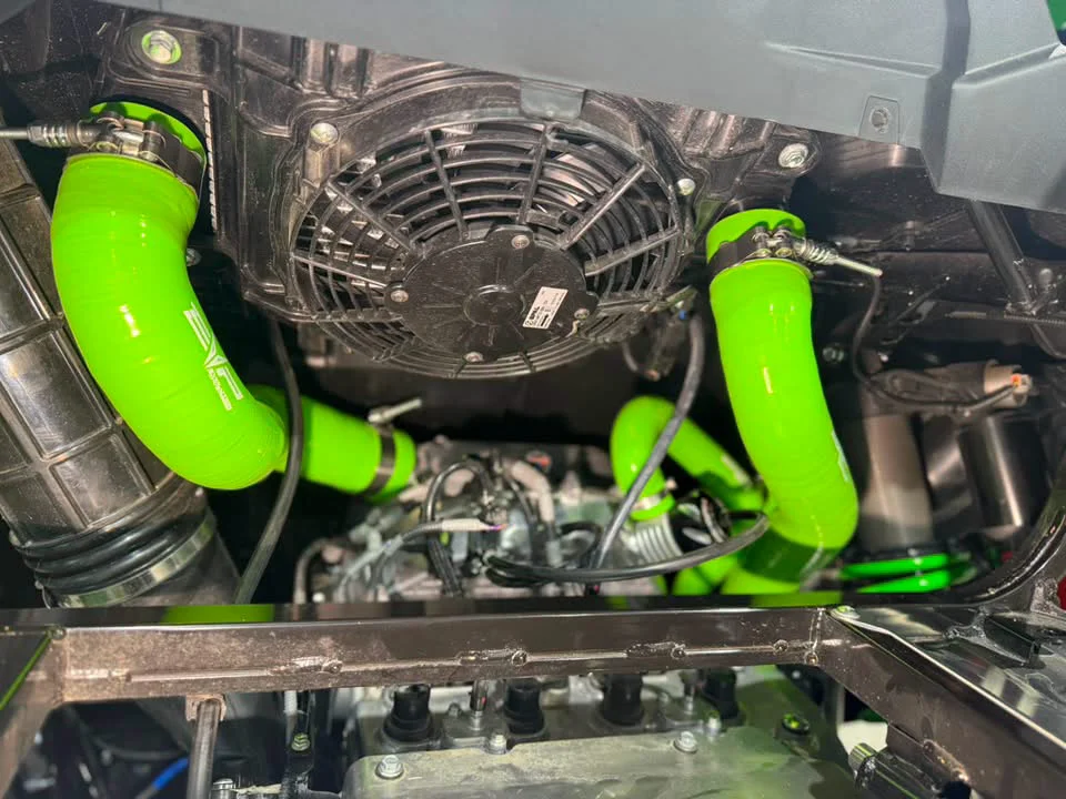

Evolution Powersports. Charge Tubes, Boost Recirculation Valve (BRV) and Boost Hose installed, still need to install the EVP Catch Can then I can button it back up and install the Elektric Baja Box but that will have to be in the evenings this week as we have KRX clutches to work on all week..

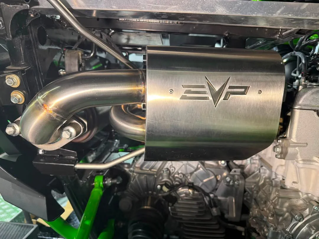

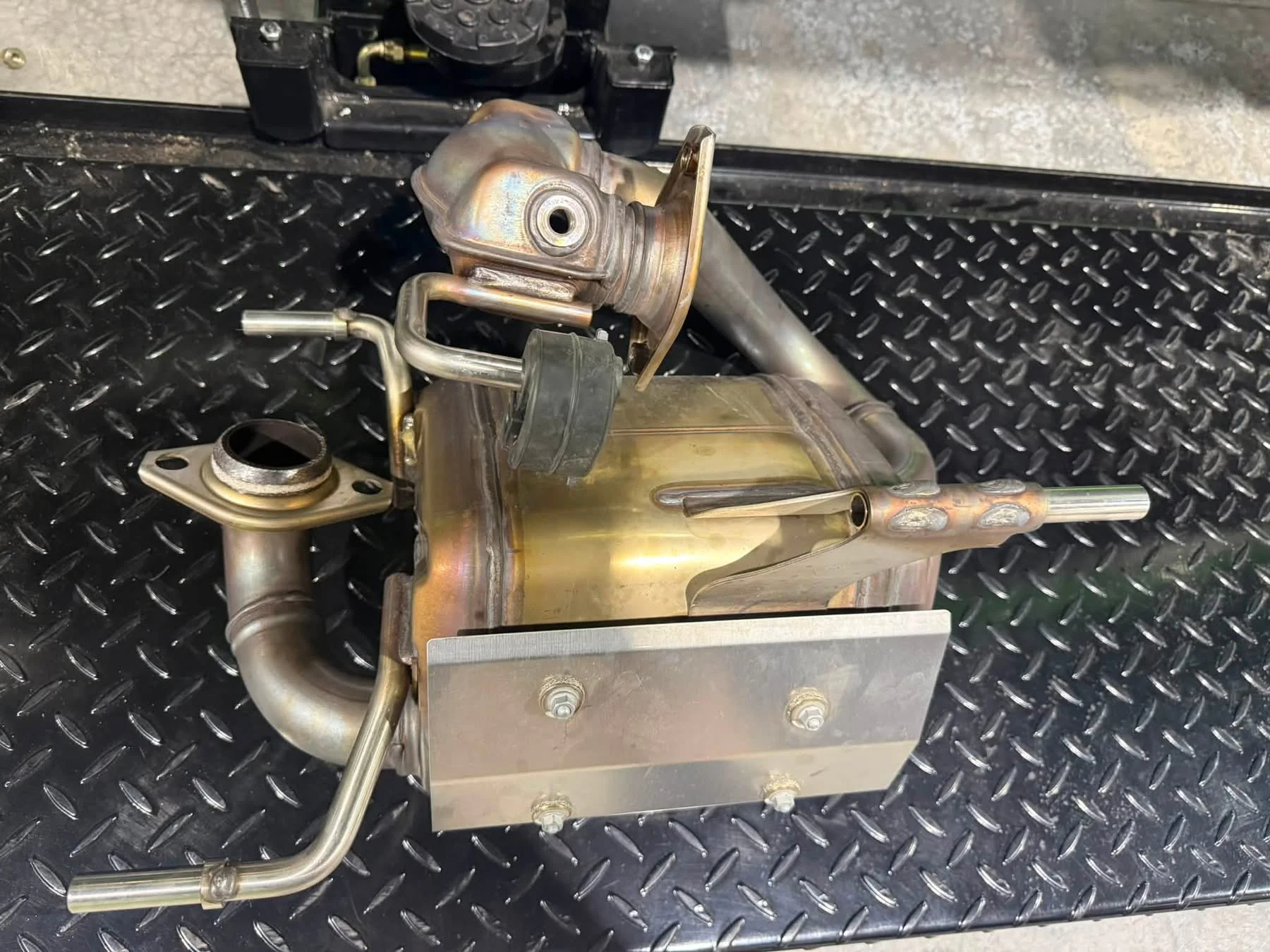

The Evolution Powersports catch can and CAT delete / bypass pipe, I really wish the EVP muffler would work with this but we’ll see, it definitely has a deeper tone and a little bit louder but we’ll see how it sounds on the trail..
I had already installed the EVP Boost Recirculation Valve, Supercharger Charge Tubes, and Boost Recirculation Hose.
