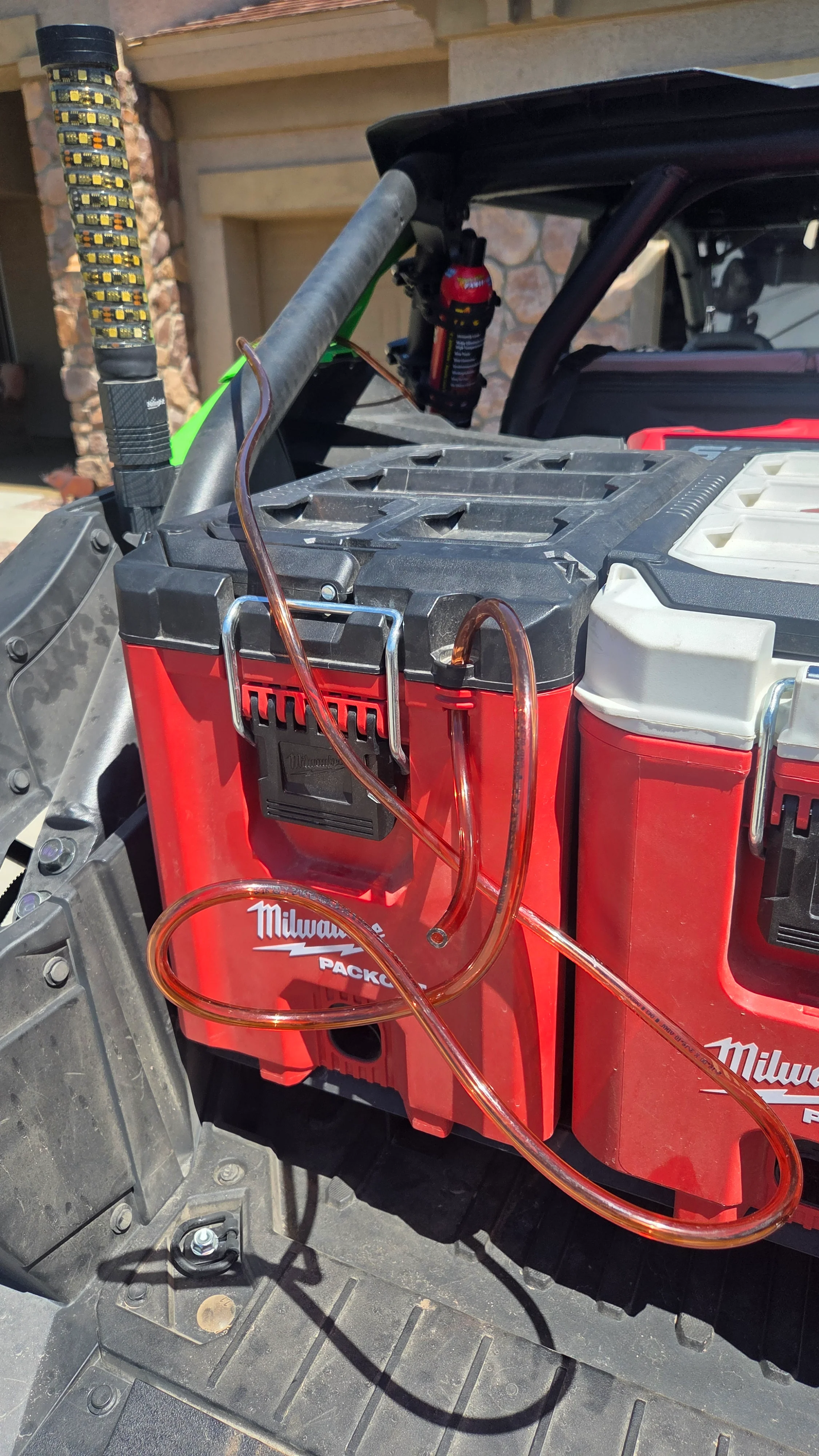

I had some 1/4 inch clear poky line in my garage, so I extended the vent line and ran it up to the cage, behind the CVT air inlet, and back down the cage and just let it hang off my tool box at the very back of the sxs. For the most part, this resolved the fuel smell in my cabin. But need to test for some longer runs to be sure. Also ambient temps were only low 70s, so not the same as previous rums.

I had some 1/4 inch clear poky line in my garage, so I extended the vent line and ran it up to the cage, behind the CVT air inlet, anf back down the cage and just let it hang off my tool box at the very back of the sxs. For the most part, this resolved the fuel smell in my cabin. But need to fo some longer runs to be sure. Also ambient temps were only low 70s, so nonthe same as previous rums.

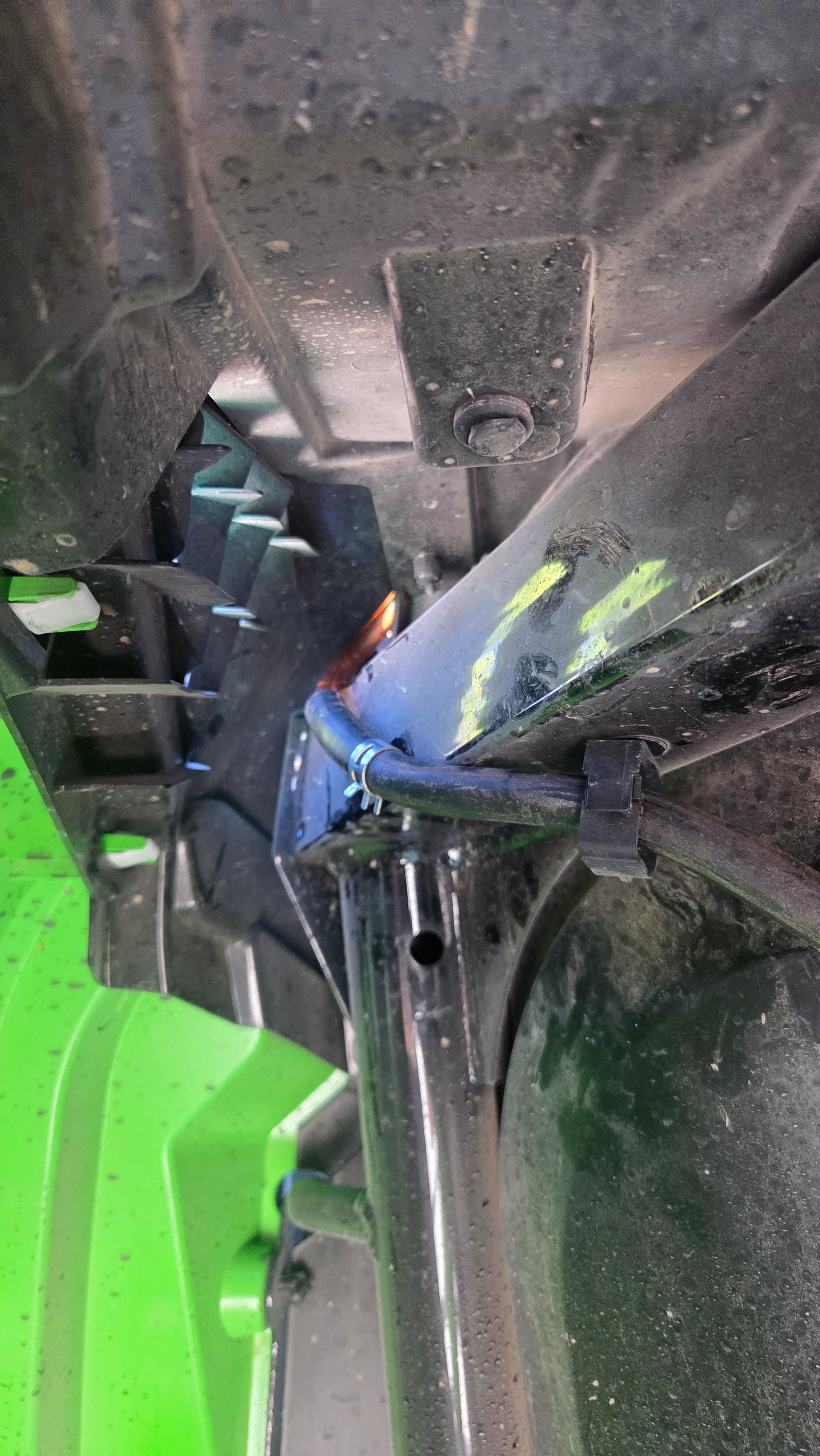

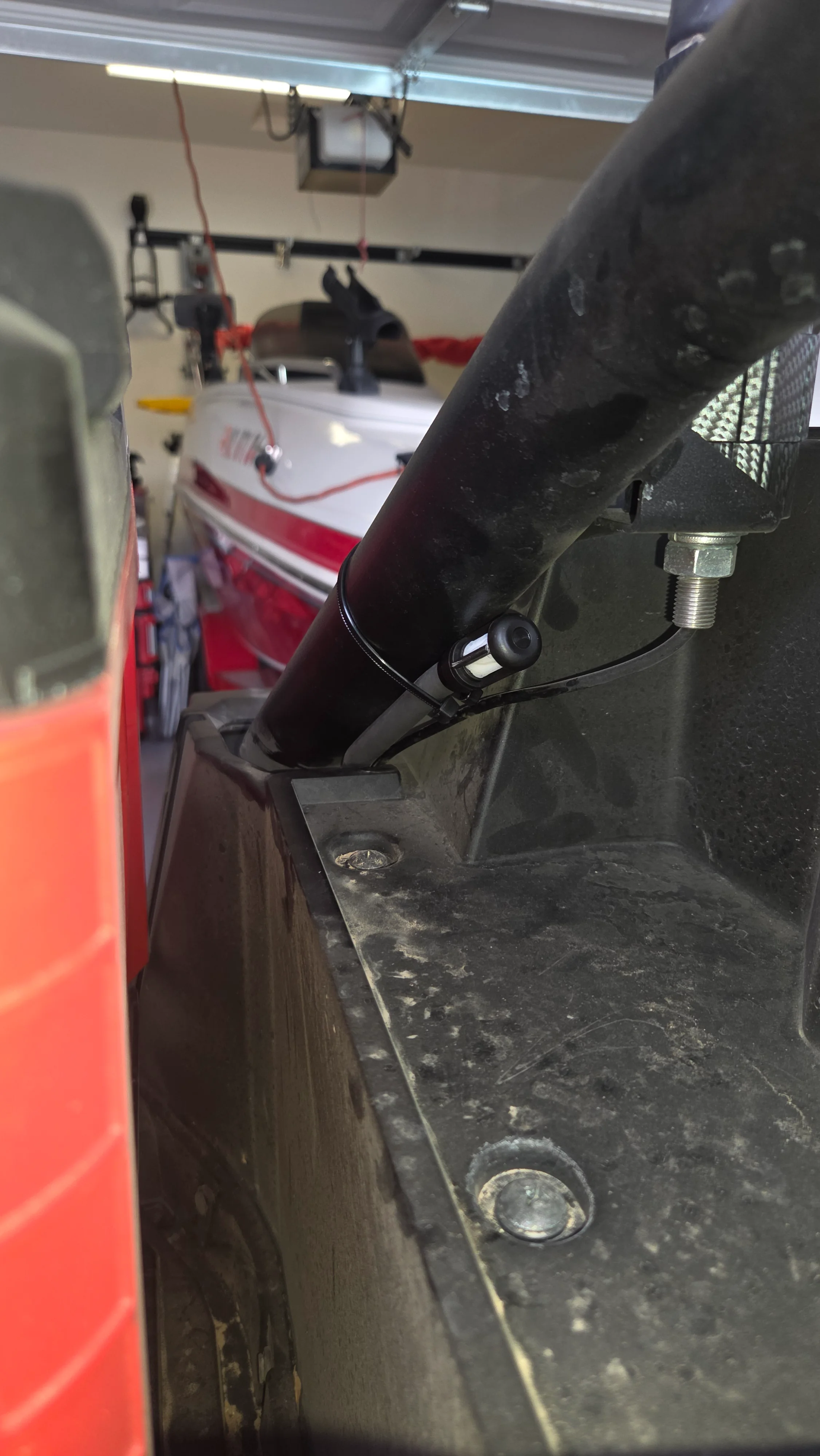

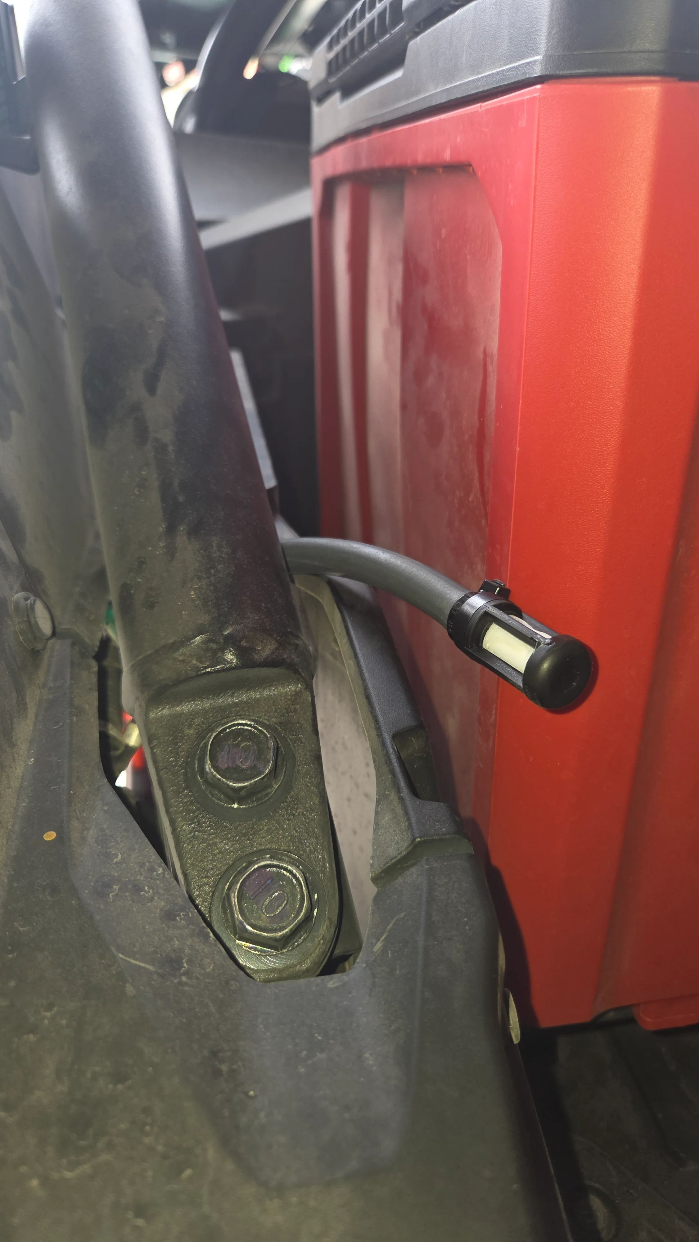

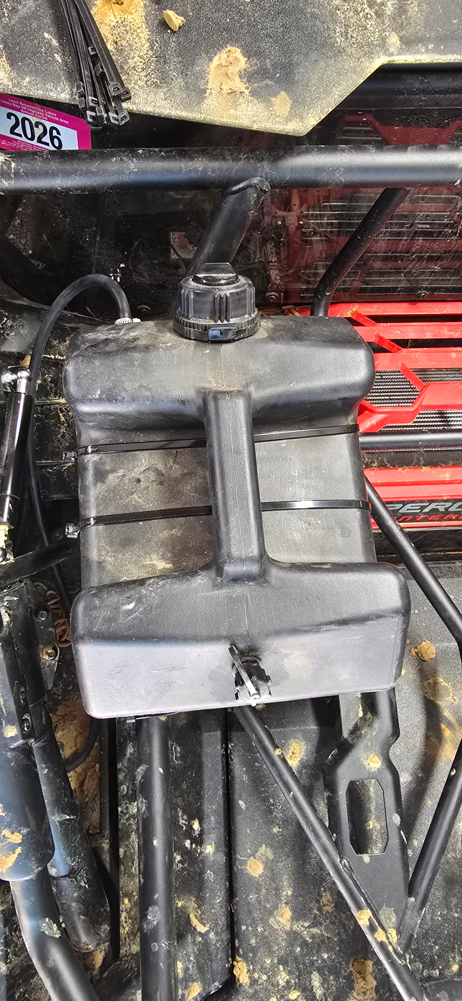

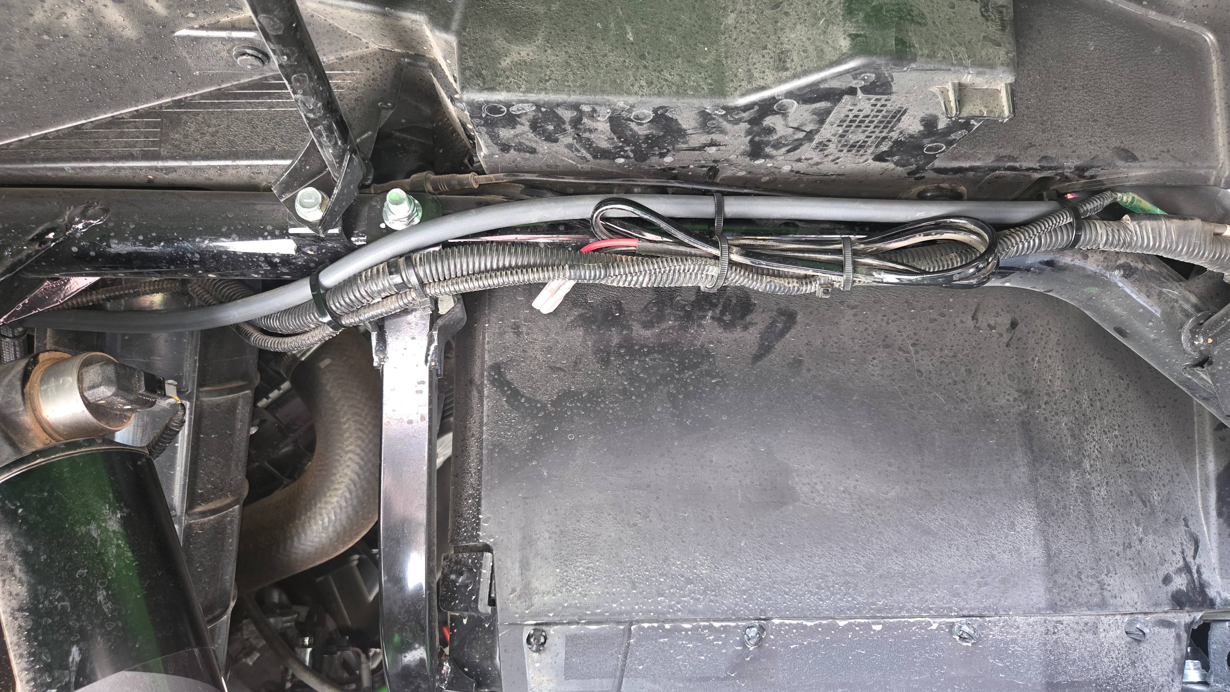

After some more testing, I've decided that running a new fuel line from the outlet end of the new rollover valve up to the frame and out by the rearmost mount for the cage (need about 3.5 feet of line). Then I put a small breather filter on the end of the fuel line and tucked it out of the way under the cage to give it a little protection from heavy mud and water.
This fix seems to work about 95% and it should be relatively safe from fuel leakage. I am still getting some fumes that occur within the first 300-1500 feet of travel and then they seem to disappear. Never get any fumes at start up or idle, maybe just a hint of fumes occasionally when running harder.
My theory is that the vapors coming from the tank are heavy after some run time. When you shut off the car, they continue to flow until the fuel cools down. The vapors condense and are then trapped in the line. When the fuel warms again, pressure builds quickly, and all that residual in the lines pushes out heavily. Then the system normalizes and you don't get many fumes when running.
Also, l left my OEM line in the cage and behind that cover. That way if Kawasaki ends up with some better fix, I can covert it back quickly with just a new 1/4 inch barb.

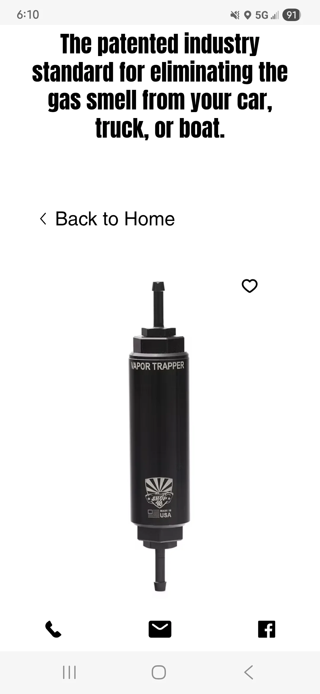

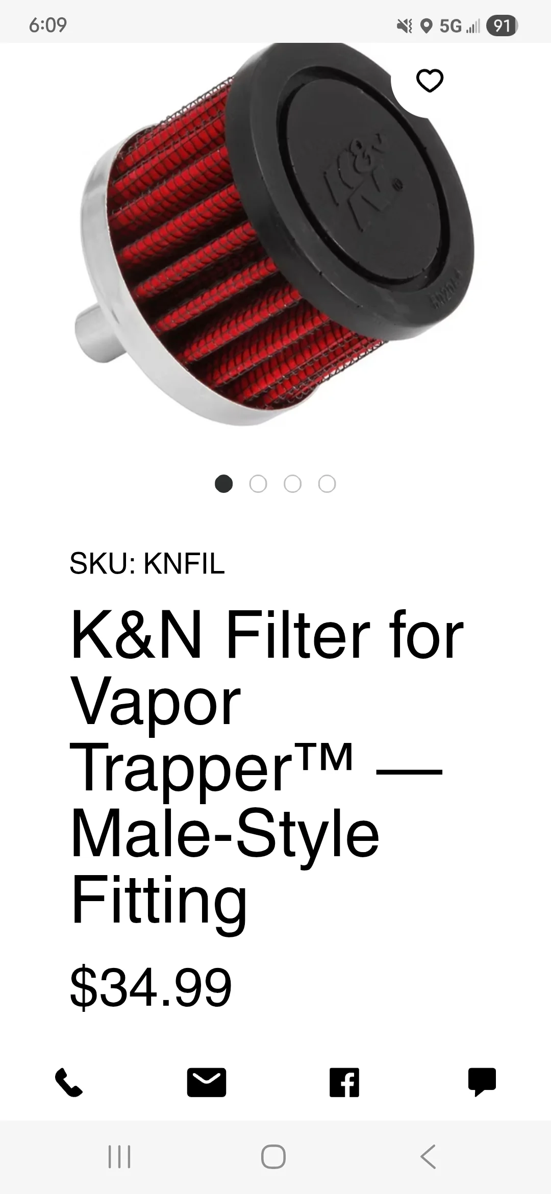

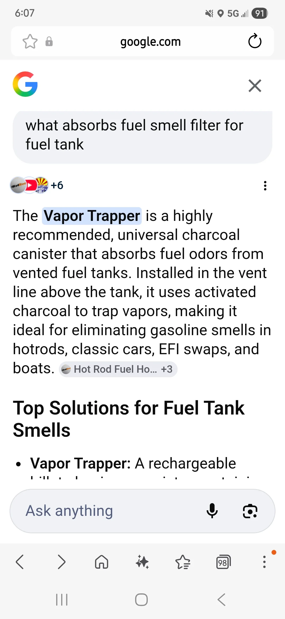

I'm going to try this , works on vehicles!
You can get those Chinesium K&N filters on Amazon for $7.
Thanks for heads-up, I haven't ordered anything yet, just trying to figure out which setup I'm going to try. I did find a cheaper vapor canister on Amazon earlier today at work.

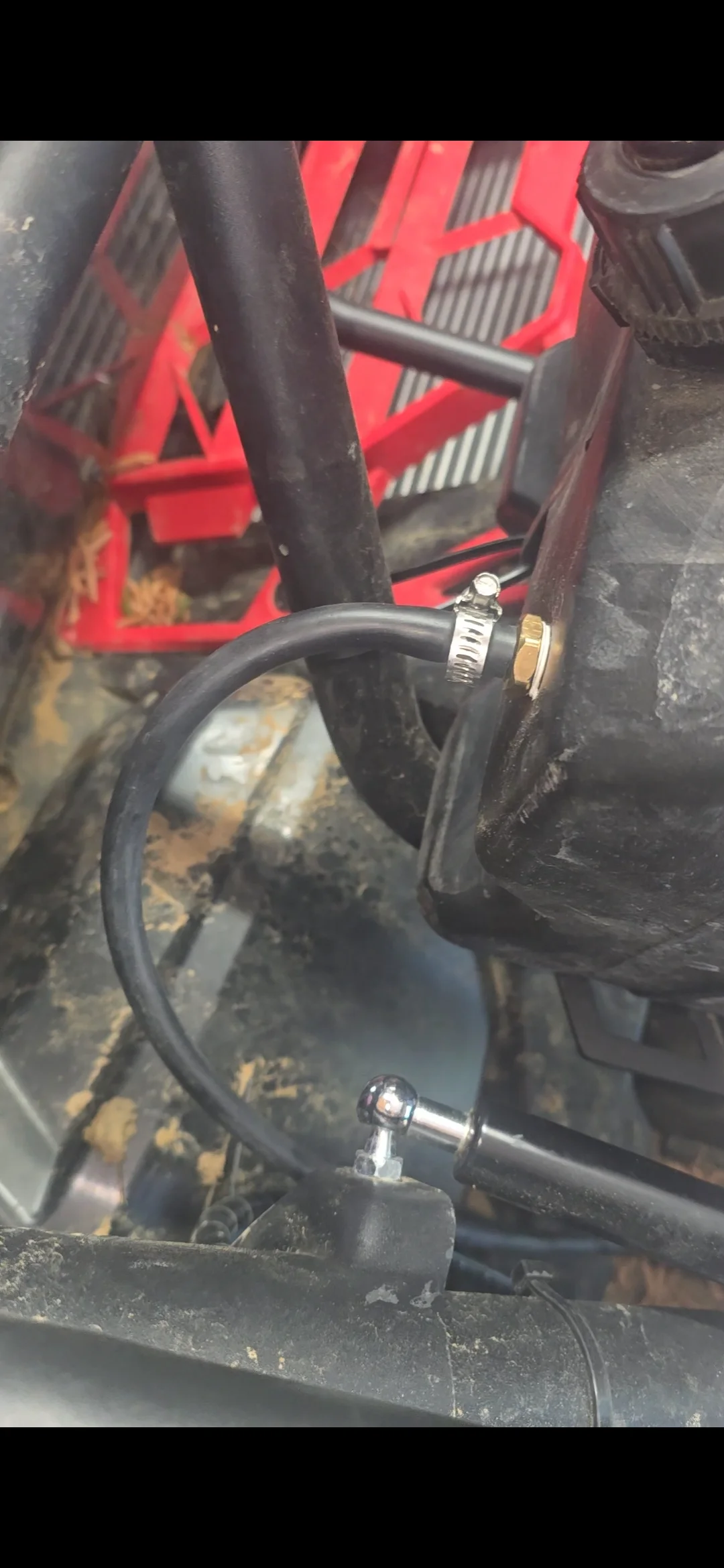

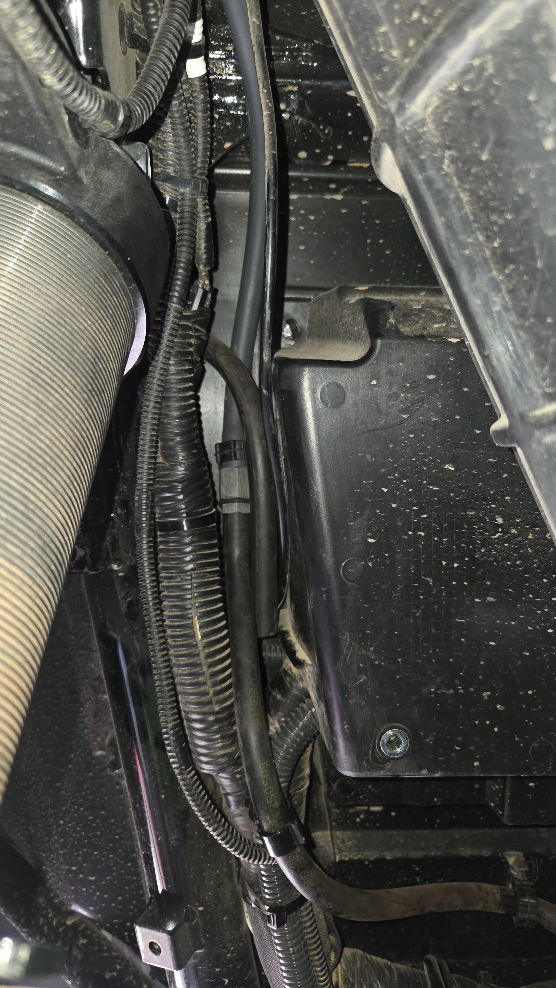

I removed factory pressure valve and installed the rollover valve, went on a couple big rides including windrock. Ran vent line to the rear. I took a pretty sturdy fuel tank and added a connector to it so I can run vent line to it . I keep the vent off the fuel tank barely cracked open. It's not the permanent fix I want , but it did great !! No fuel issues or pressure problems.
