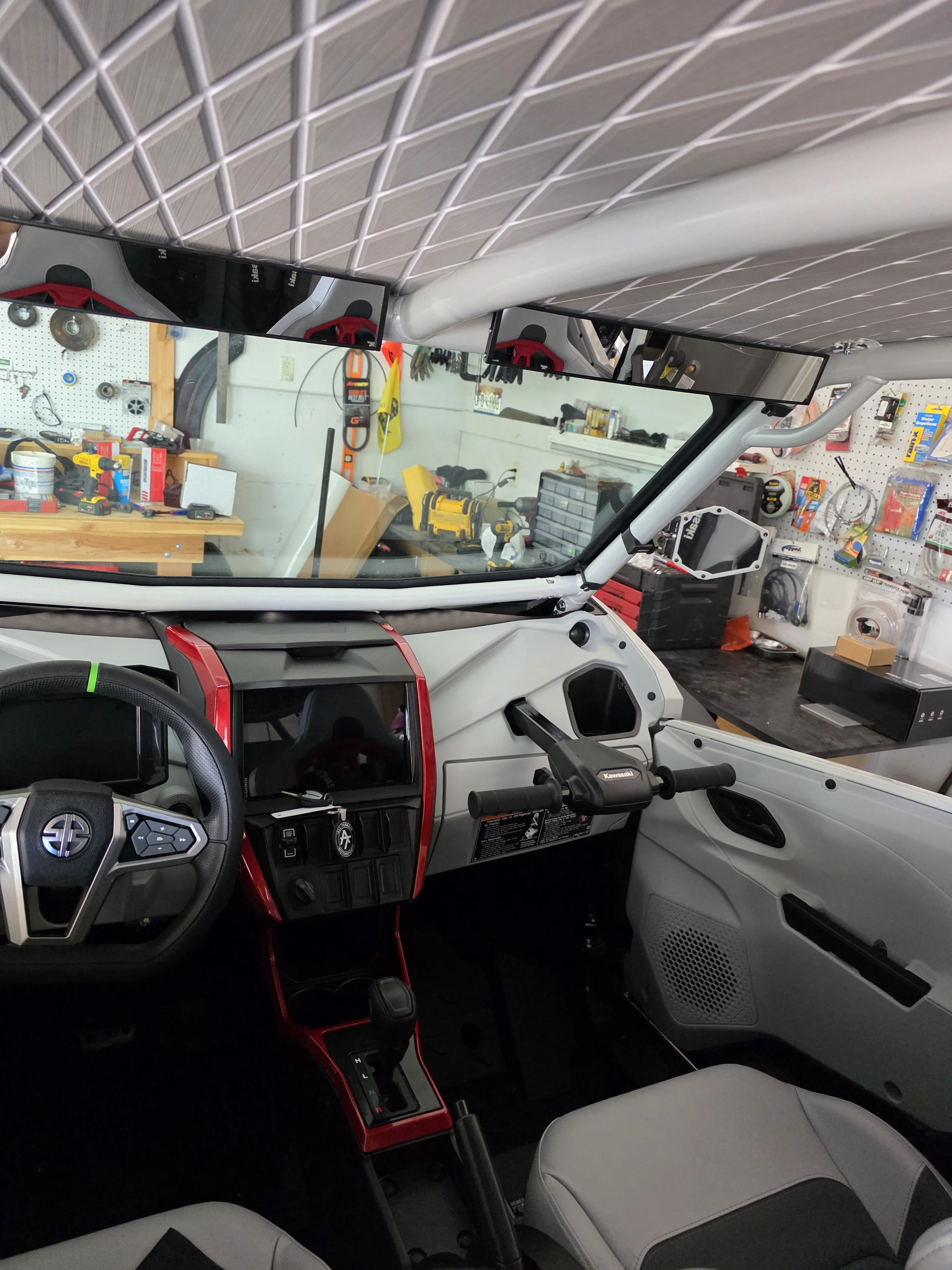

Has anyone ran into this problem? The Garmin keeps showing a status can bus error. It tells me to disconnect and reconnect but that does nothing.

Good news! The resolution after doing all the suggestions was to hold down the Garmin power button for 20sec when turning it back on. This forces a hard reset and fixed the issue. Thank you guys for helping.
