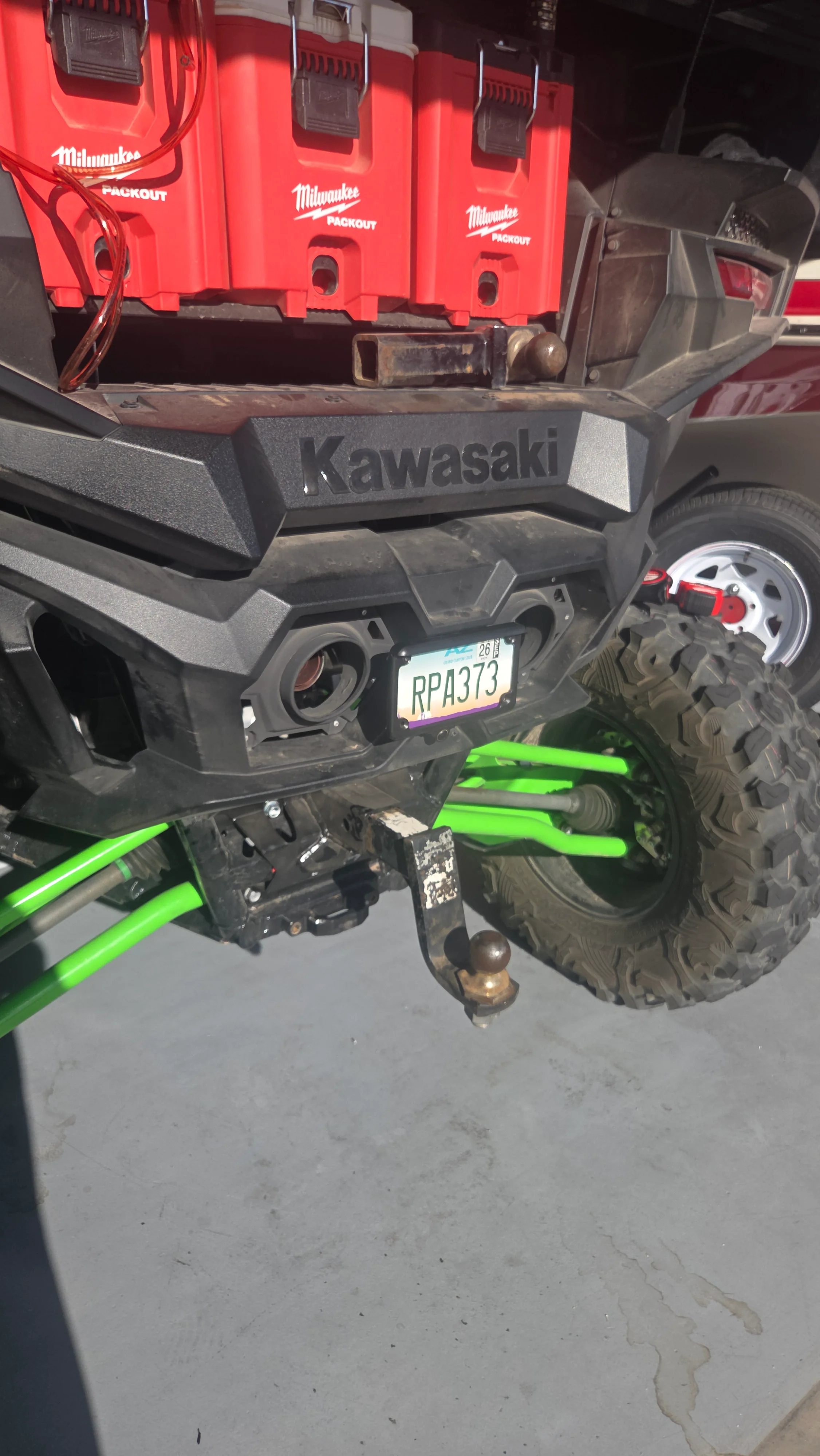

I put this HMF reciever on my H2. It is constructed really well and has a nice finish. A bit of a PIA toninstall as you have to remove all four linkage bolts at the same time. If you're doing it by yourself, it's hard to get everything back in place, as the tire/wheel wants to twist outwards. It would be better to have someone to push on the tire/wheel to get the alignment you need to get the bolts back in.
Also had to relocate my license plate higher up to clear the hitch when installed.
Anyway, I use my reciever for a hitch to move my utility trail around, for a cargo rack to haul firewood when camping, and to add a D-ring for tie down point and towing.
