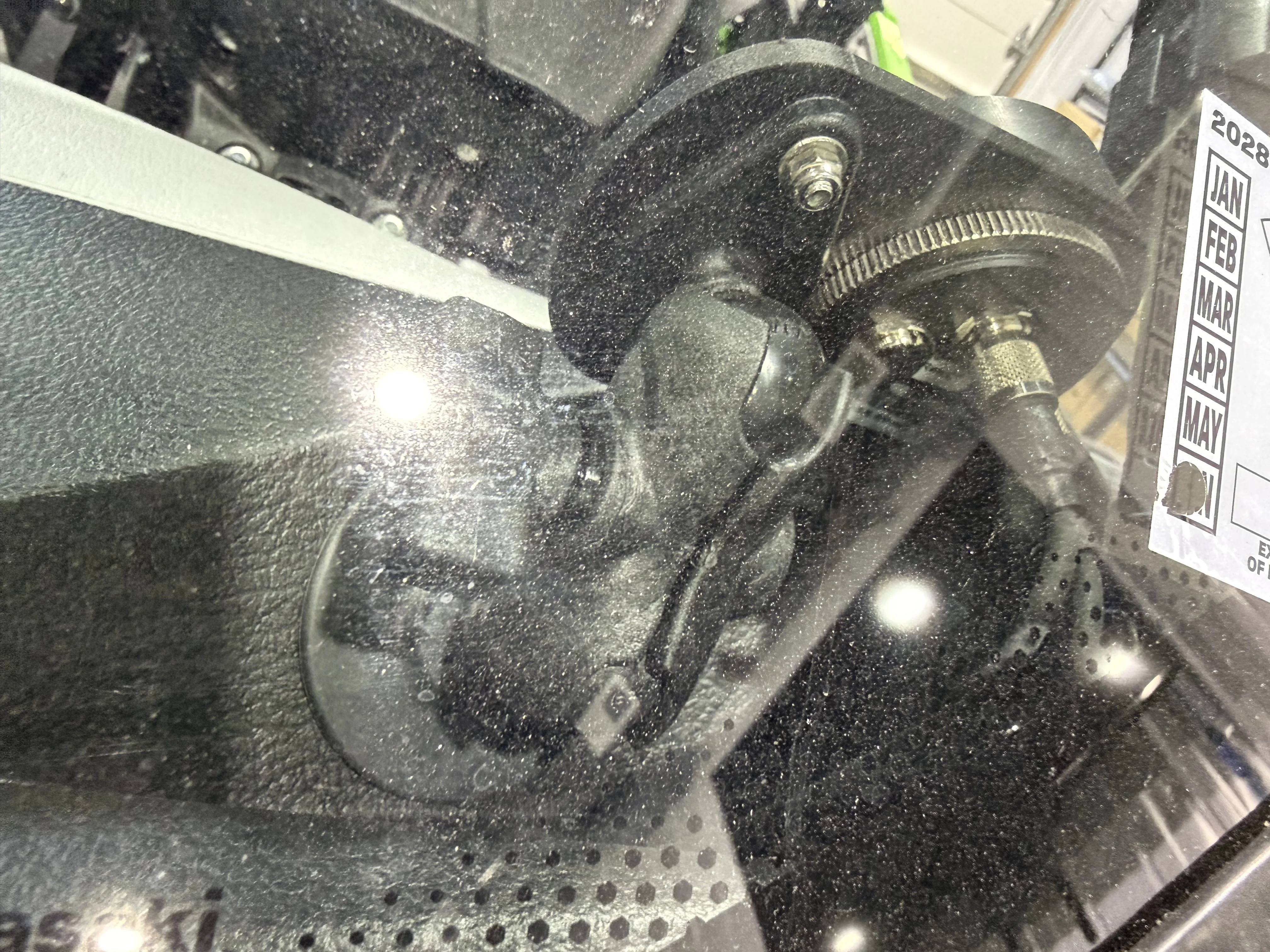

Does anyone have a recommendation (preferably with pictures) of how to mount the Razorback belt temp gage? I called Razorback and they don’t have one for the H3 yet.
Not a Razorback but an AIM infrared belt temp gauge, I used an adhesive Ram mount with a short arm and an adapter plate with 1" RAM ball to mount mine.

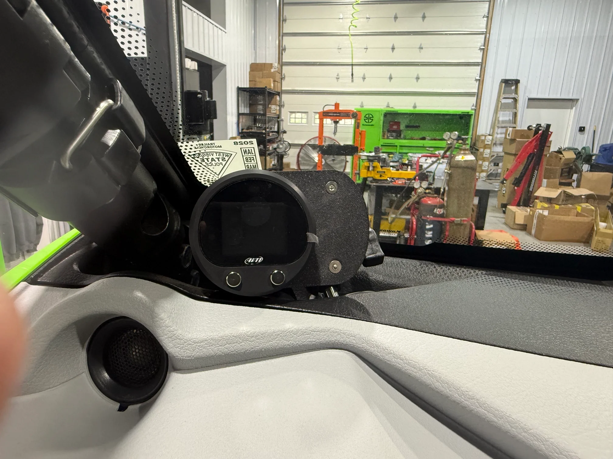

I did something similar to the above. Mounted to the A pillar using a GoPro clamp mount from Axia Alloys: https://axiaalloys.com/wp-content/uploads/2017/03/modpro-1-2.jpg
And a swivel mount from AMZ: https://www.amazon.com/dp/B0B58YL6Y8?ref=ppx_yo2ov_dt_b_fed_asin_title&th=1
Along with a gauge pod from BLRTuning: https://www.blrtuning.co/products/u...r?_pos=1&_psq=gauge+pod&_psid=2d0e34fbf&_ss=e. (Pod only - didn’t use the base)

Is there a reason to pick one gauge over the other?
I had read of a few issues with the Razorback plus there is a multi area sensor available for the AIM.
The AIM also has a quick connection at the belt box and since you have to mount it in the outside cover this was a must, I have read that the Razorback does not have that option but I can’t confirm.

I’ve used razorbacks on previous cars and they work great. I have a lot of confidence in the accuracy.
