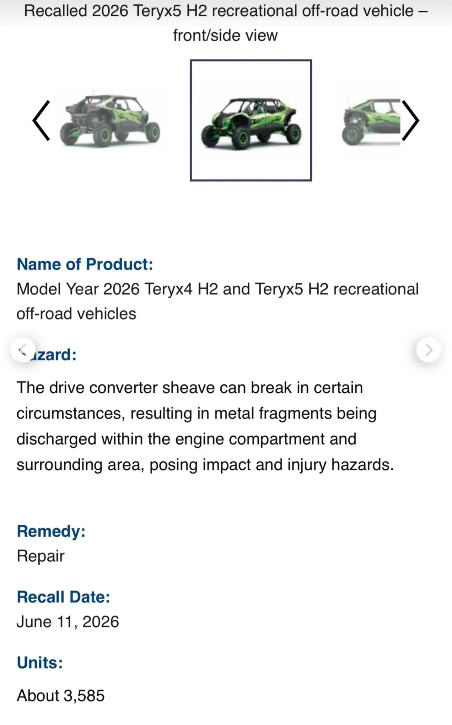

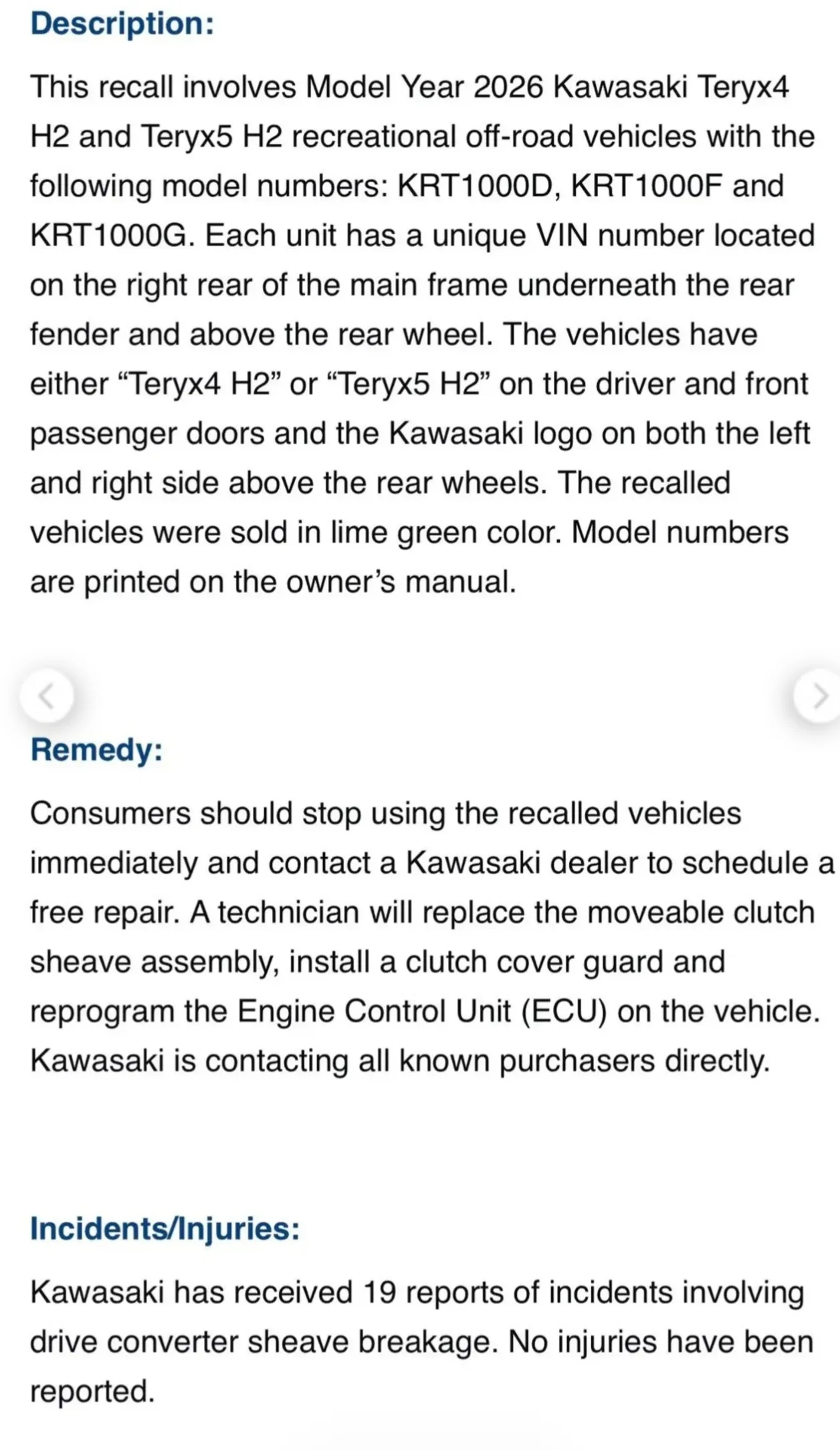

Looks like Kawasaki made the clutch recall official. Like i expected, it doesn't seem to do much in the way of improving performance, perhaps not even reliability since they are including a "guard". With the ECU reflash, may even get reduced performance......LMFAO......we took it in the shorts!

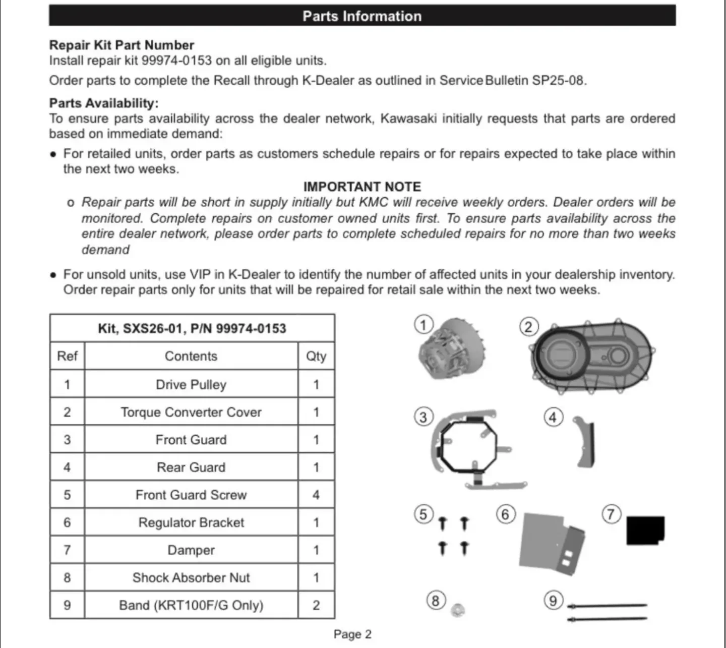

Here's the parts list for the repair. Looks kinda janky.....not sure what that flimsy guard would do in the event of a failure. It should have been a beefed up unit mounted off the frame outside the CVT cover.

Think I will stick with my Tapp setup, but wondering if the guards inside the cover will help with not destroying the cover every time a belt breaks. Also wondering if it will interfere with the tapp clutches
In my experience, belts destroy the CVT cover near the secondary or rear of CVT cover. This just looks like a feel good kind of hack fix cause they don't trust the primary to keep from coming uncunted again!
It looks like a whole replacement cover and there is a guard all the way back if im looking at picture correctly?

Getting a new primary and cover to fit over the new primary design. How has Kawasaki failed? they fixed the issue with a new primary. They could have modded the original primary as a bandaid fix. Far as the flash goes Kawasaki isn’t going to detune it. You can’t advertise 250hp then pull HP away. It’s a no 2 pedal driving just like Polaris does. To be honest I could care less because it’s getting a tune anyways.

ECU reflash is to not allow for two foot driving. Don't think it is going to kill performance.
The guard on the cover is needed as is the the guard for the voltage regulator. The new primary clutch will fix the flexing issue and possibility of exploding. If the primary works correctly then it may solve the heat problem with the secondary. This remains to be seen.

The guard is need so if a belt does break it does not destroy the clutch cover. I ran a shield on my X3s for this reason.
