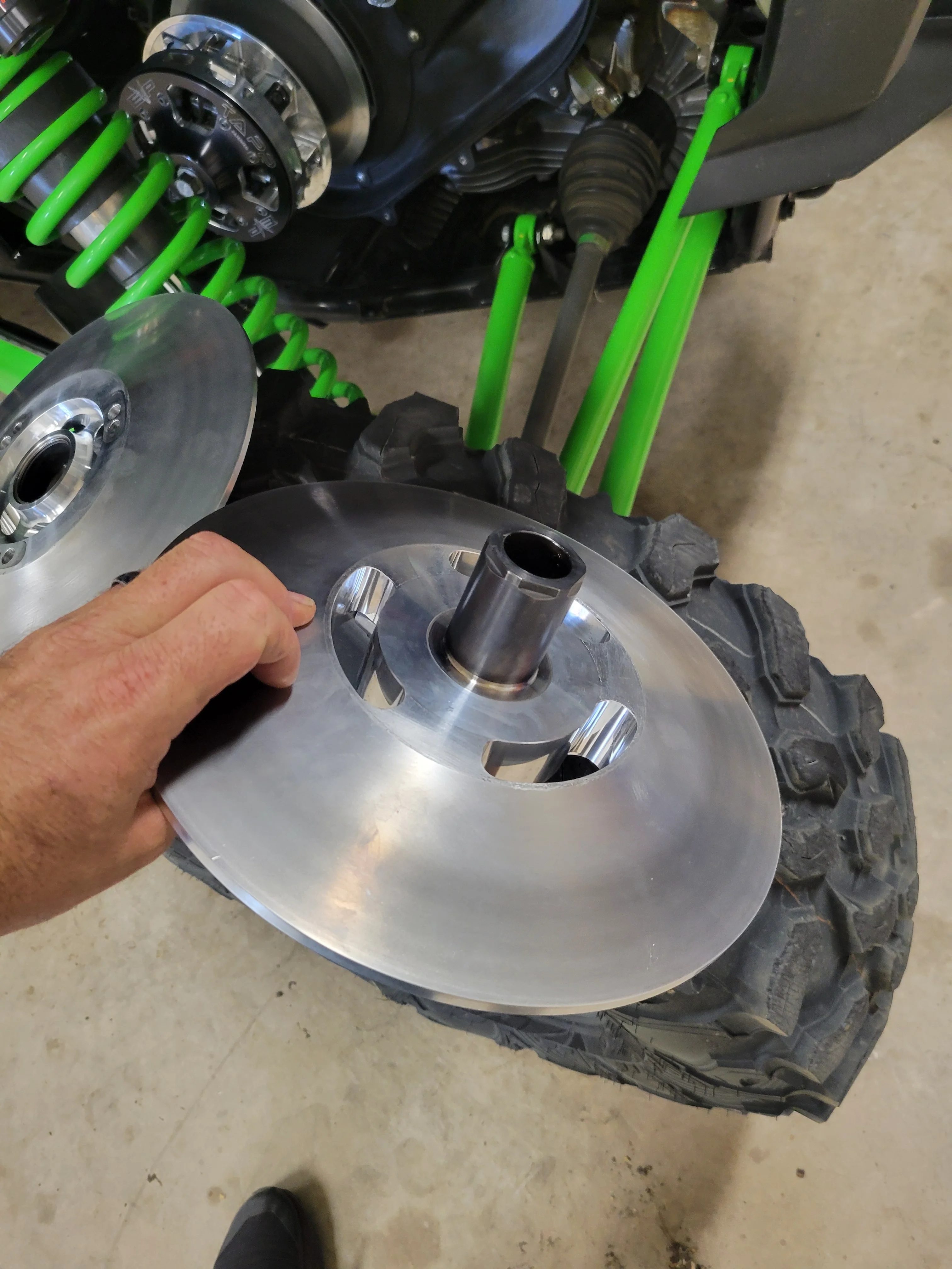

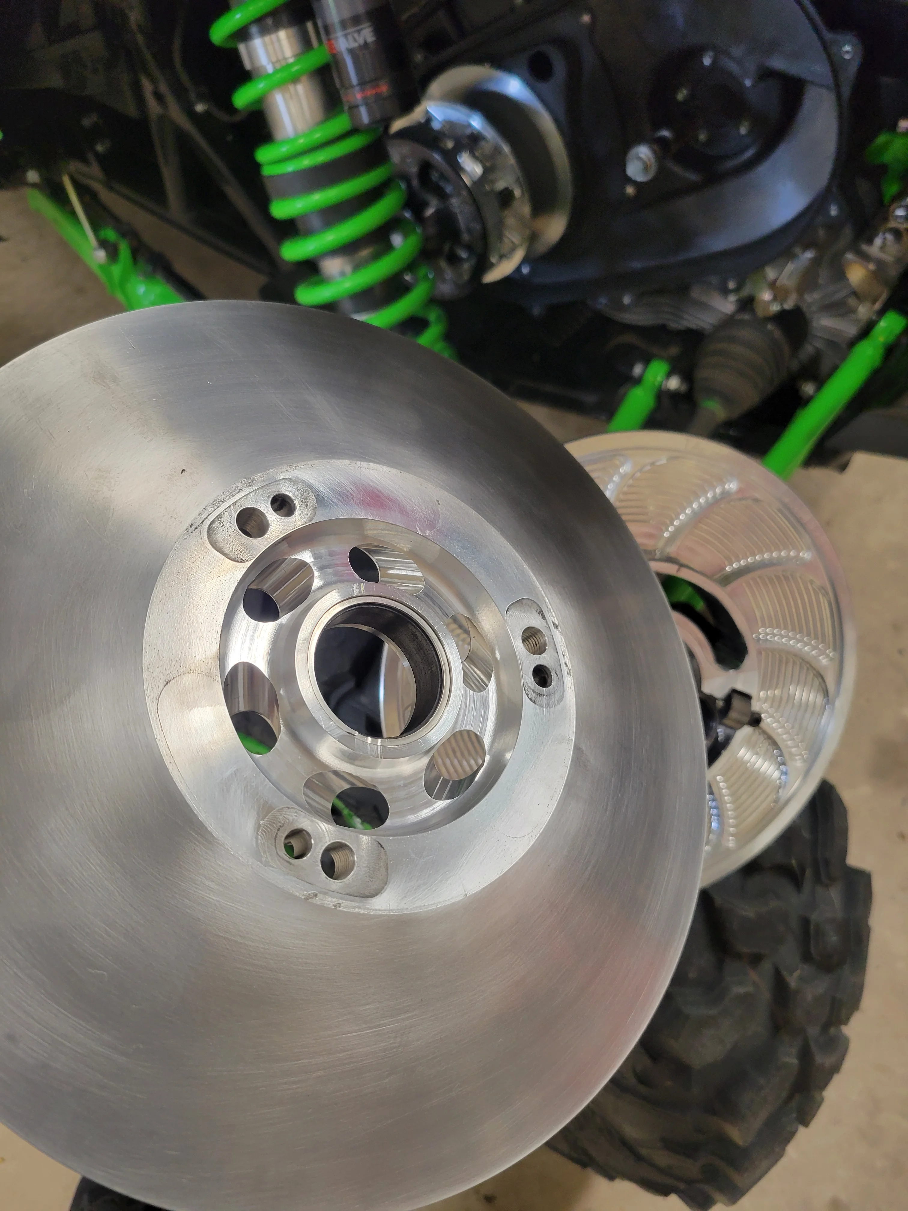

Not very exciting, but I took .30 thousandths off the inner base of my Tapp secondary sheaves today. This allows the clutch to close together more. Now the longer gboost belts will have correct deflection and increase gear reduction on take off.

That sounds pretty exciting to me! Let us know how that works out. Very interested. Good work

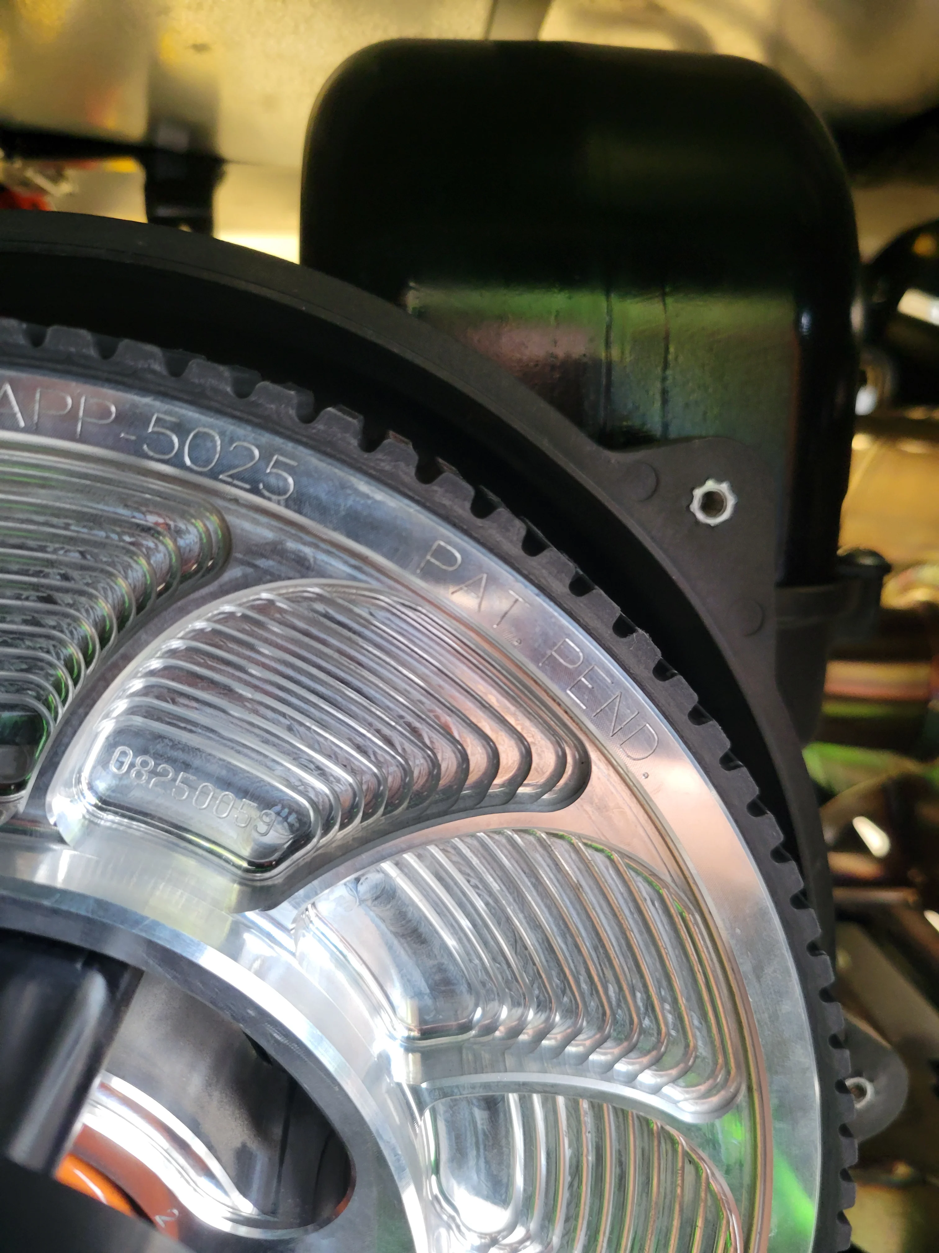

It works great. The belt has very little deflection. The belt rides higher now and the sheaves are not touching when its closed with a evo badA belt. The Evo belt is a Worlds Best belt. WWB0047 part number. This helps the jerky slow start i was getting with a loose fitted belt. The gear reduction is not a huge change, but it helps.

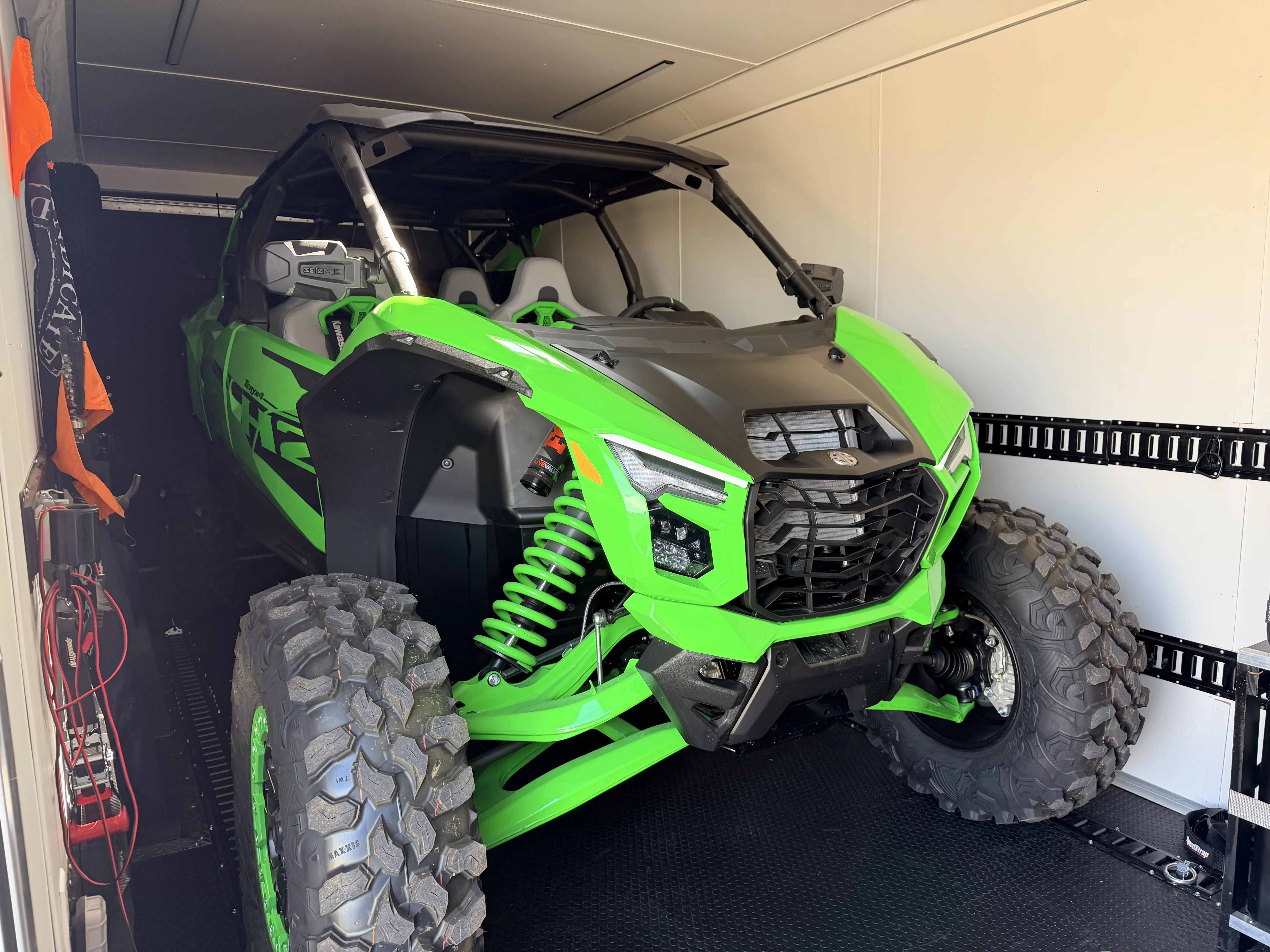

Picked mine up today. Zero miles, KWI secondary with KWI overdrive cap and weights on new Kawi primary, stock and Pro R belts and a street legal kit. Wish it wasn’t over a hundred degrees today in Utah or I would have drove straight to the dunes.

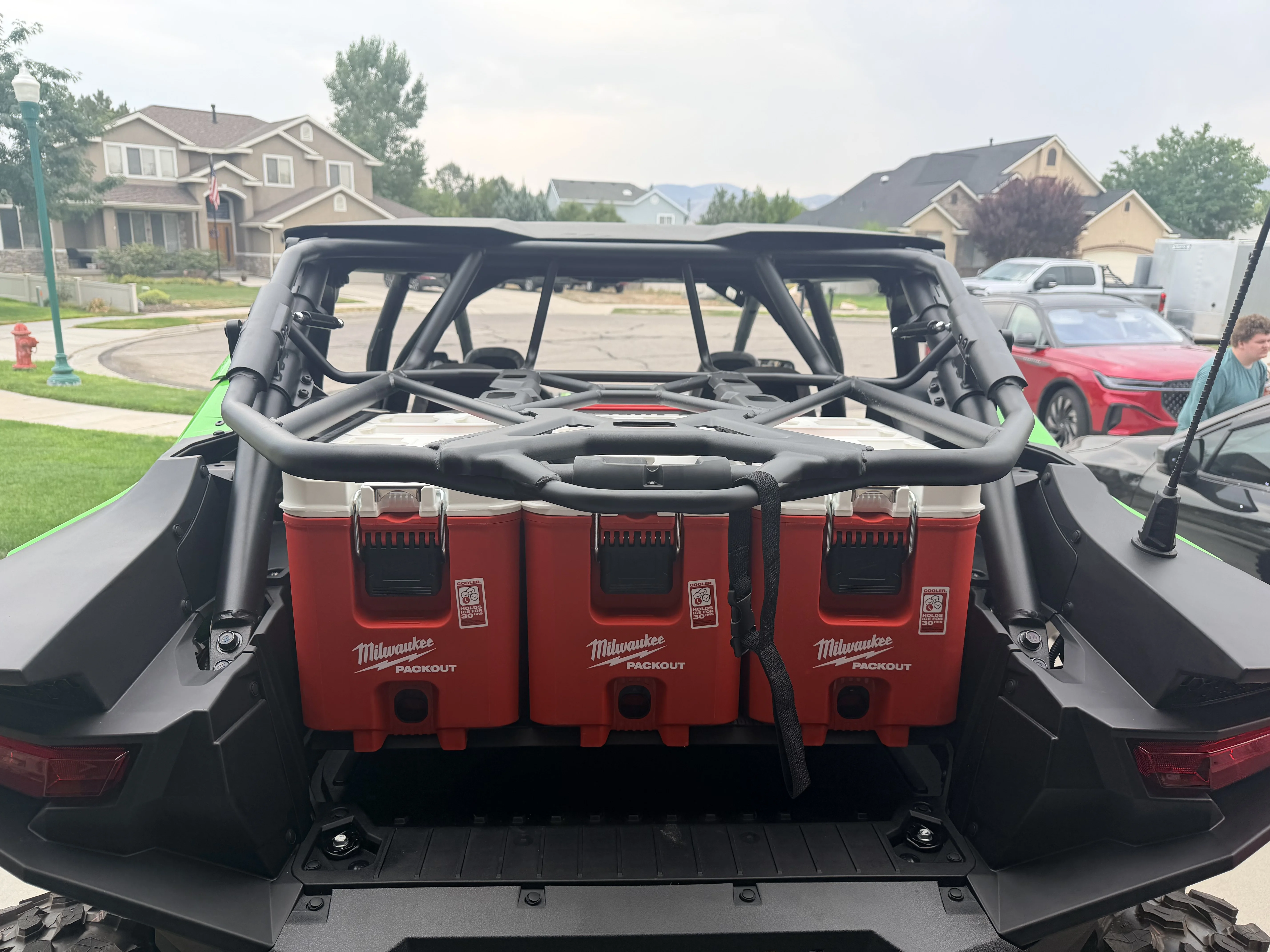

Added the Pro Steel packout plate and tire rack. Going to add a box or more packouts to the tire rack. I mentioned in another tread, not much room for gear in this car.

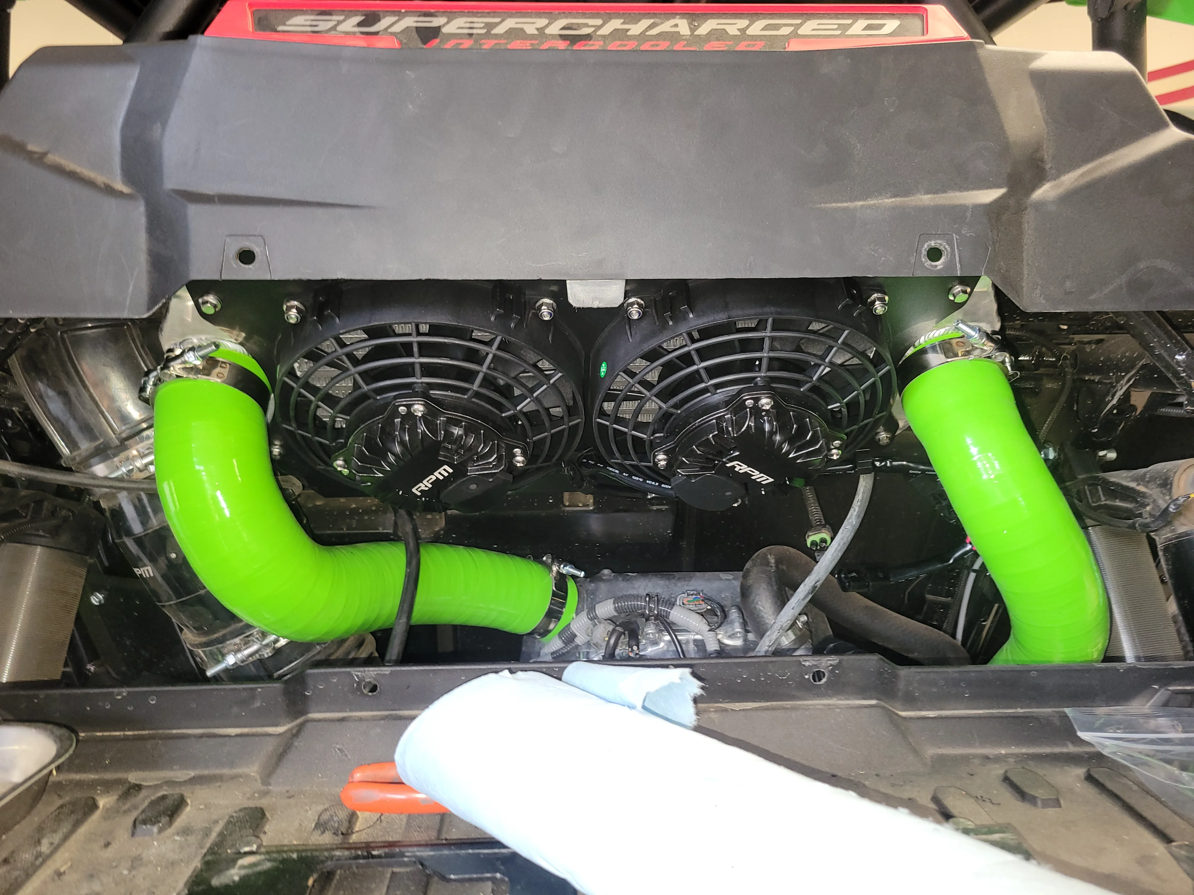

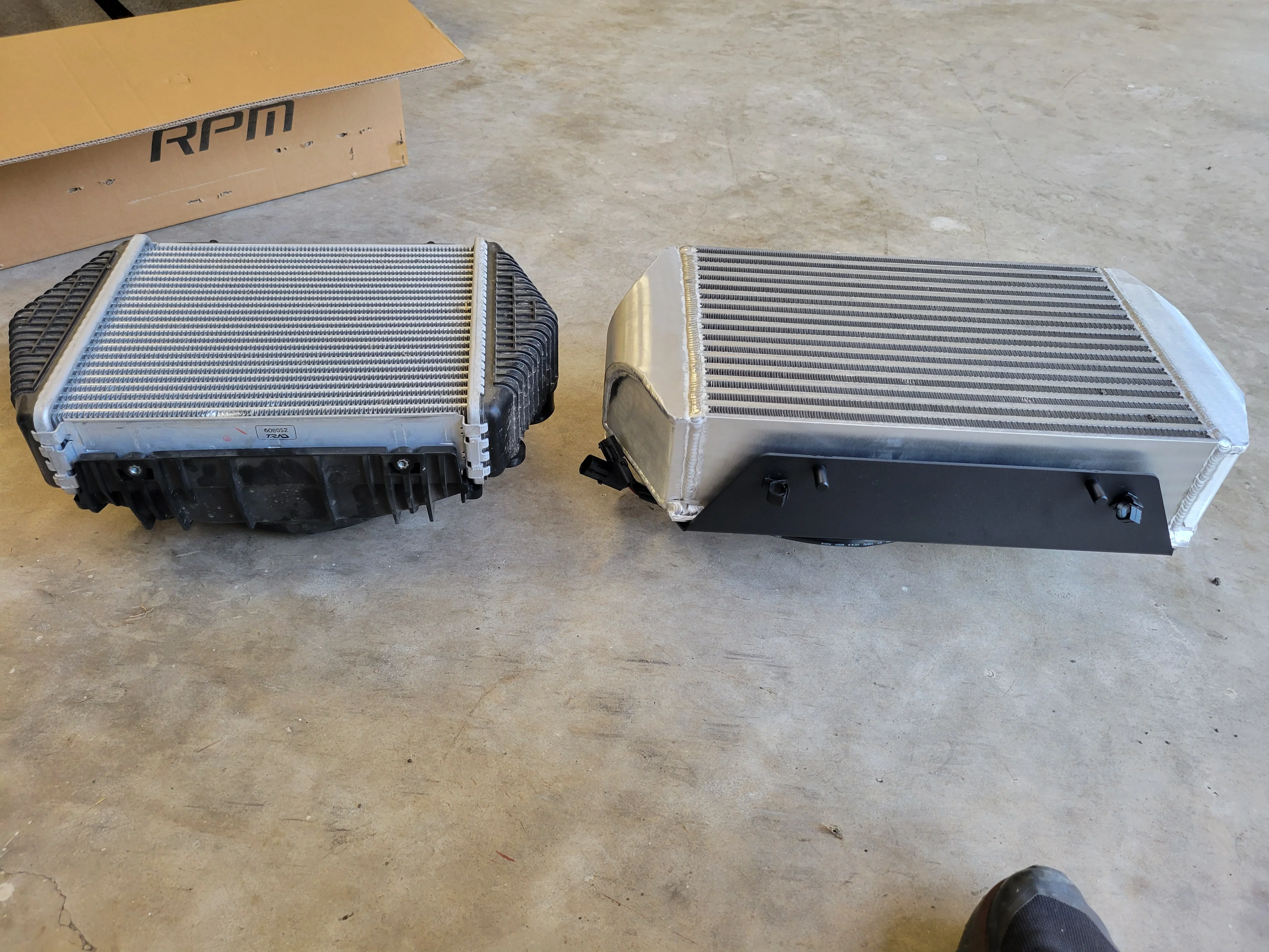

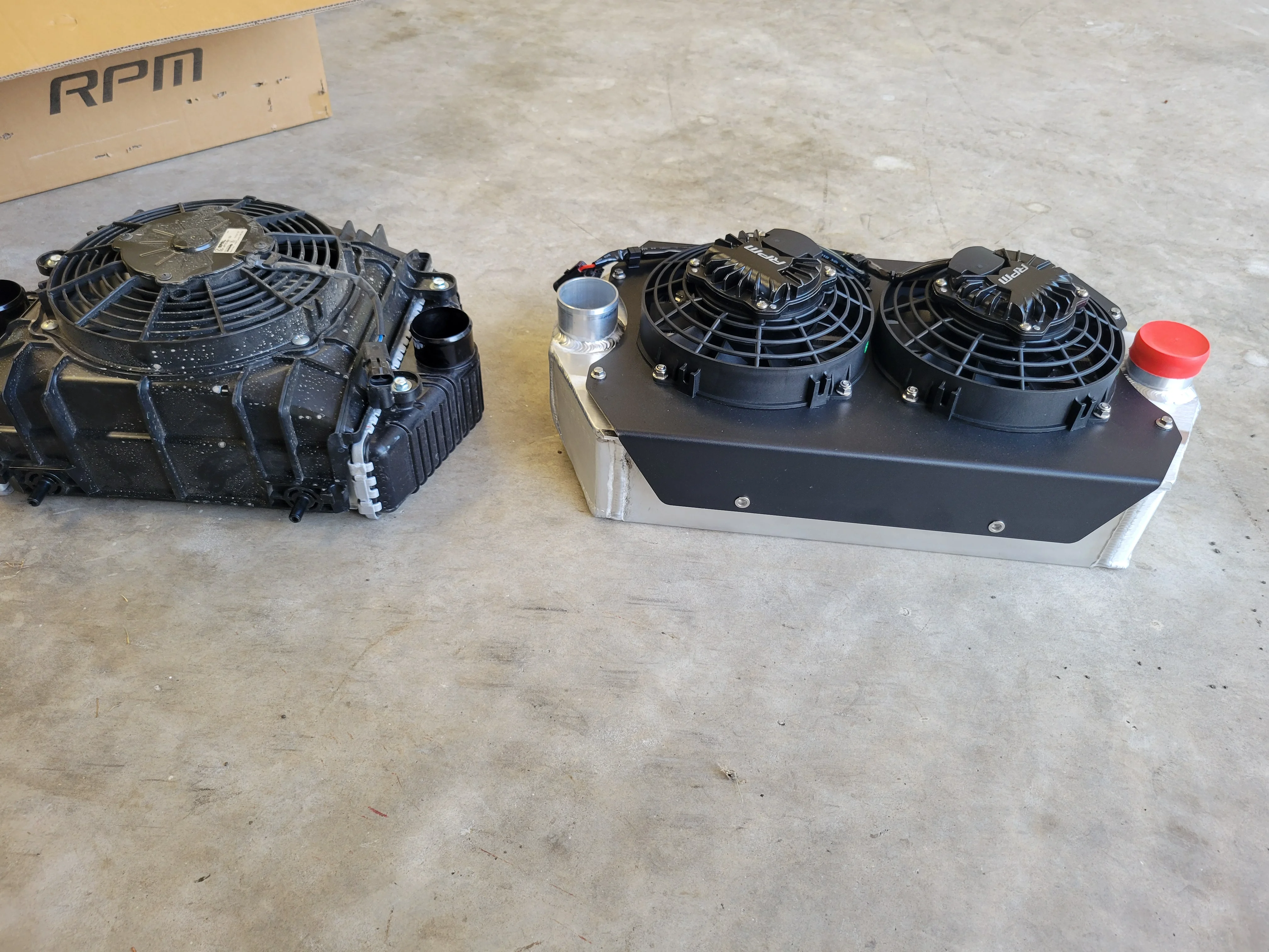

Just installed this big boy!

Who did the machining?
I'm pretty sure he mentioned doing it himself:
I would be curious as to the math involved. I would send mine out to someone who does this for a living.
