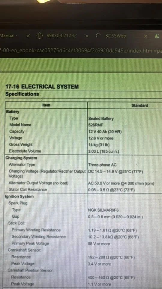

Does anyone know the size of the stator on the H2?

Forums said the KRX was 340 watts at 14.4 volts. I imagine it’s probably the same. The X3 suffered from the same problem, not enough to run a bunch of electronics unless you had storage. I ran the PC1200 Odyssey and it had just enough extra capacity to get through a weekend. But when I got home the battery would need to be topped off with a full sized AGM charger. Kawi obviously knows it’s not enough because day one they offered the extra battery kit. Batteries Plus says the PC1200 fits in the H2 and UTV Stereo makes a second battery kit that actually has a 1200 sized battery included in the kit for the same price as the factory one.

I would assume the H2 has a bigger stator than the KRX as they are different motors. This is the only thing I can find about the stator
