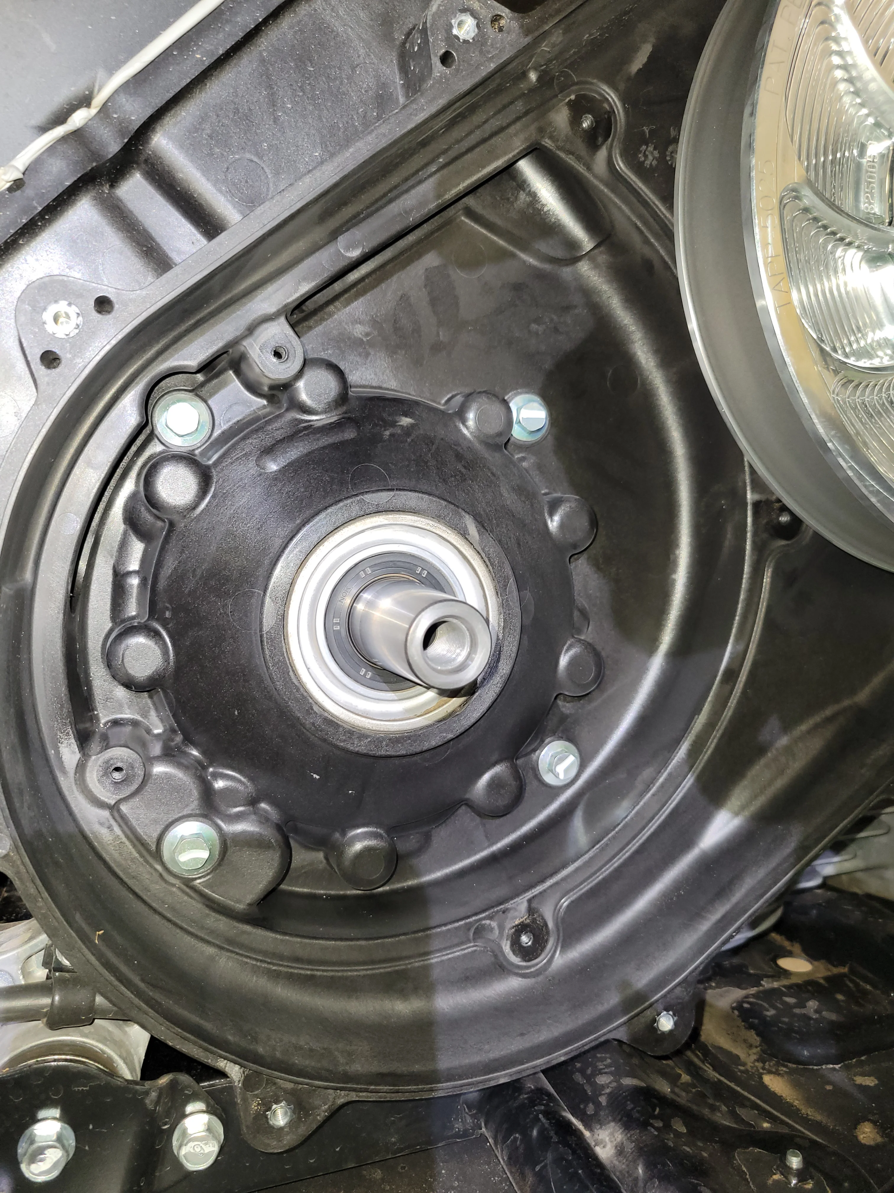

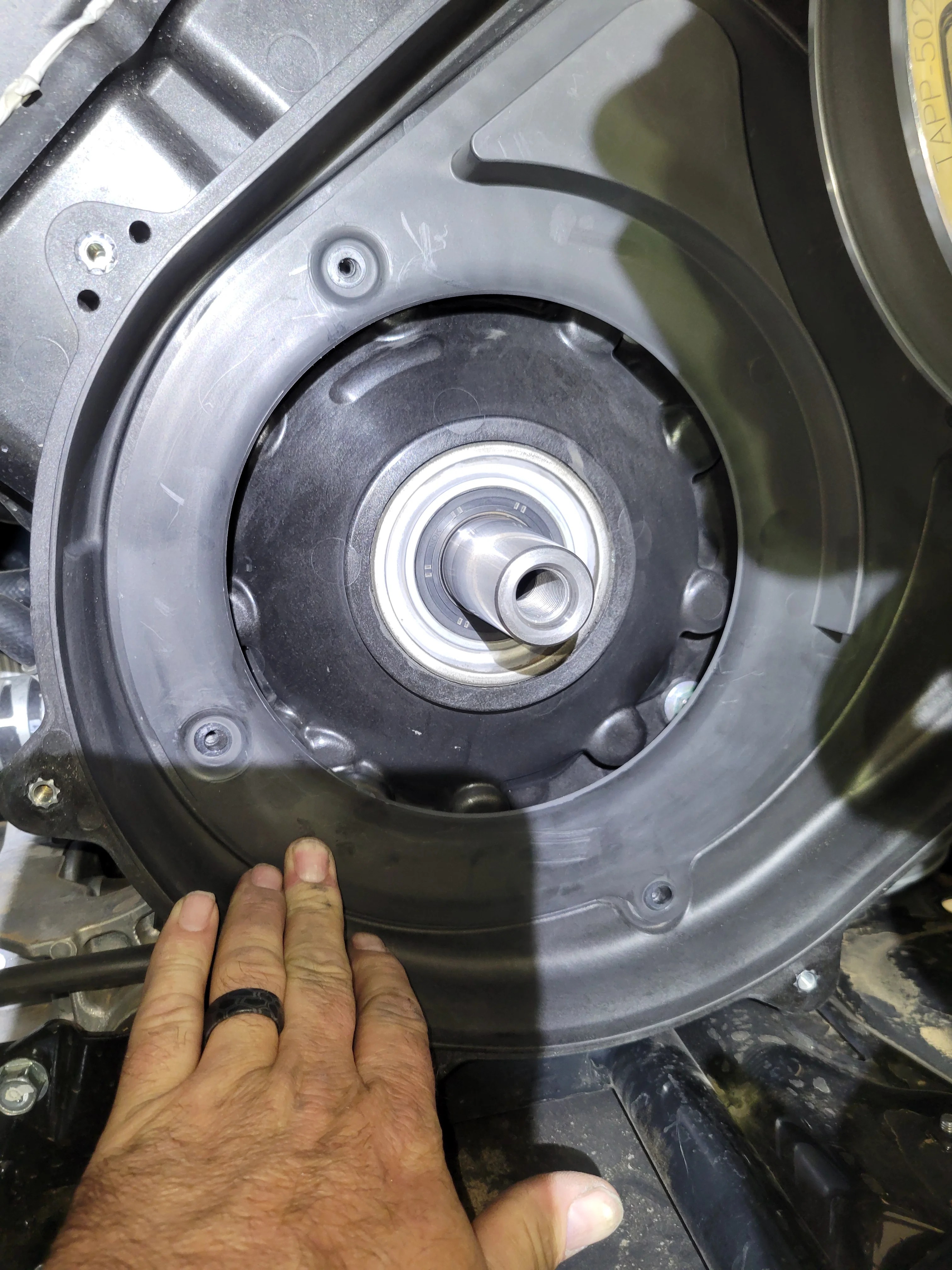

I removed the restrictive plate behind the primary to help move more air with the RPM fan. It makes a difference on the amount of air moving through the cvt box. I am having good results with the rpm fan, green spring, 4 washers on each roller bolts, and number 1 clickers. 3 on the clickers run really well, I just like 1 better. I have the AA 93/95octane tune. This is with the Evo BA belt. In the dunes last week I seen a average of 190.

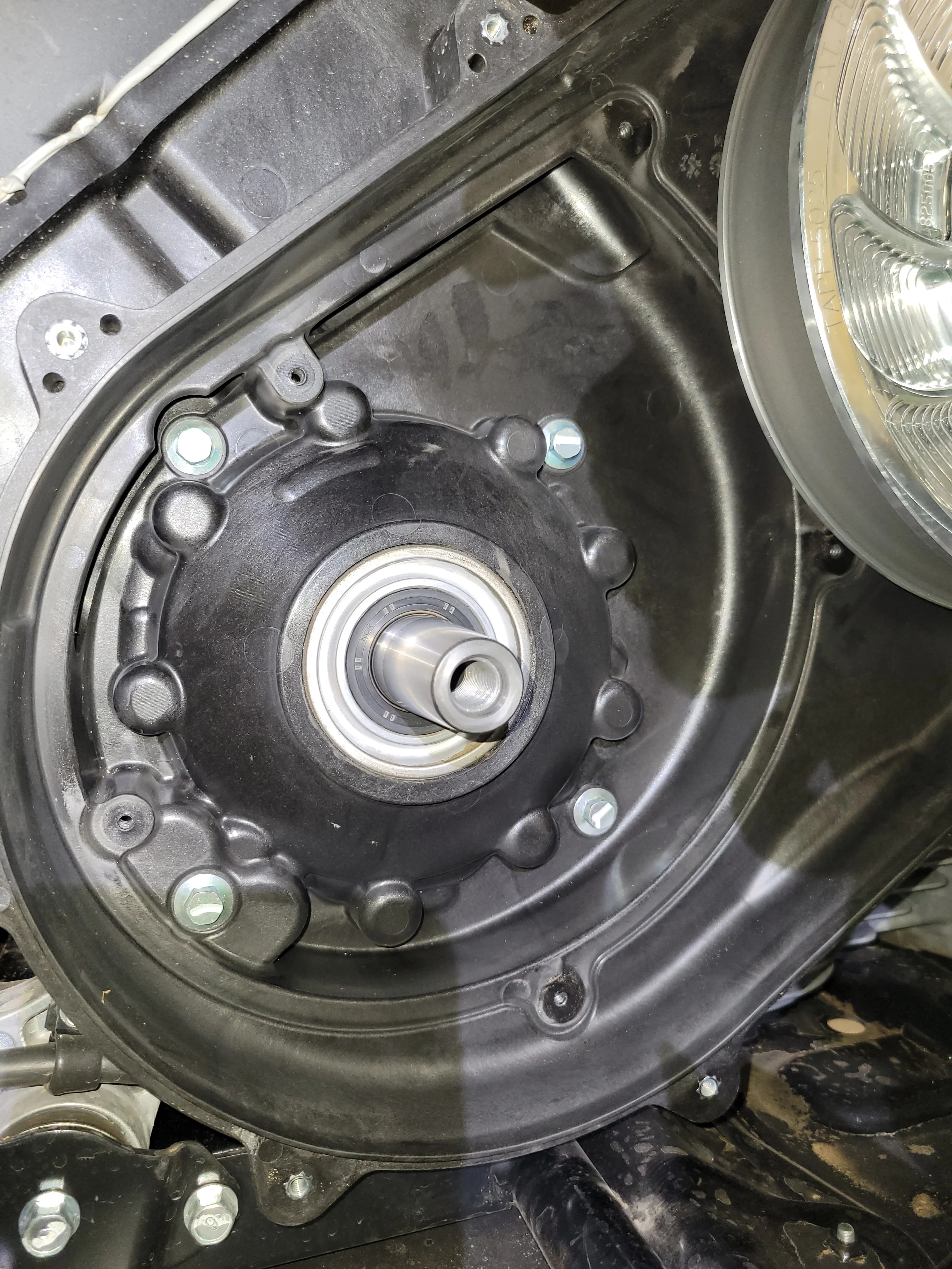

I posted about removing that plastic plate in my Tapp clutch thread, but I'm only running the Tapp primary. It actually worked against me, so I put it back in. It definitely seems like it adds a lot of volume, so if you have an aux fan pushing, I can see how it would work.
I was wondering about how pulling off an air intake diverter plate could help with cooling.
I'm very curious as to how Kawasaki is going to resolve the cooling issue. Batch of bad primaries I can understand and will be a simple fix. Cooling issue is a bit more of a challenge. With extreme mining operations and aerospace experience I'm sure this will get resolved.
Back in the early 2,000's I did multiple over and over and over full throttle pulls up China Wall, Gordons Gap, Oldsmoble and drag racing with the KFX 700. I ran the original belt that came from the factory and only pulled the cover off once to swap to Dalton springs and weights. We all know for sure that Kawasaki has a lot of experience with this type of clutch.
There's only a few ways to increase air flow to cvt. 1) add an aux fan before cvt inlet to increase volume, 2) add more cooling fins to the primary and secondy to pull more air, 3) change design of cvt, relocating inlet to front and exhaust to rear inline with the belt or add an additional inlet. We've already proven # 1 and 2. In my opinion, Kawasaki won't address the issues in their entirety, it'll be up to the aftermarket and customers to get everything resolved. It's gonna cost a lot of money to own one of these rigs.

There's only a few ways to increase air flow to cvt. 1) add an aux fan before cvt inlet to increase volume, 2) add more cooling fins to the primary and secondy tonpull.more air, 3) change design of cvt, relocating inlet to front and exhaust to rear inline with the belt or add an additional inlet. We've already proven # 1 and 2. In my opinion, Kawasaki won't address the issues in their entirety, it'll be up to the aftermarket and customers to get everything resolved. It's gonna cost a lot of money to own one of these rigs.

As far as cooling Kawi can address the issue by adding a second air inlet directly onto the secondary just like what Polaris does. Also adding cooling fins to the secondary would be helpful. If a secondary clutch is all I need to get the cooling and belt life better so be it. I have spend far more on other SXSs I have owned over the years.

I used the RPM fan not the razorback. The razorback is same diameter as the intake tube where the rpm is much larger allowing air at high speeds to funnel around the fan and not just through it . It is half the price as well. I didn't feel that it hurt at high speeds at all and love how it cooled the belt down extremely quickly when you take a break. Gotta think that alone will help with overall belt life when its not just baking inside that cover when you stop. Awesome video by the way sunday sxs. Kept me entertained on a friday night for quite sometime. Love your channel
I would love an update to see if you still like the RPM fan and if you still think its worth it. Couple more questions... I am also curious about the noise. I know sounds stupid but after using an S&B air separator on my last rig I am gun shy about fan noise. Does the fan run after the machine it turned off or does it turn off immediately?
I still love it and believe it helps out. Went on a almost 200 mile weekend trip up near grand canyon. Highest temps i saw on razorback guage were 190 but that was going 60 down a highway for 15 miles, something I don't normally do. You cant even hear the fan unless you are outside the car. It does keep running with key on so you can cool the clutches when you stop. I too had an SB on my old RZR and its nothing like that.
