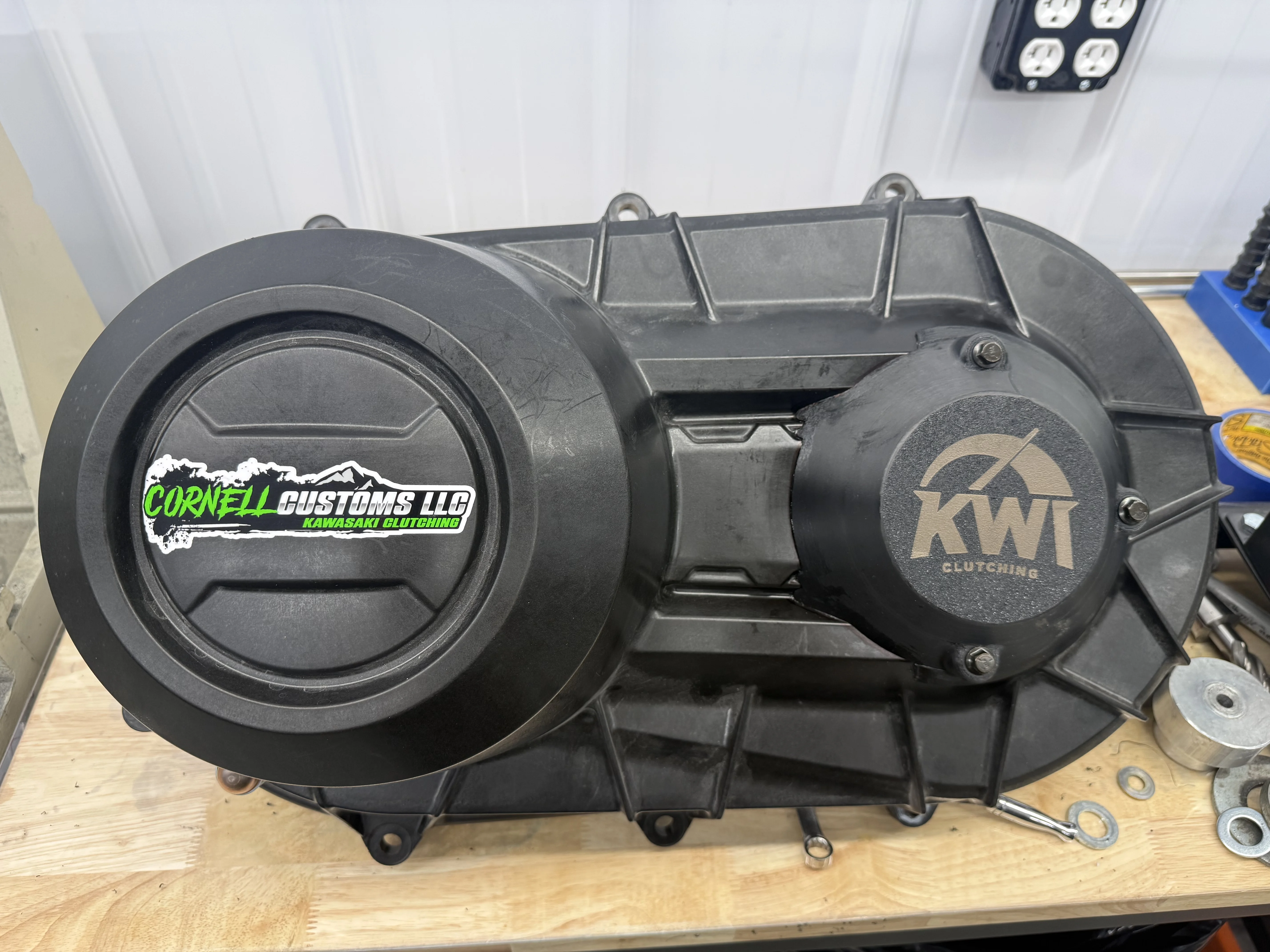

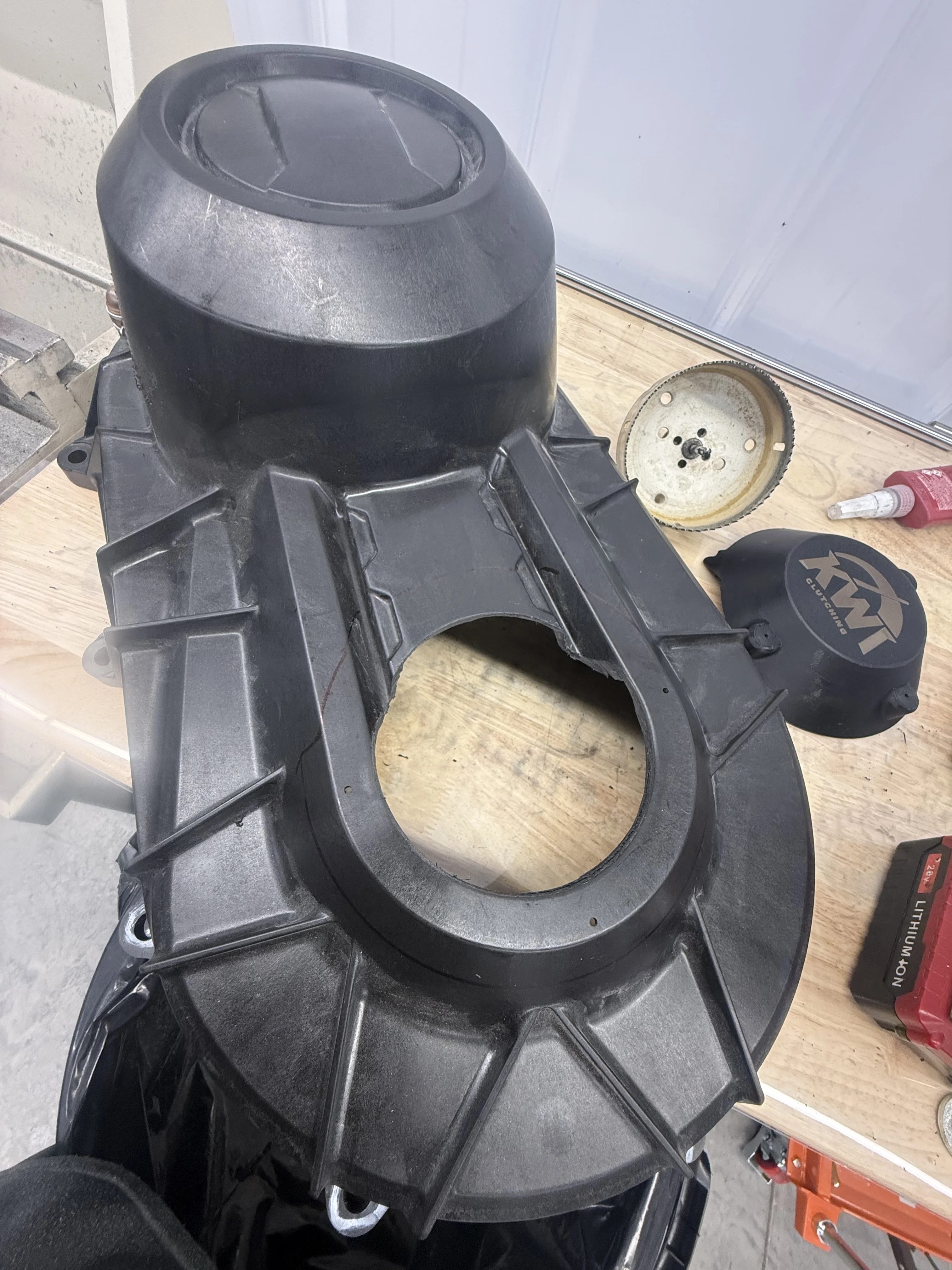

KWI Clutching H2
KWI gives you a magnetic setup to hold the cover on however I did
Not feel it would be watertight so I chose to bolt mine on and seal it with silicone so it is watertightz
