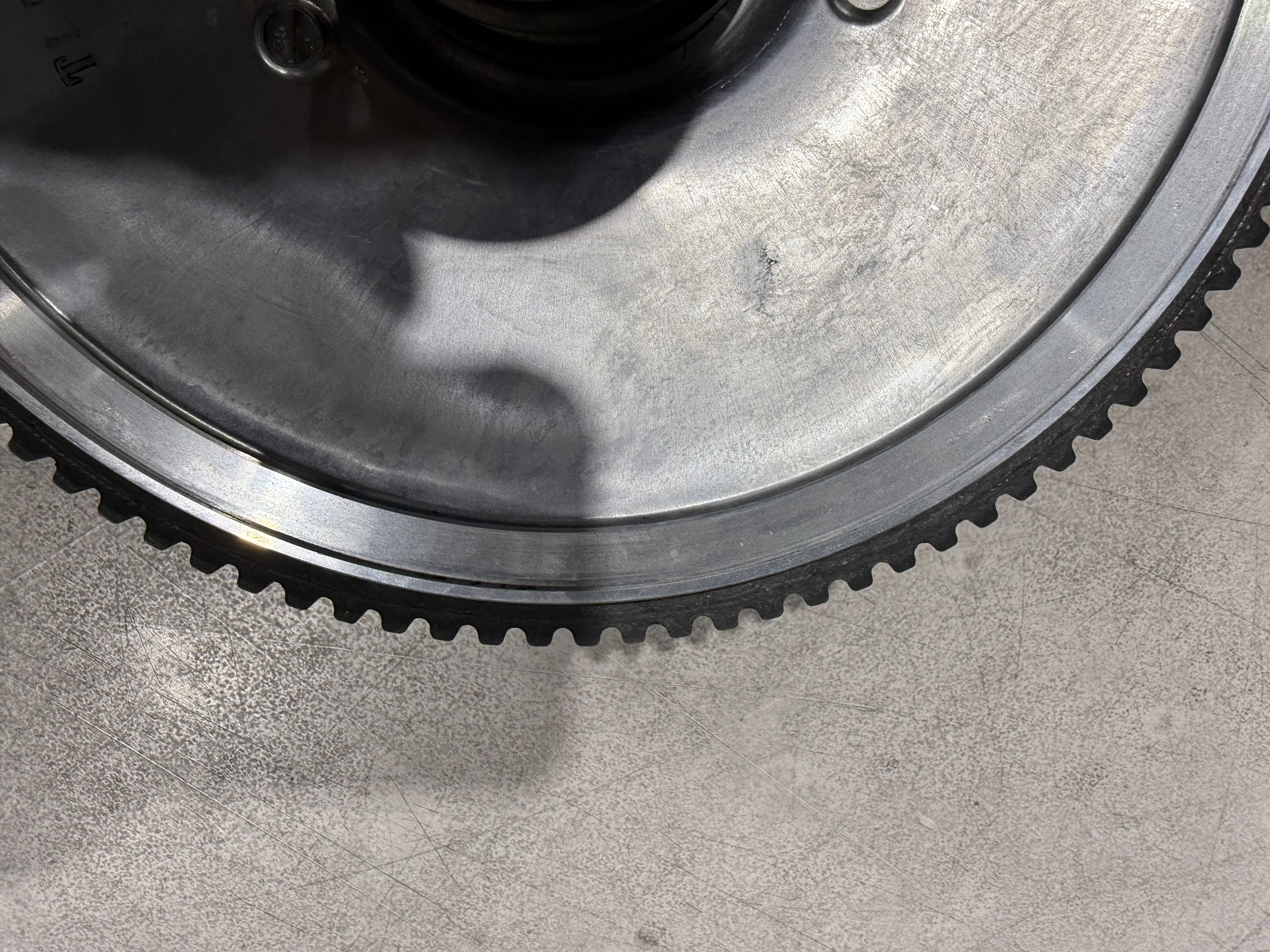

Can you run the Pro R belt with the stock primary and secondary?
No, it is too long, we have modified the stock secondary to run it, it runs high in the sheave but we have not had any issues running it like that but we don’t have a lot of miles on that setup.
That’s how we get the reduction , we run them this high on the KRX with no issues at all but just haven’t ran it like this a lot on the H2
In your picture of the KWI secondary it does not look like it is running that high up. Are the KWI secondary sheaves bigger in diameter? I'm assuming they are a whole different design. And man I do like the quick spread tool!! Sure looks user friendly for swapping belts.
Yes, the KWI secondary is larger in diameter than the factory secondary, and this picture is of the factory secondary with our modifications to run the longer belt.
