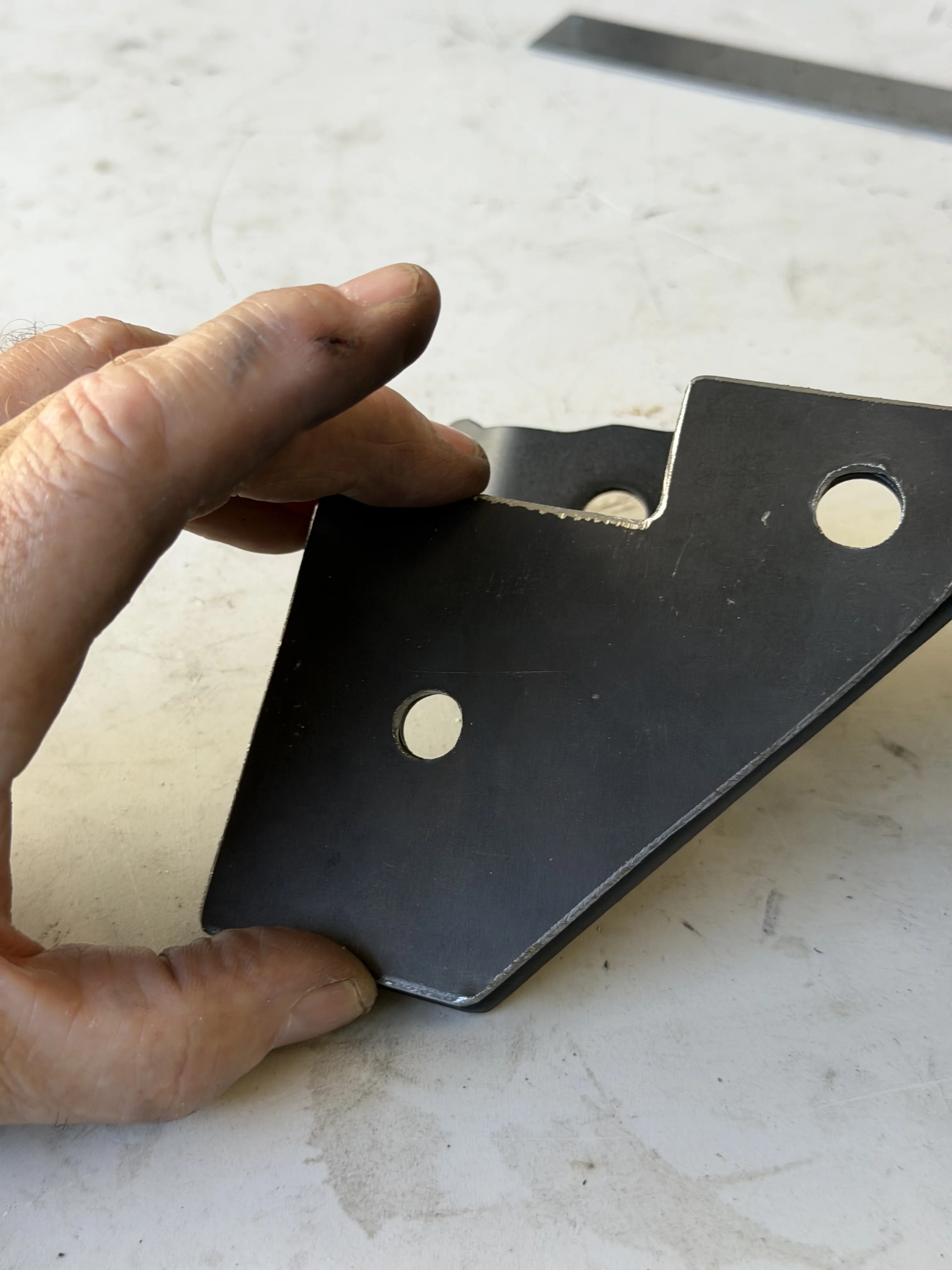

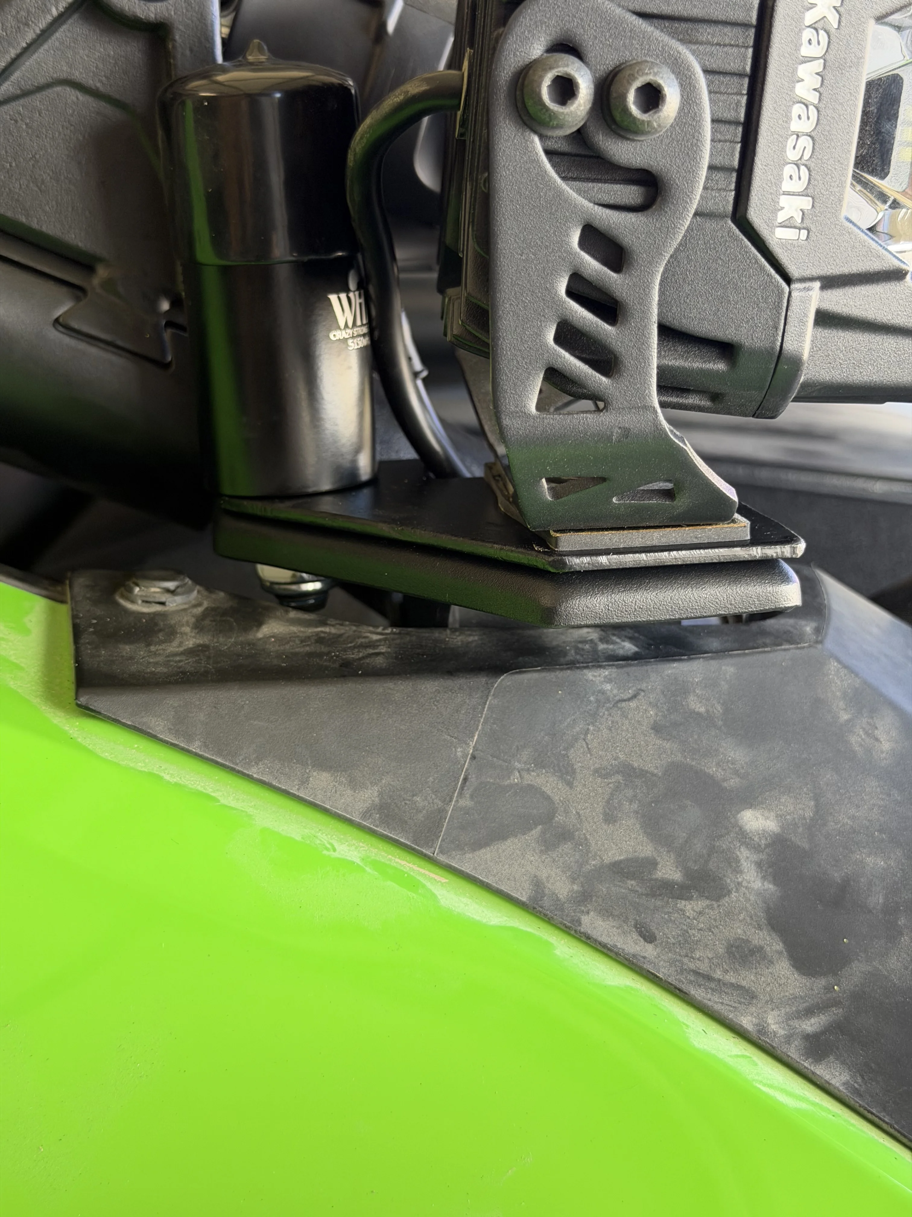

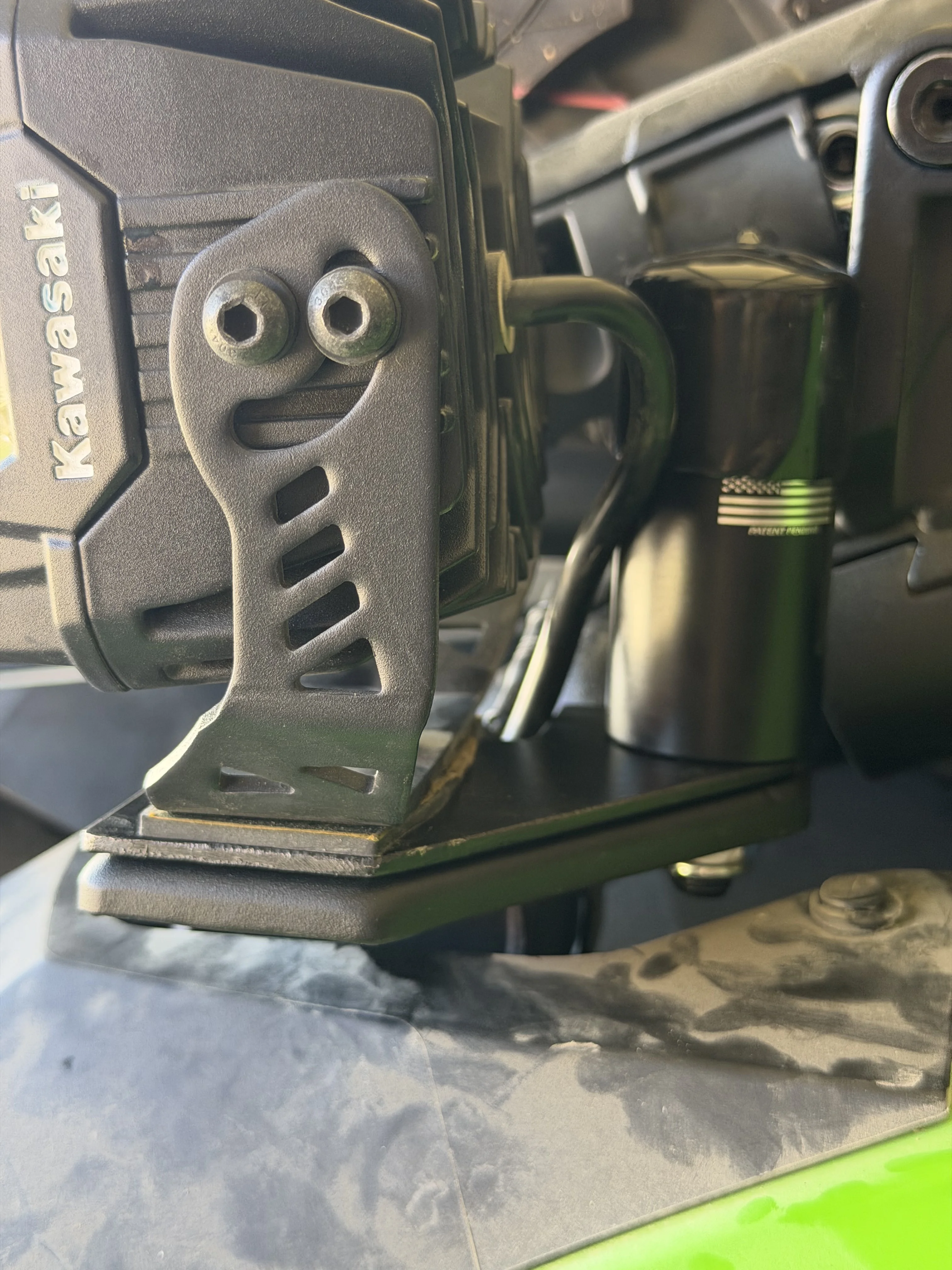

In keeping in the theme of this thread, while not as fancy, I did a solid modification A few weeks back. I fabricated a few plates to reinforce the combo whip/light mounts. I noticed both of them bending back when using the 5150 whip lights and flags.
This completely made the mounts rock solid. Only for the cost of some 12 gauge scrap plate I had lying around, about 1 hour of my labor and one cut off wheel. Field tested in some rough hero dirt and has not budged!!

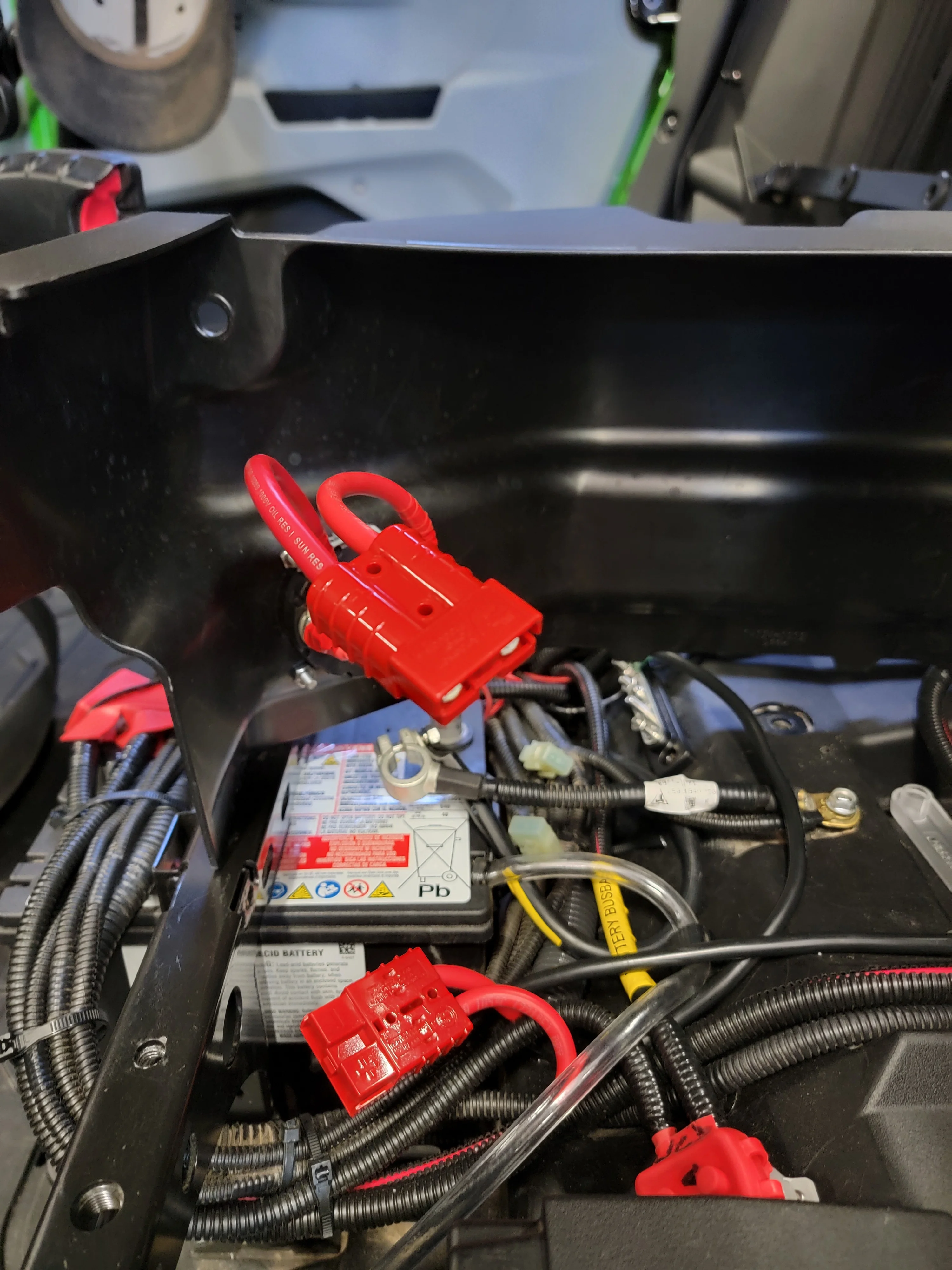

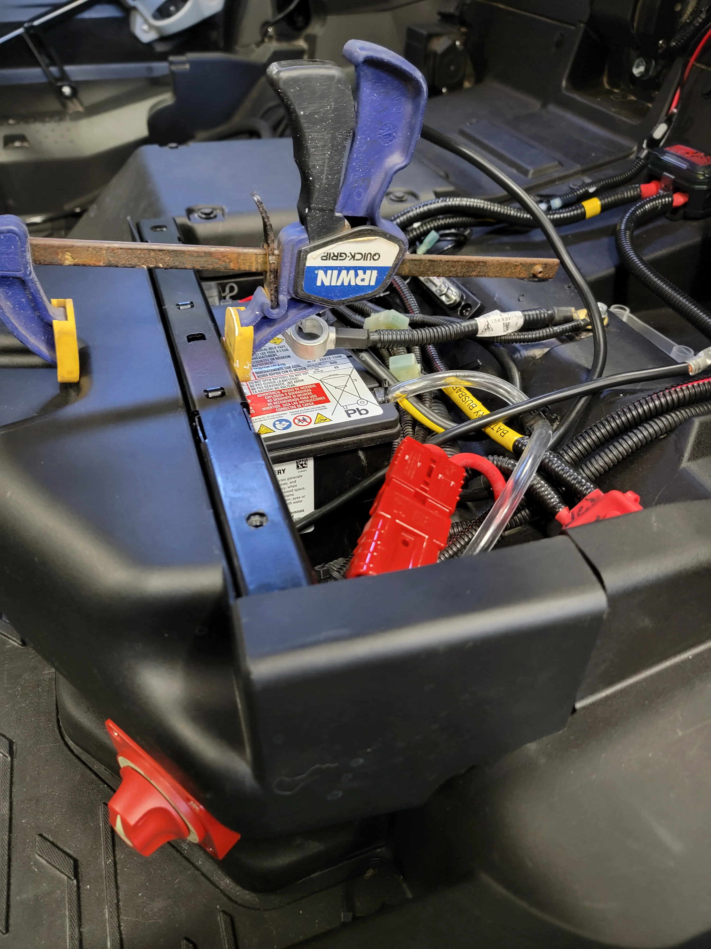

Today I finalized the winch connections at the battery. Not being a fan of large conductors connected to the battery without fuses or breakers, I added a marine battery switch in the battery cover with Anderson QD connectors so I can remove the battery cover easily when needed. BTW, I contacted Warn and they stated no fuse or breaker necessary for the Axon winch... :rolleyes:

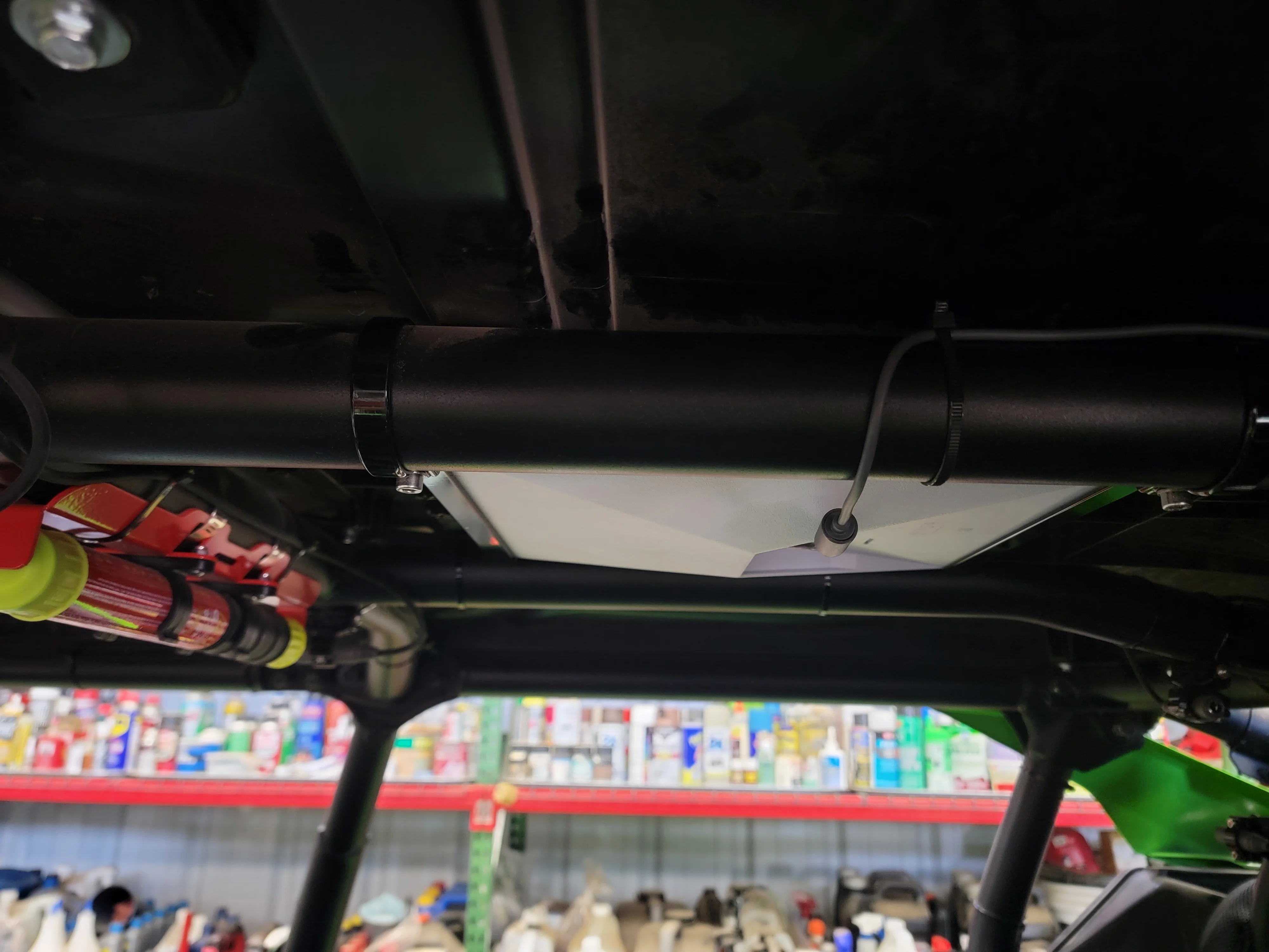

I'm installing the RPM aux fuel tank as well, so things are not quite finished yet in the back. Oh, and in the 3rd pic, towards center back, is the Sierra6 switcher main fuse. I'll post more on that later...

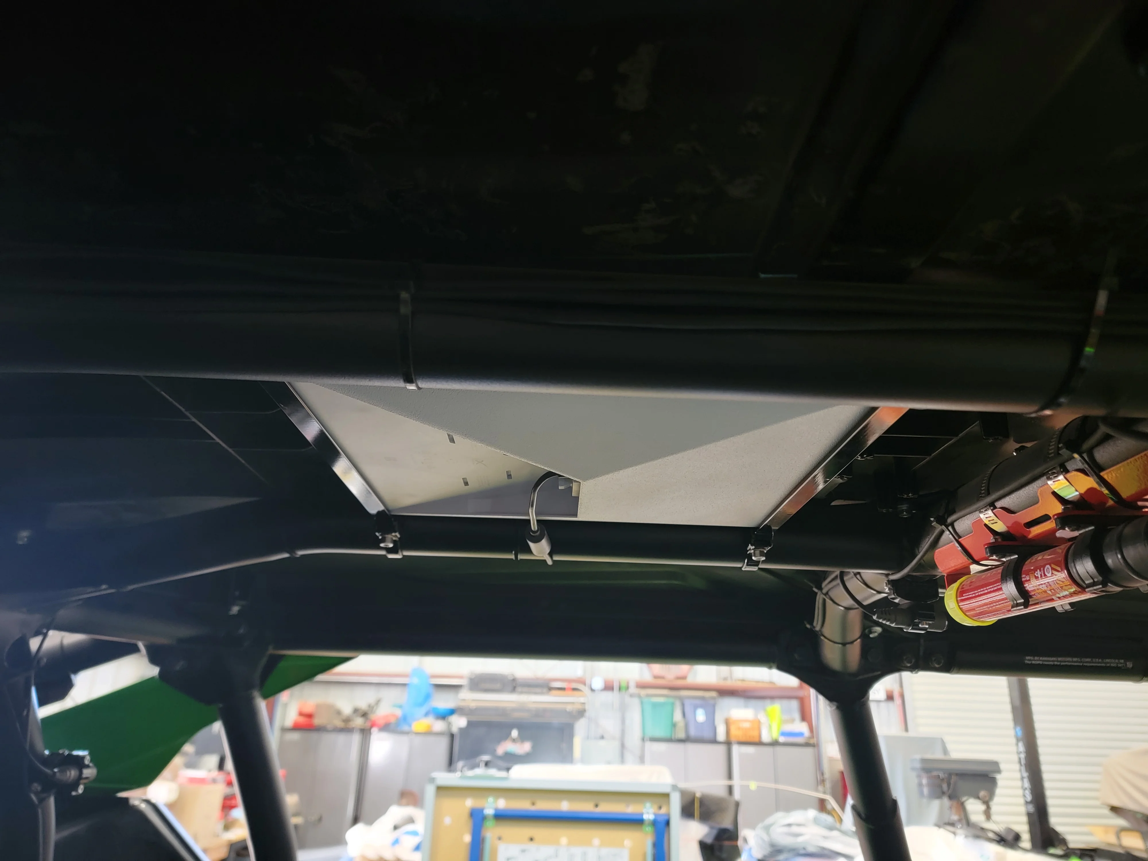

RPM aux fuel tank:

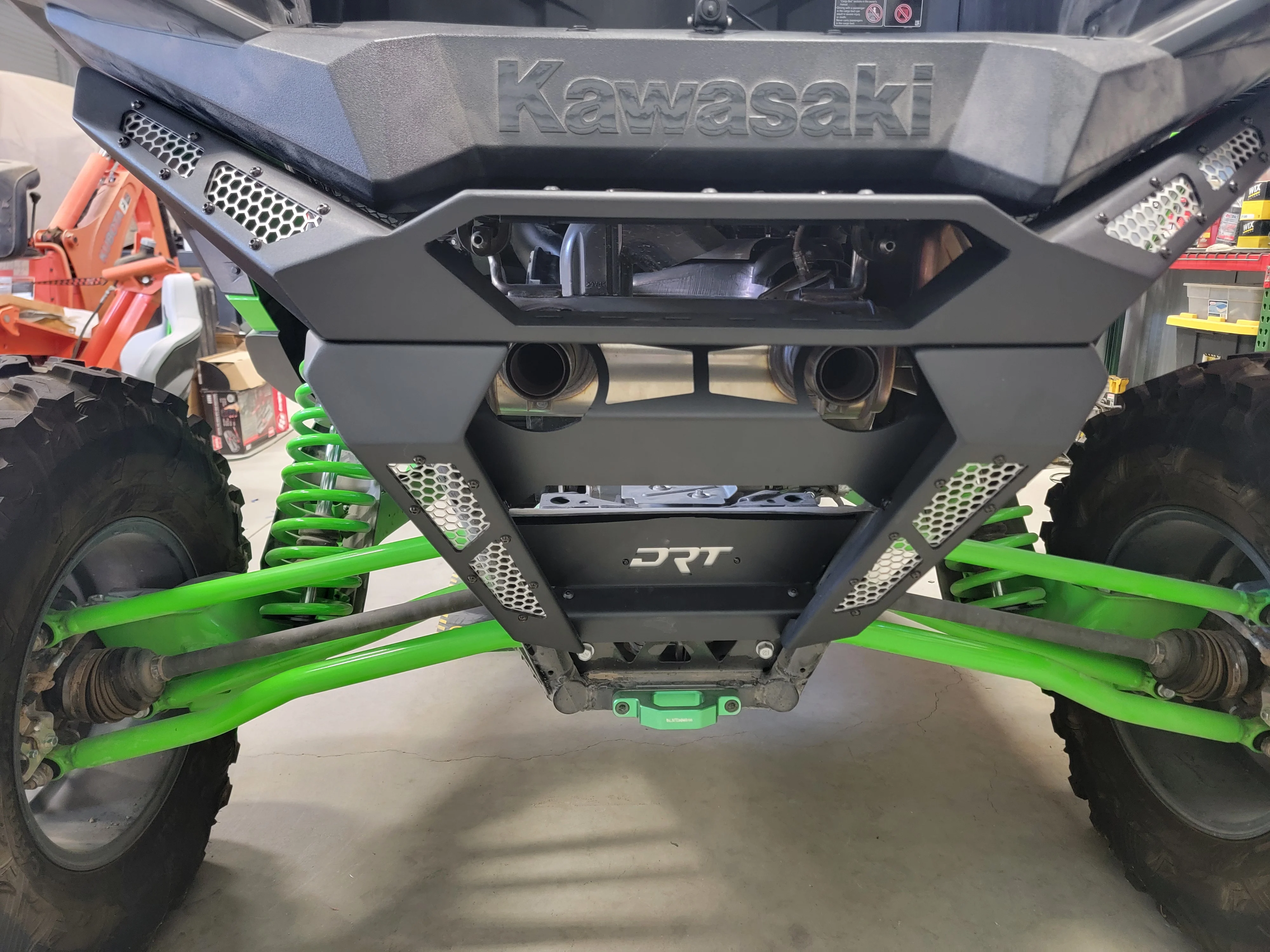

DRT rear bumper and Garmin rear cam: What's not showing are the BD chase lights and 5150 whips.

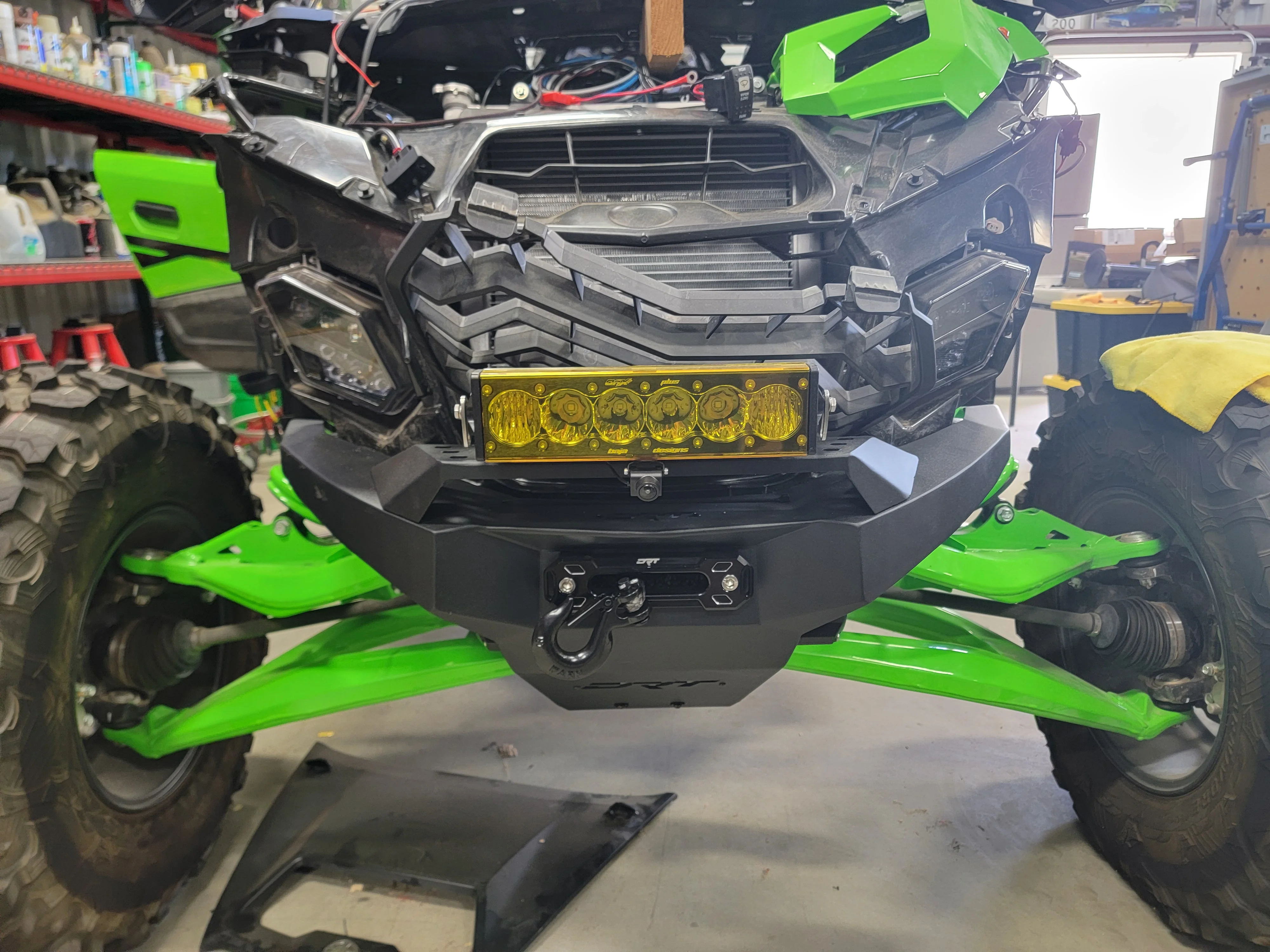

DRT front winch bumper, Warn Axon 55-s winch, BD OnX6 light bar, Garmin front cam:
