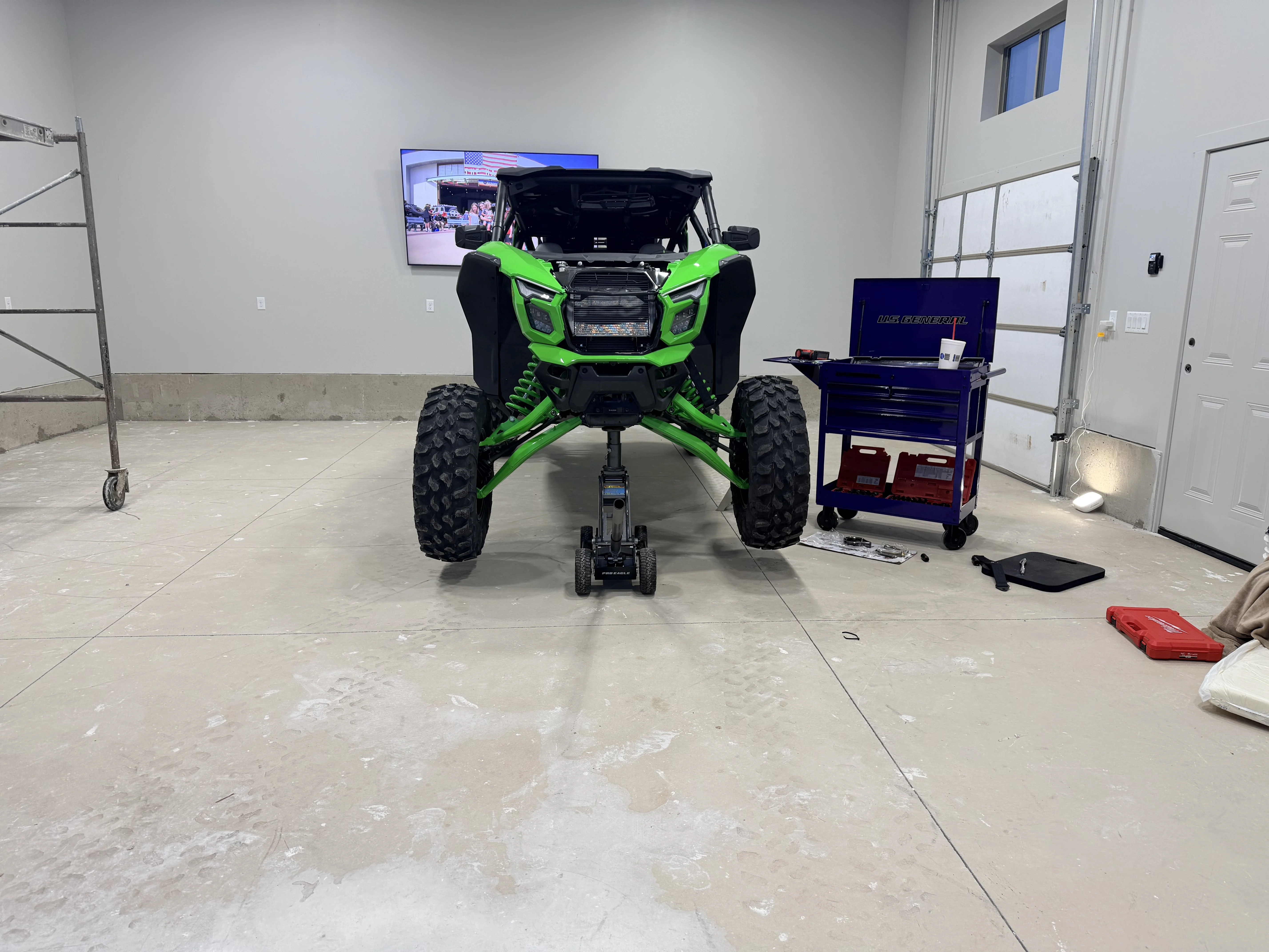

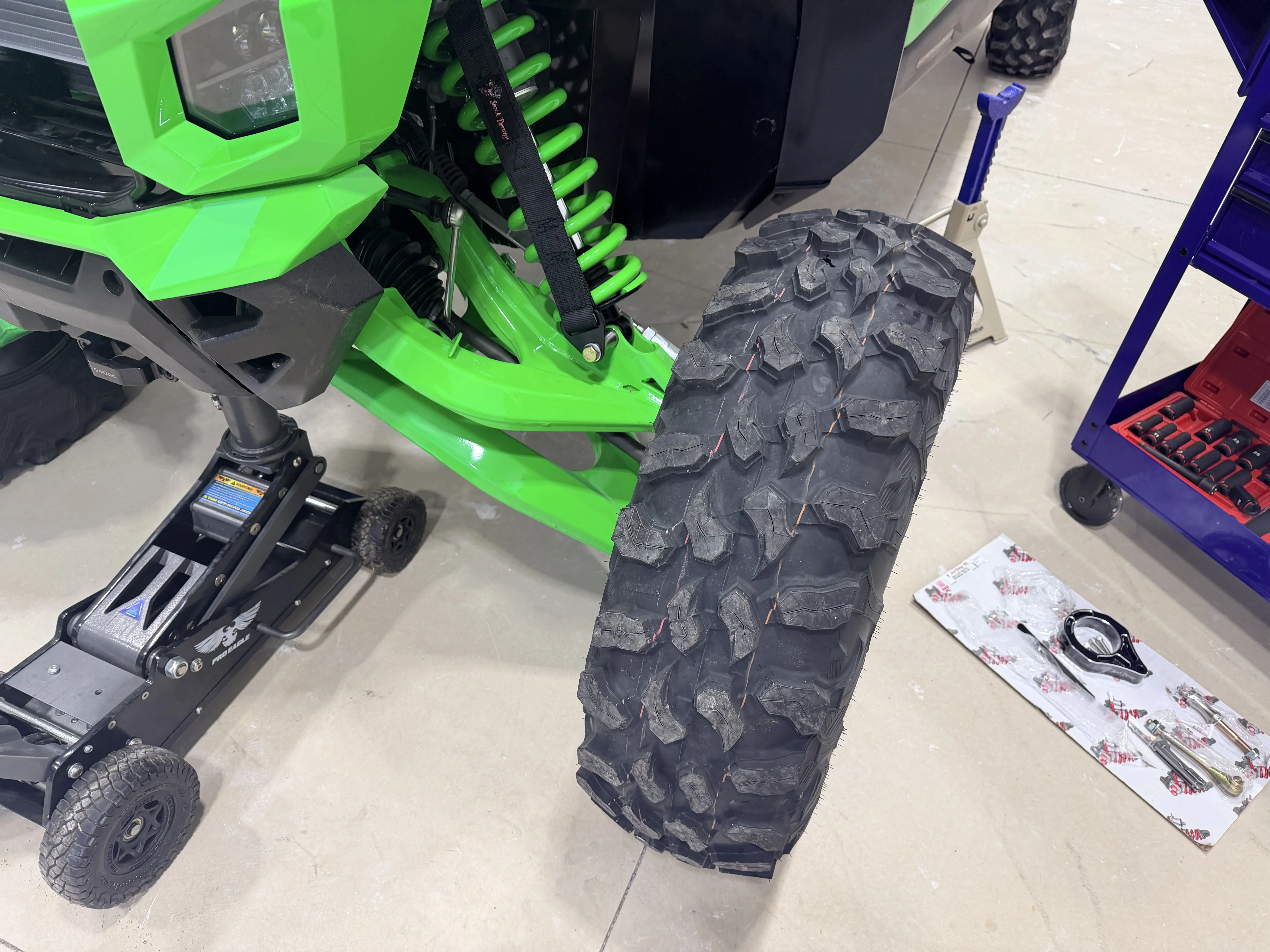

Hitting Moab this weekend and added some limit straps and plan to take the sway bar off if I can figure out how to get it out.
Fresh strap on the right, no strap on the left. Holds it up 1.5” and they say you will get a inch of stretch so perfect out of the package.
