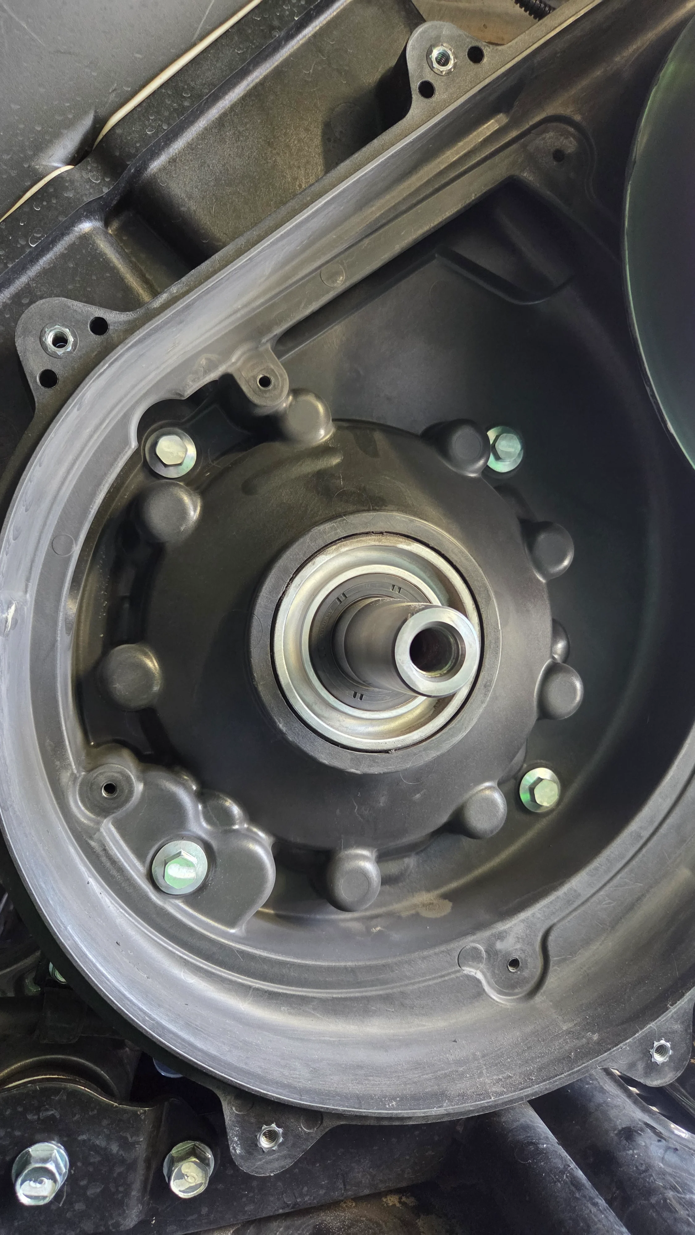

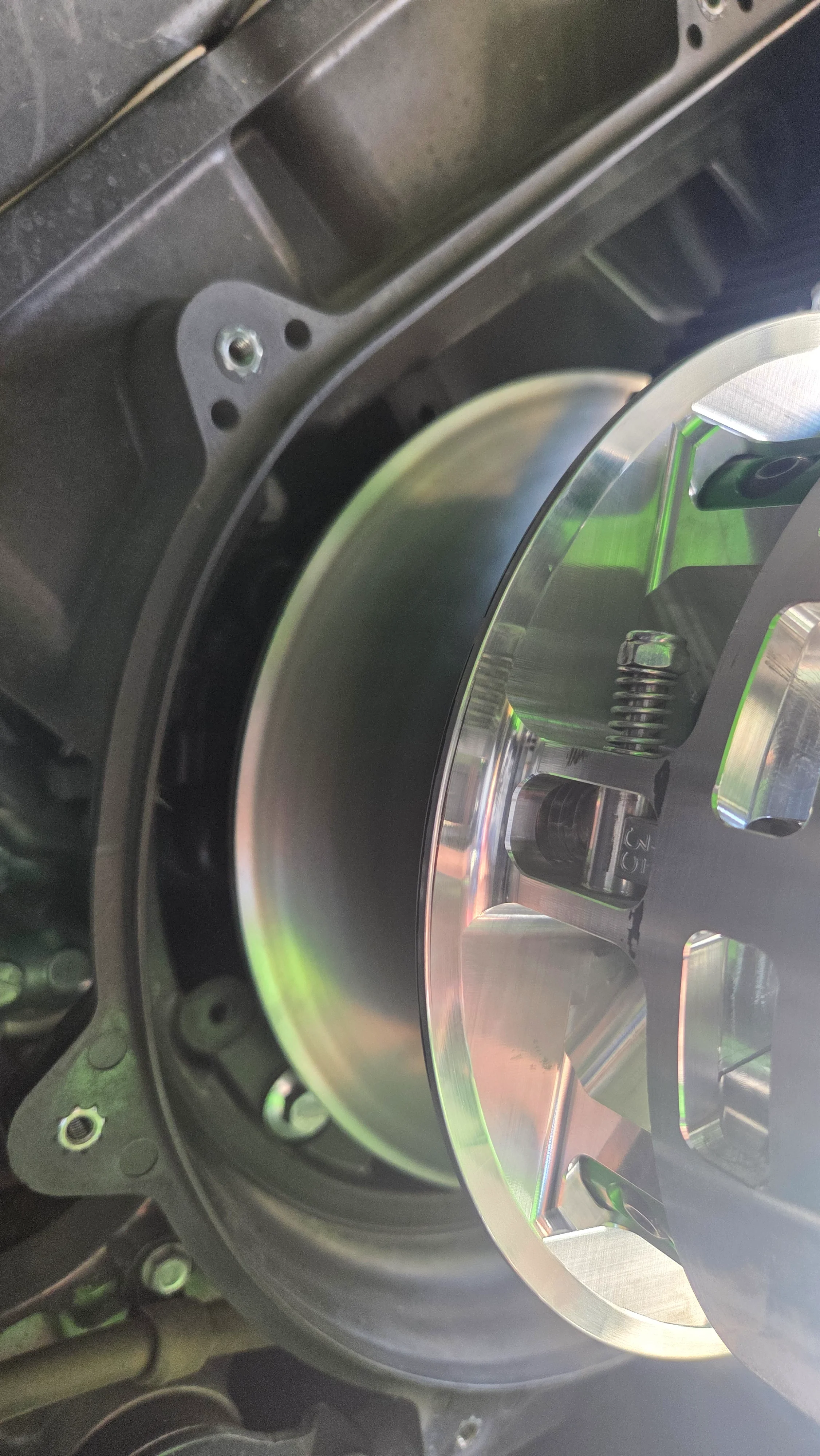

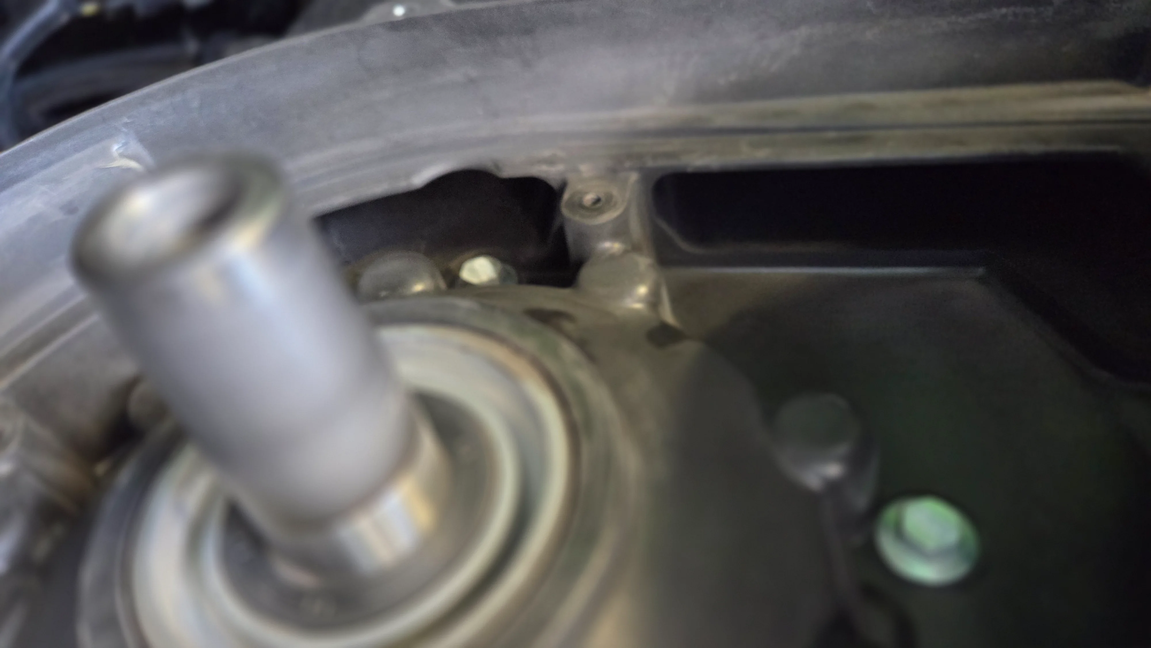

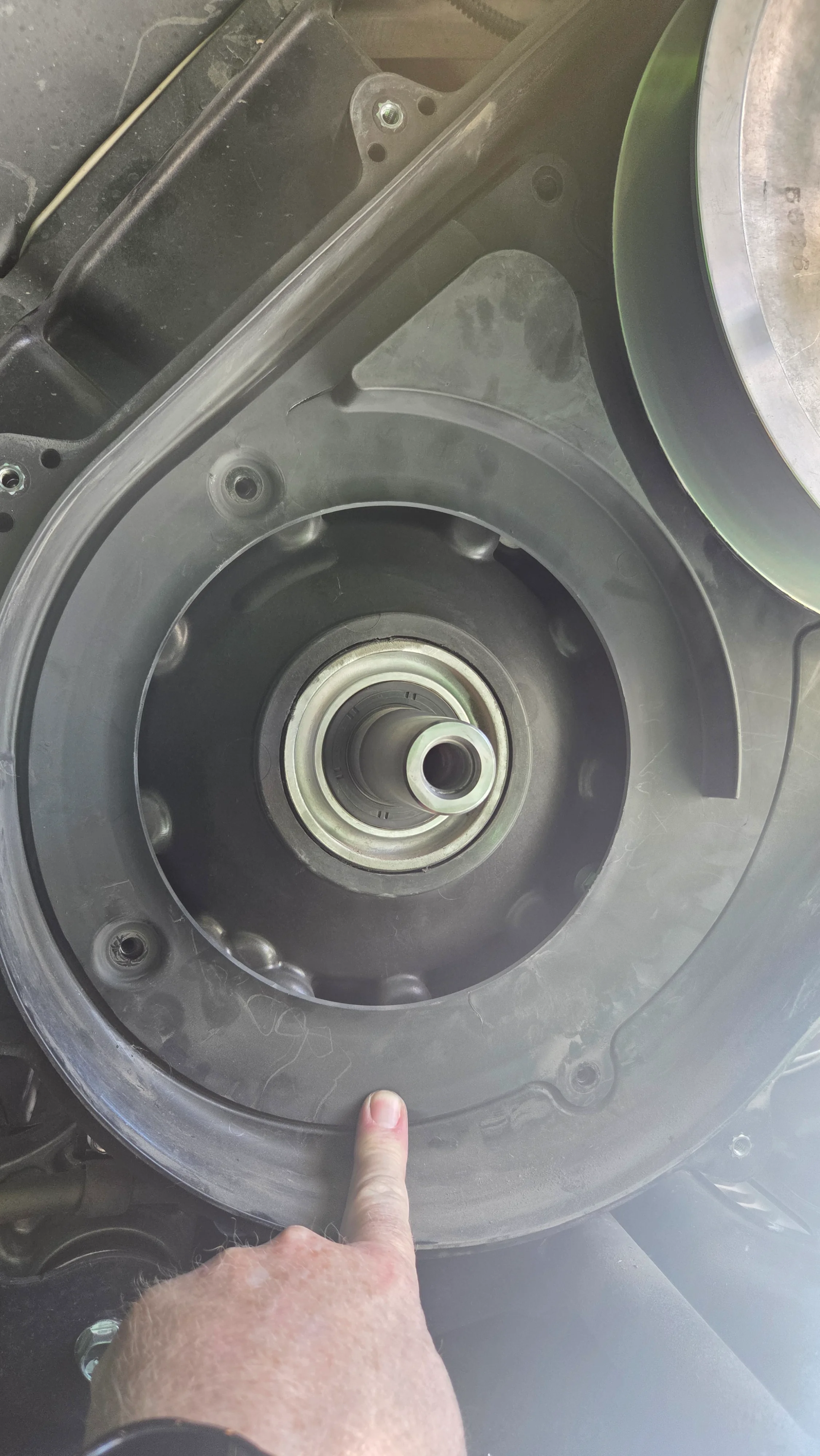

I decided to do some more testing to see if i can improve airflow through the CVT cover. The CVT air inlet has a think cover and an air damn that directs airflow. It looked to me like it would restrict some air flow. I decided to remove it and see what happened with the Tapp primary and stock secondary. You had to pull the primary to remove it and it wasn't easy to remove the screw behind the secondary, but I got it.
After reinstalling the primary, I started it up and idle temps never moved, but I didn't think motor was pushing much air through the CVT exhaust outlet. When I ran it, it actually seemed to have some benefit will cruising and running in the midddle of the powerband. However when I started getting on it harder, iy was clearly not moving enough air and allowed the belt tempsmto get higher than without it. Also, it did not want to shed heat very well after it got hot. Didn't help much to run slow or idle, it just barely dropped a few degrees after several minutes.
So while I'm glad I tested it, I dont think it will help with this setup. Maybe with the secondary it would with extra cooling fins, but I have my doubt.
Here's a couple photos to show what I removed.
