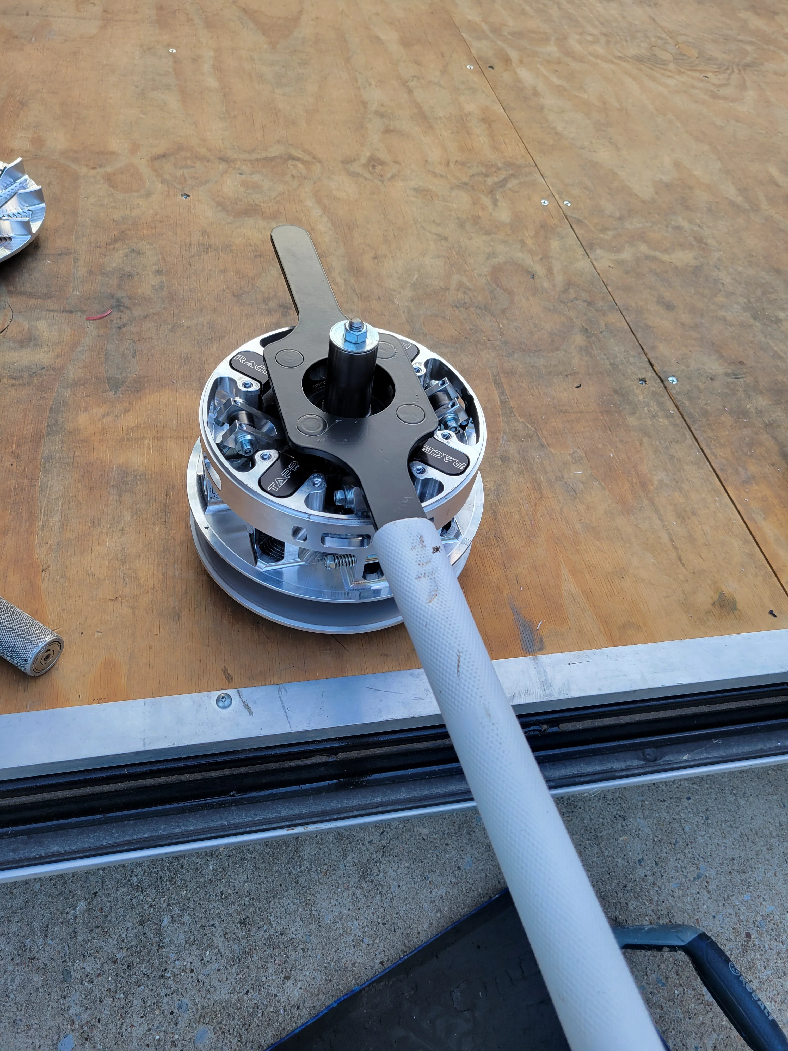

Ain't gonna happen. Go watch the videos of the Tapp clutch assembly. They ain't using readily available tools. These are custom tools that they built or had someone else build. Massive breaker bars that are 4 feet long. Not sure why they use them, but that's how they do it. At that point, I'll just pay to have it fixed.

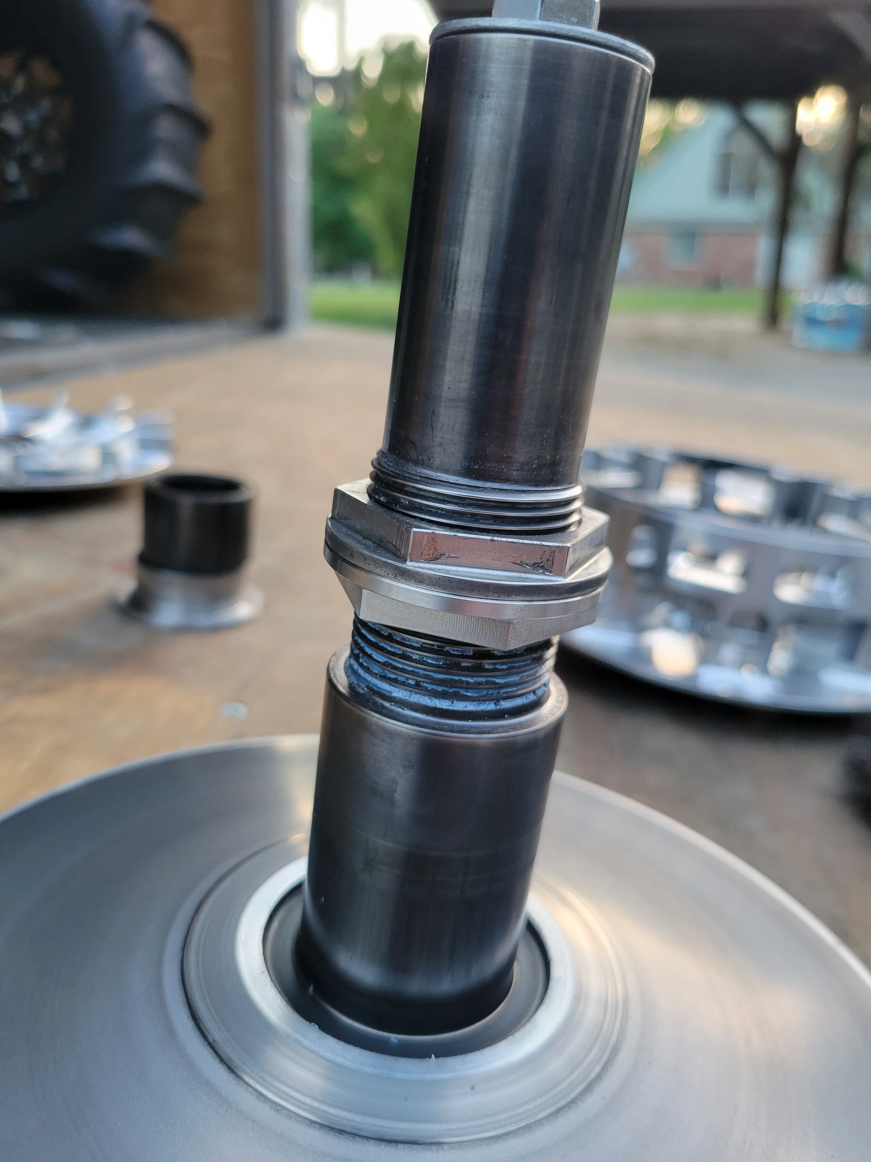

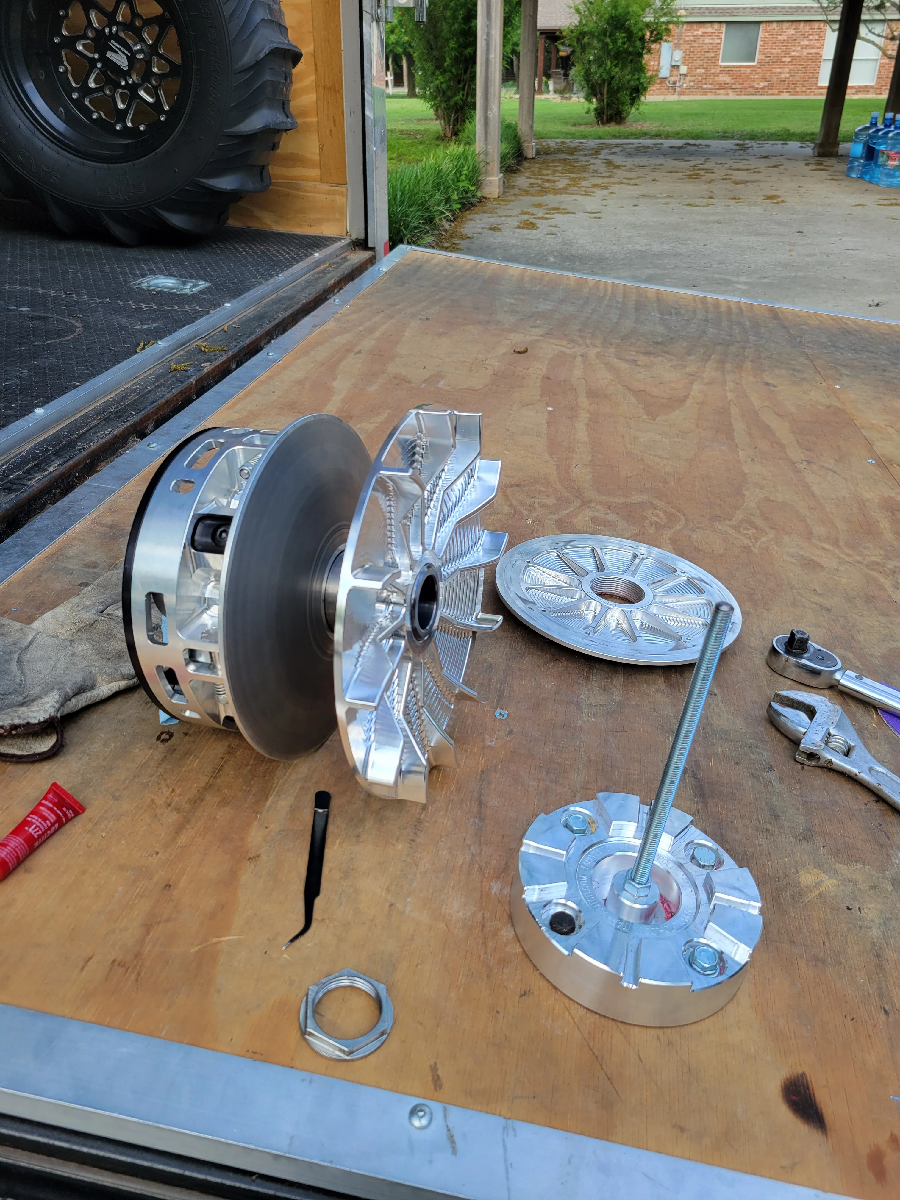

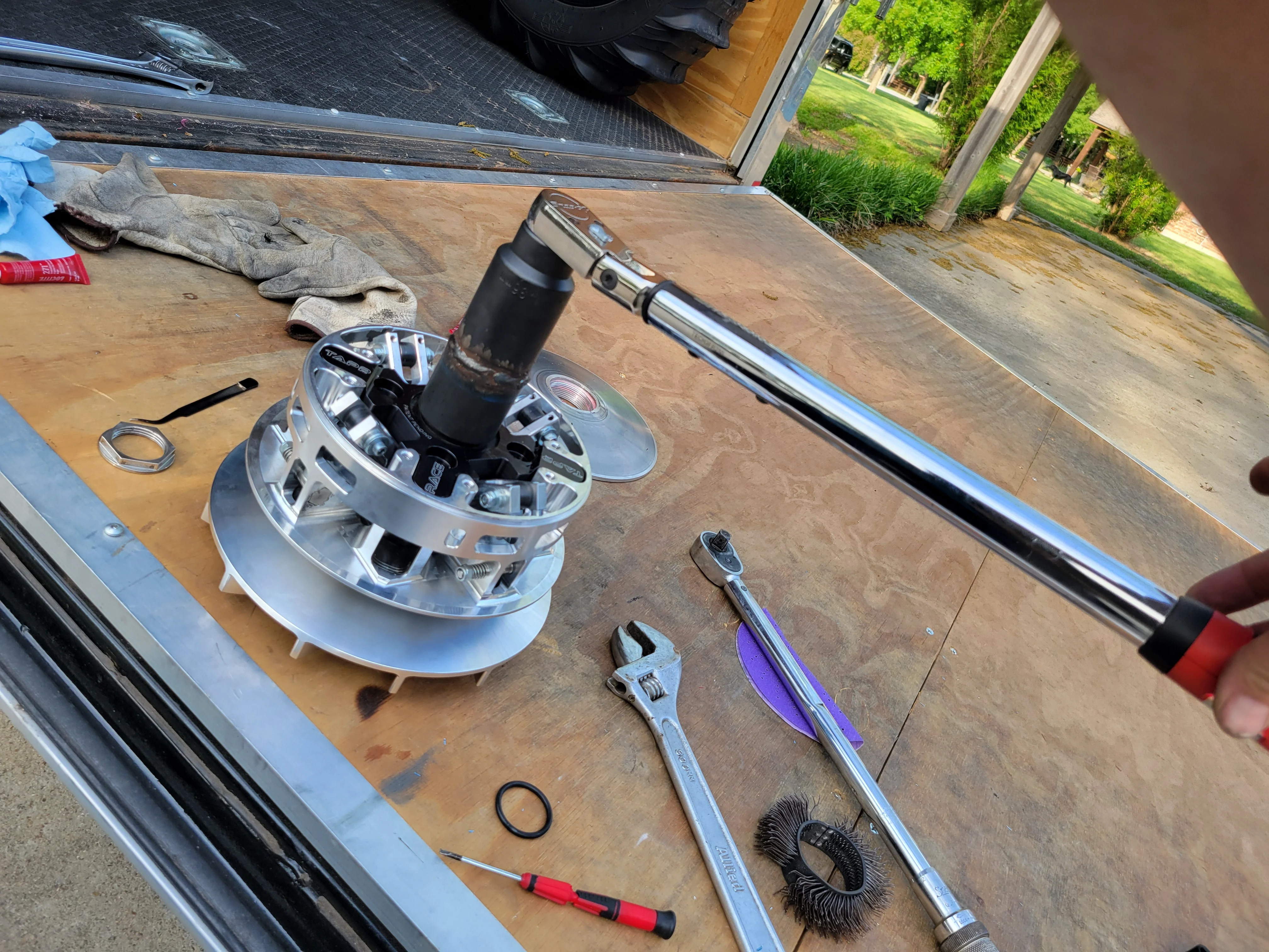

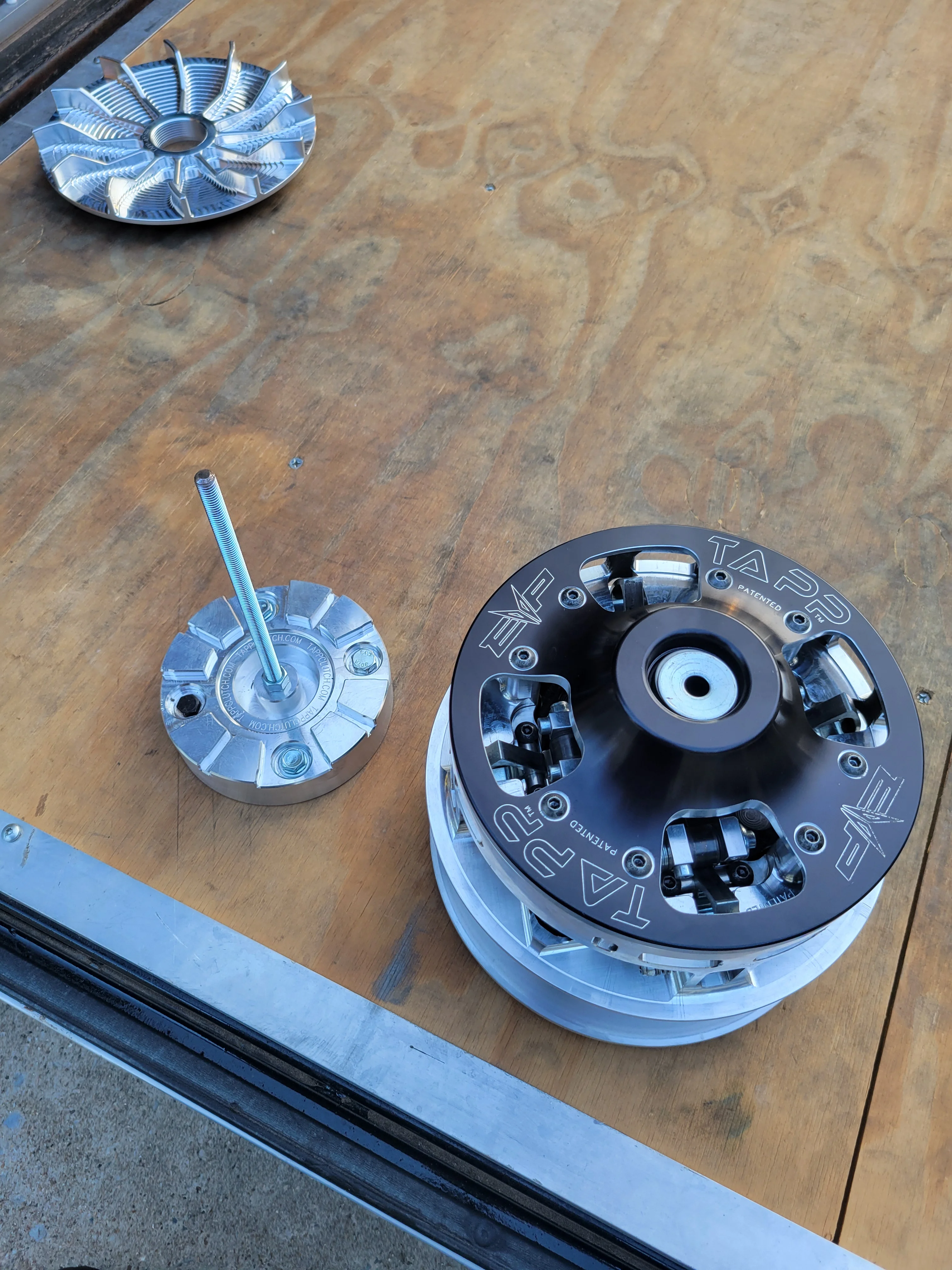

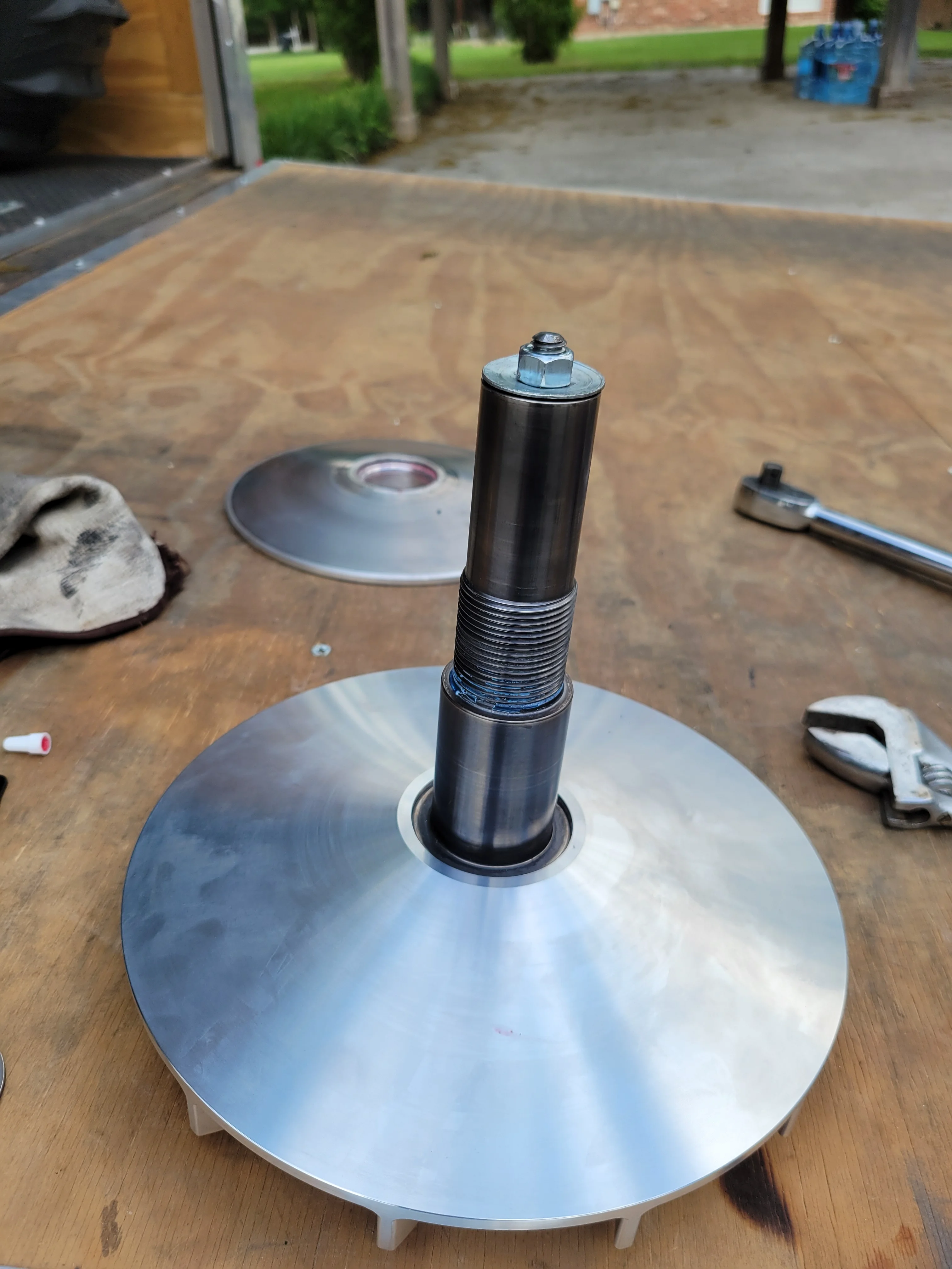

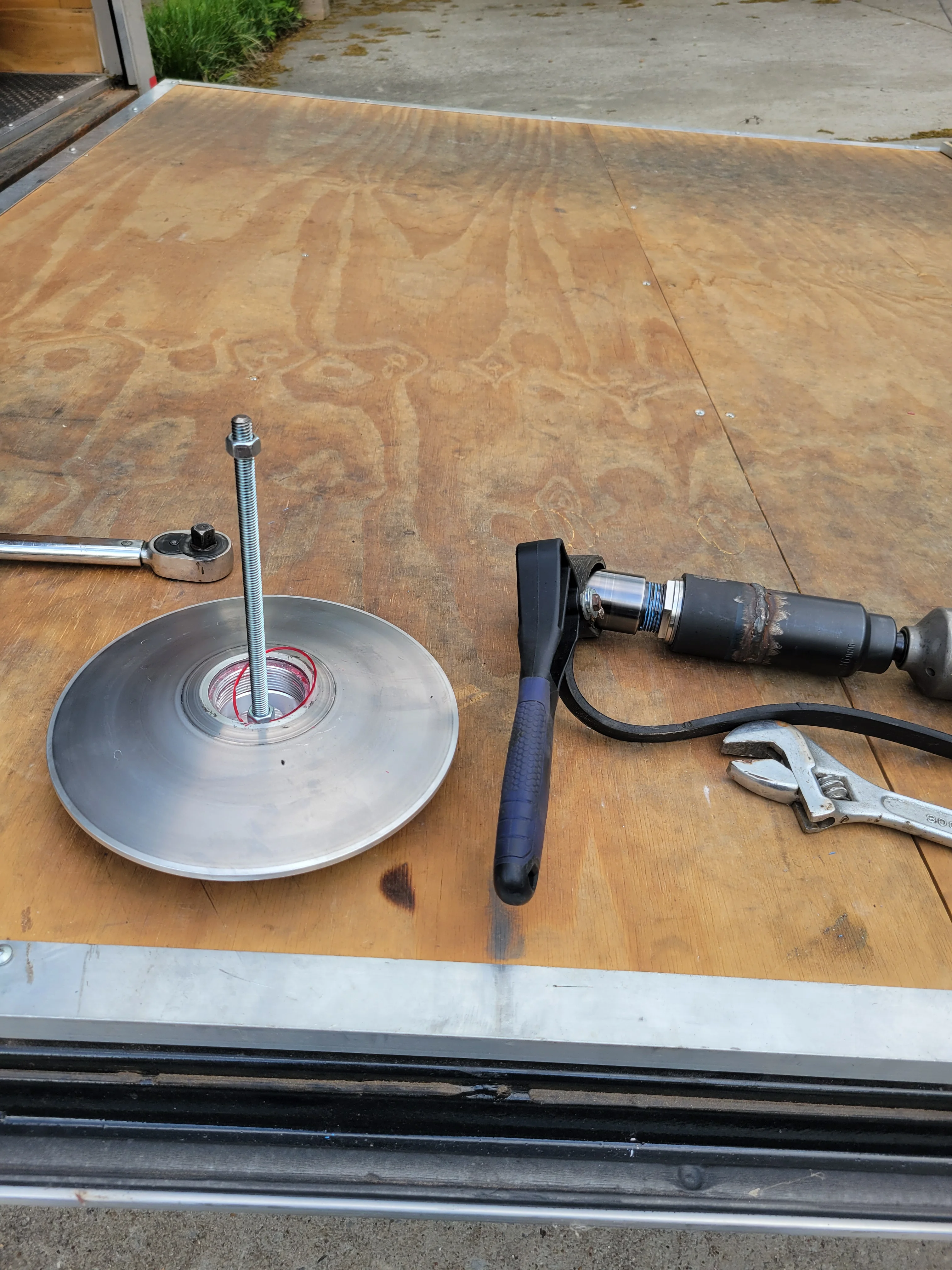

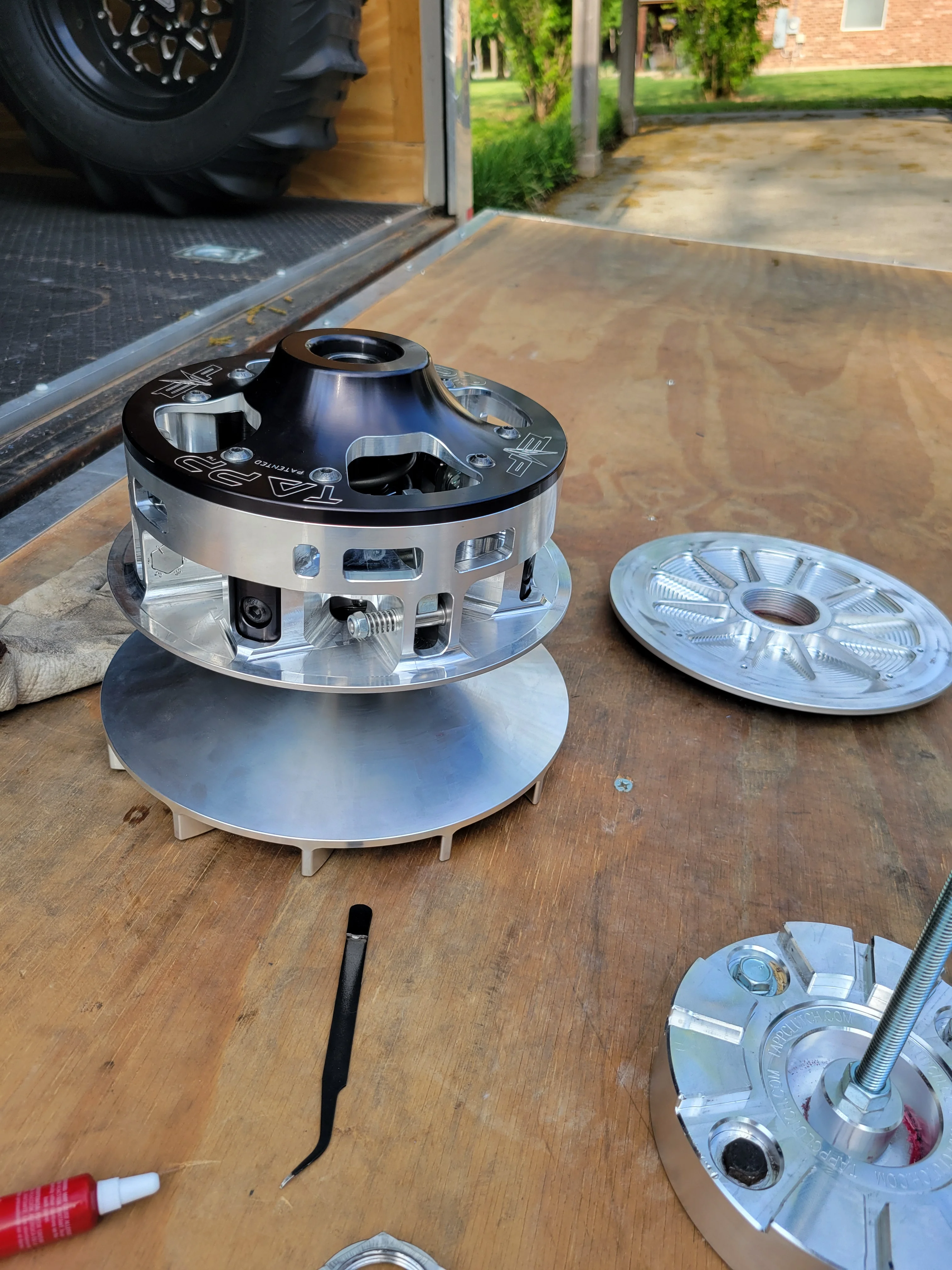

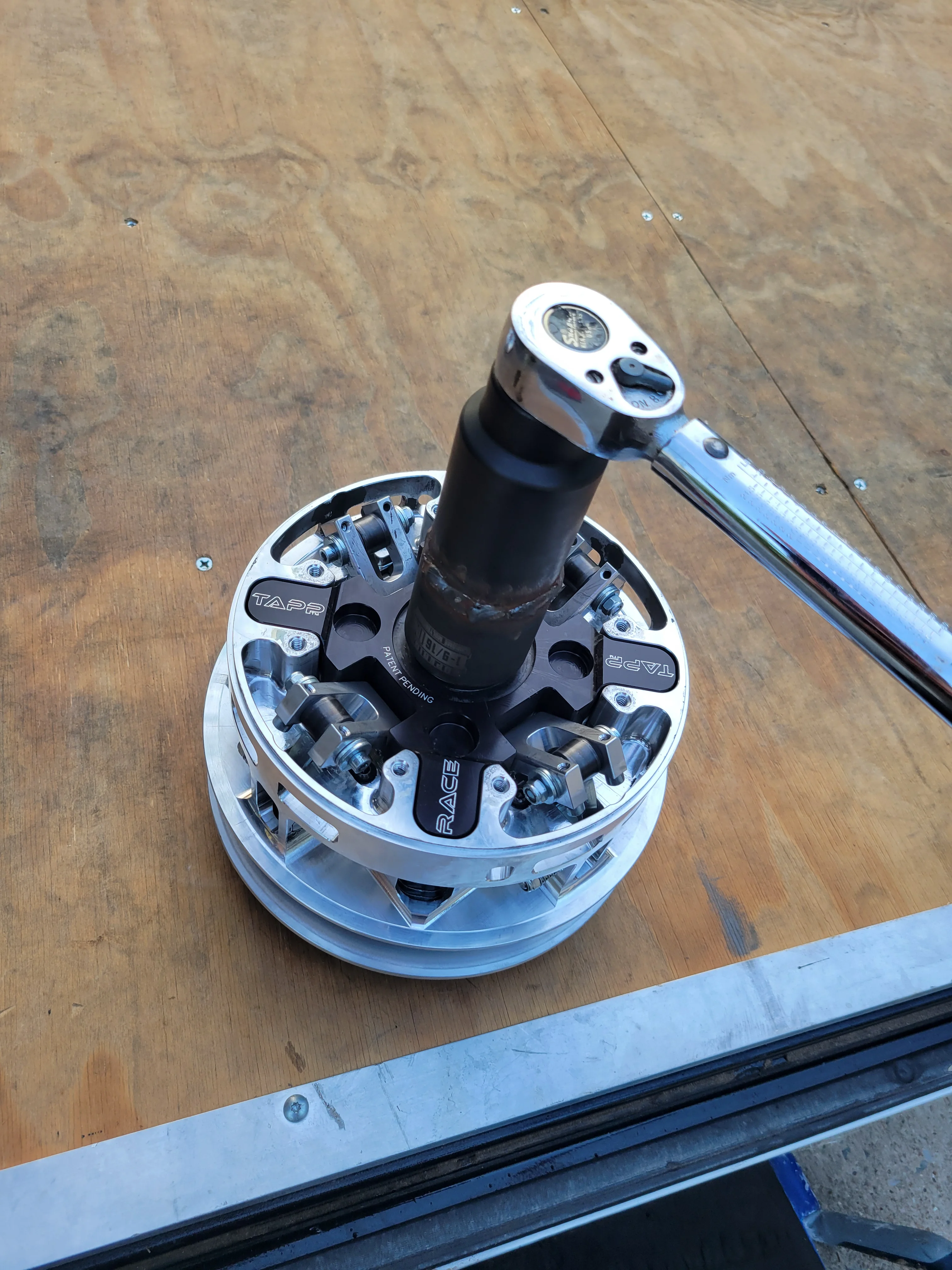

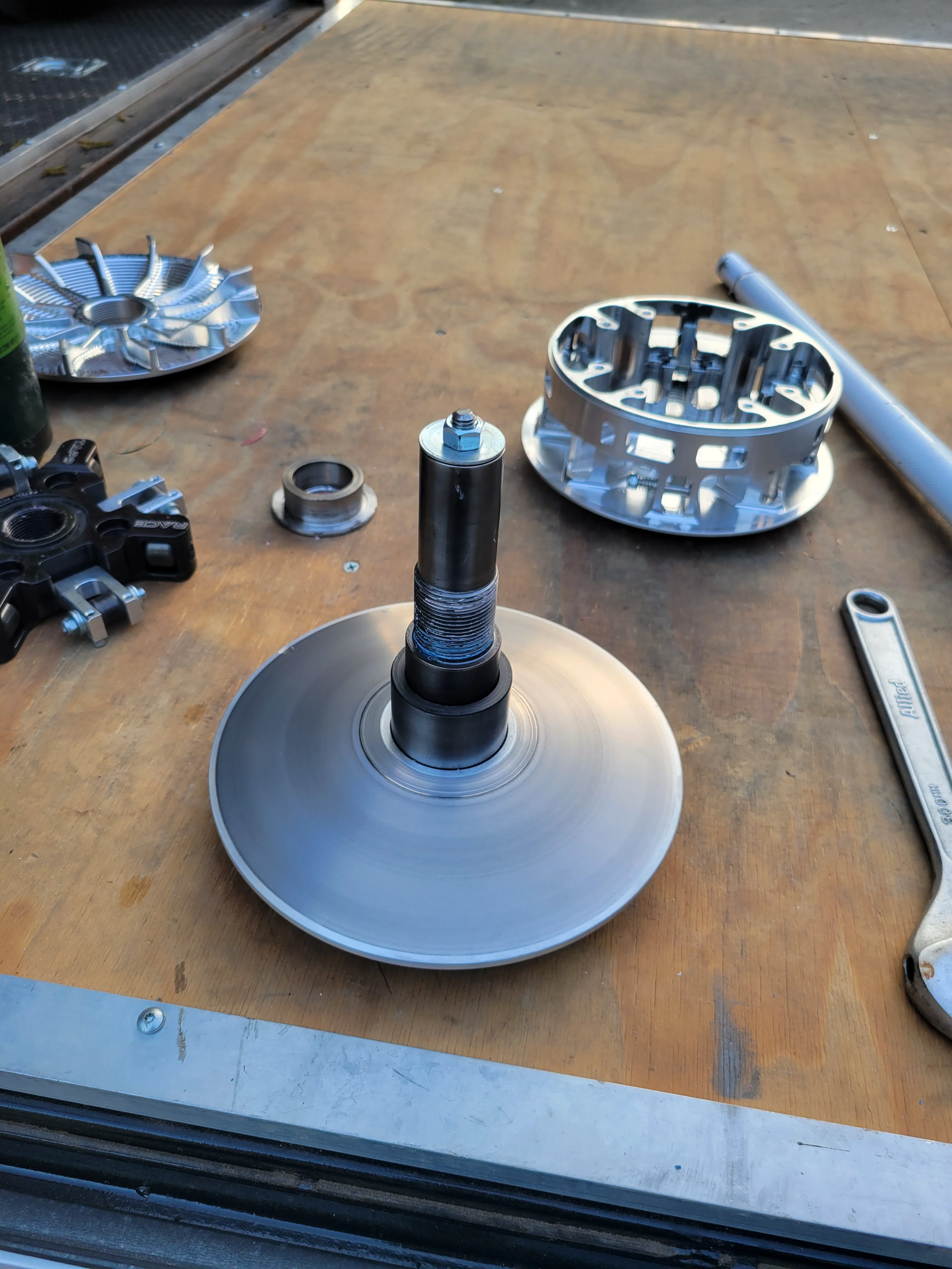

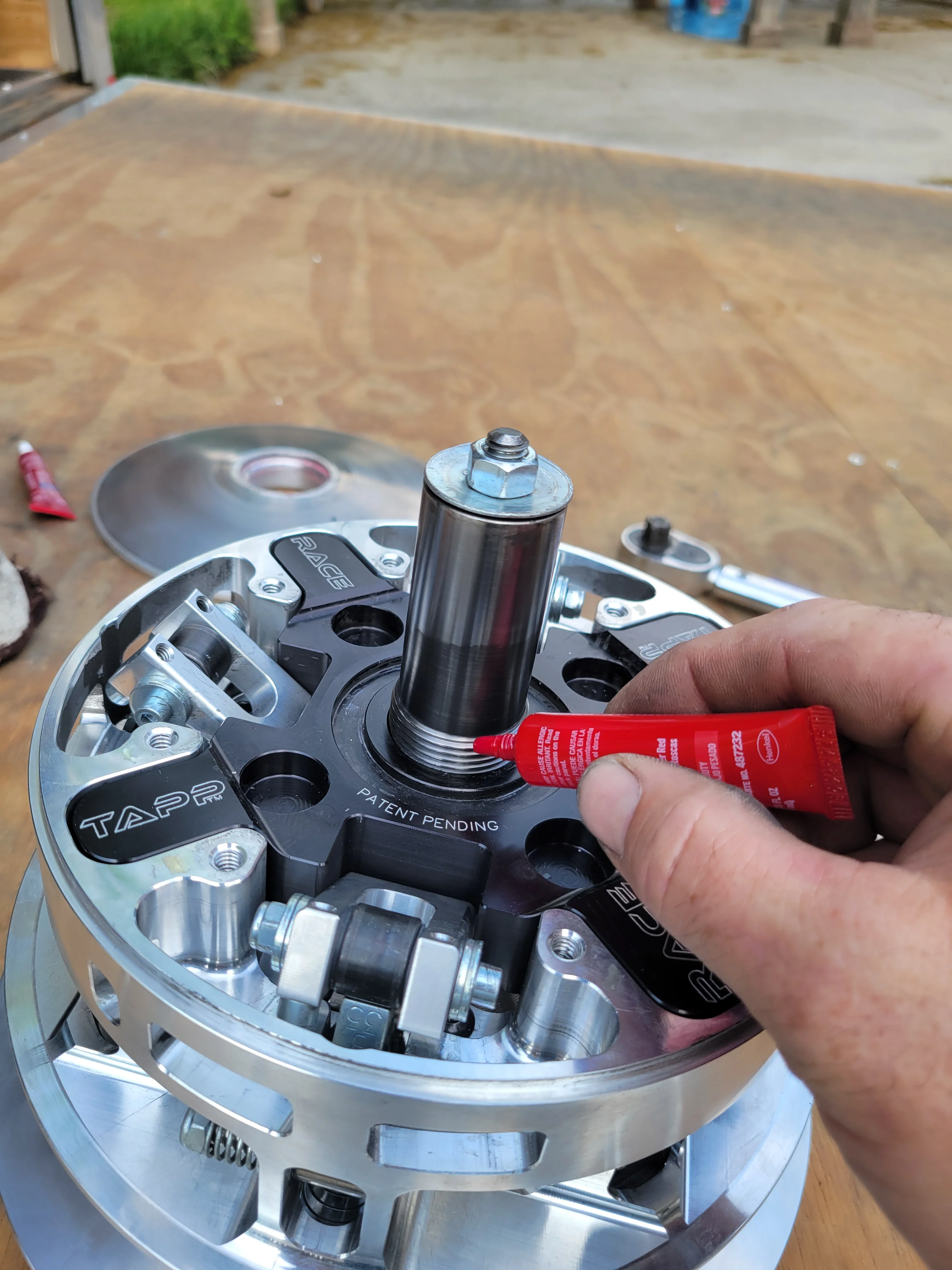

Its not to bad.. 30 min tops. Evo sells the tool needed to hold and disassemble.. You will need a torque wrench up to 130 ft lbs. One big socket 1 9/16. And a torch. And of course loctite.
Yes, I got the sheave from Tapp. Holder and spider wrench from Evo.

Another thing to consider, is the sheave diameter is much larger. I first thought I had the wrong sheave, but realized the bigger sheave has bigger fan blades.. its as big as you can get without hitting the inner housing. The belt just doesn't ride to the top. I can say it moves alot of air now. Seems more than the RPM fan at idle. Definitely more at higher rpm. I think the fins will act as a heat sink also.
