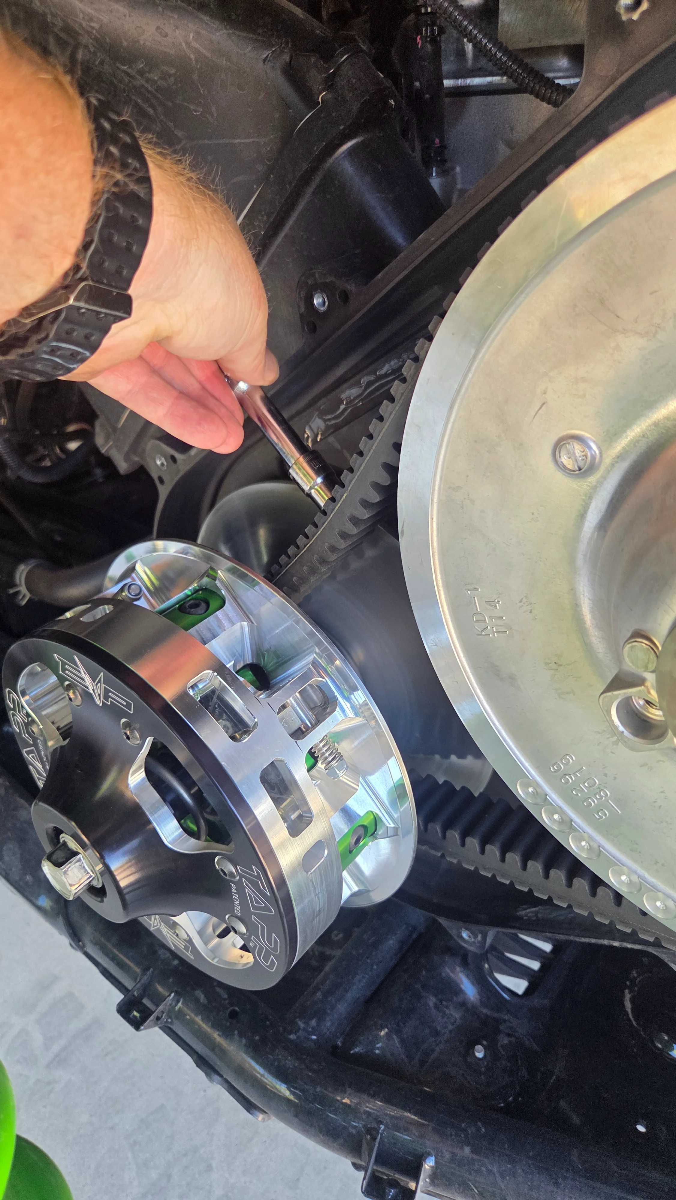

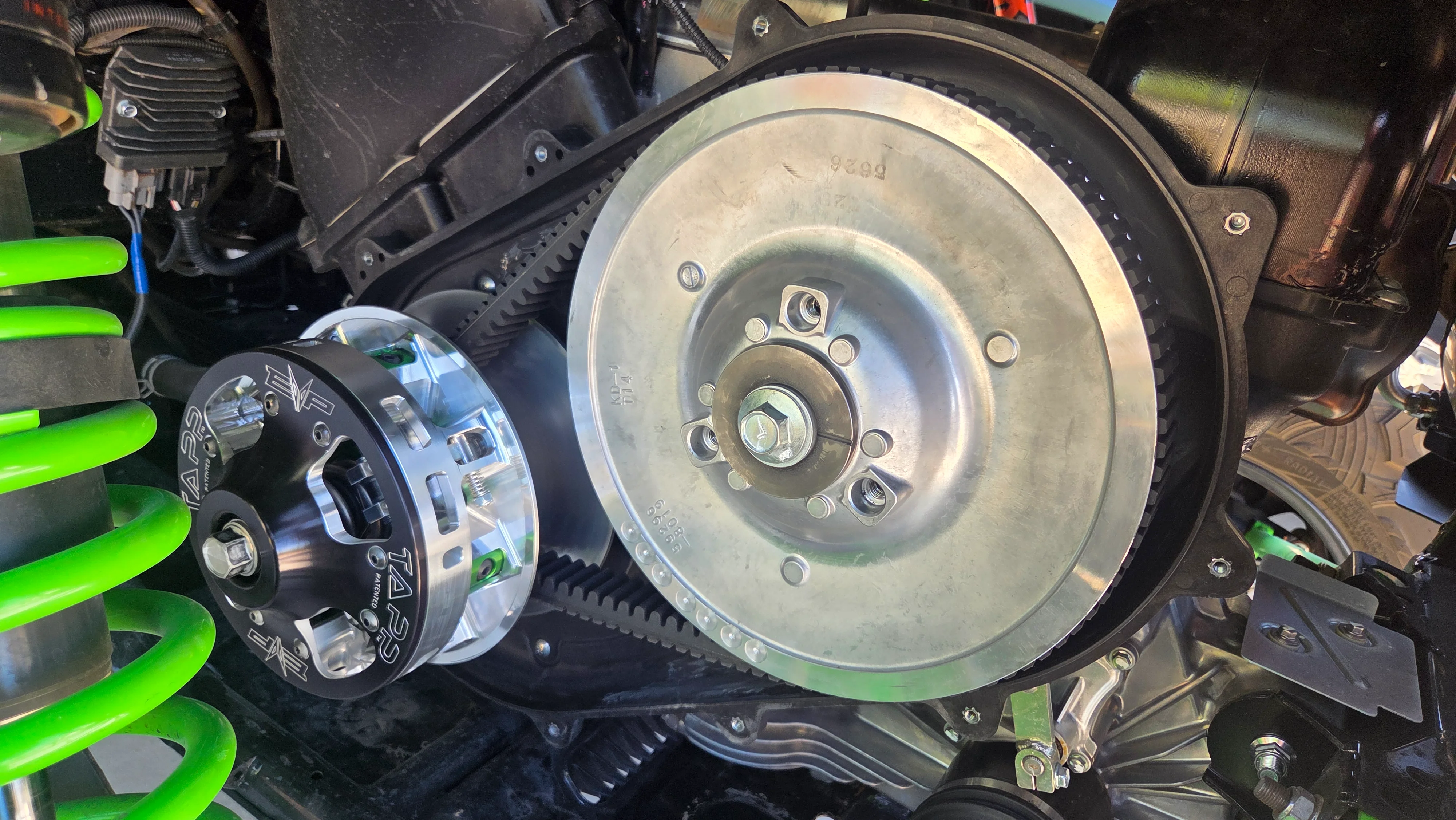

After 150 miles and a few different setups. There's no difference between OEM clutching and adding the Tapps primary. For me both were decent for but not ideal for belt temps. You just have to careful when you got hard. Probably have to add the secondary for more airflow.
This Tapps clutch is great for adjustability. If you had a belt and CVT that could move more air, it would be incredible. The clutch bites the belt hard and it launches fast. If you can manage the belt temps, its pretty damnd good.

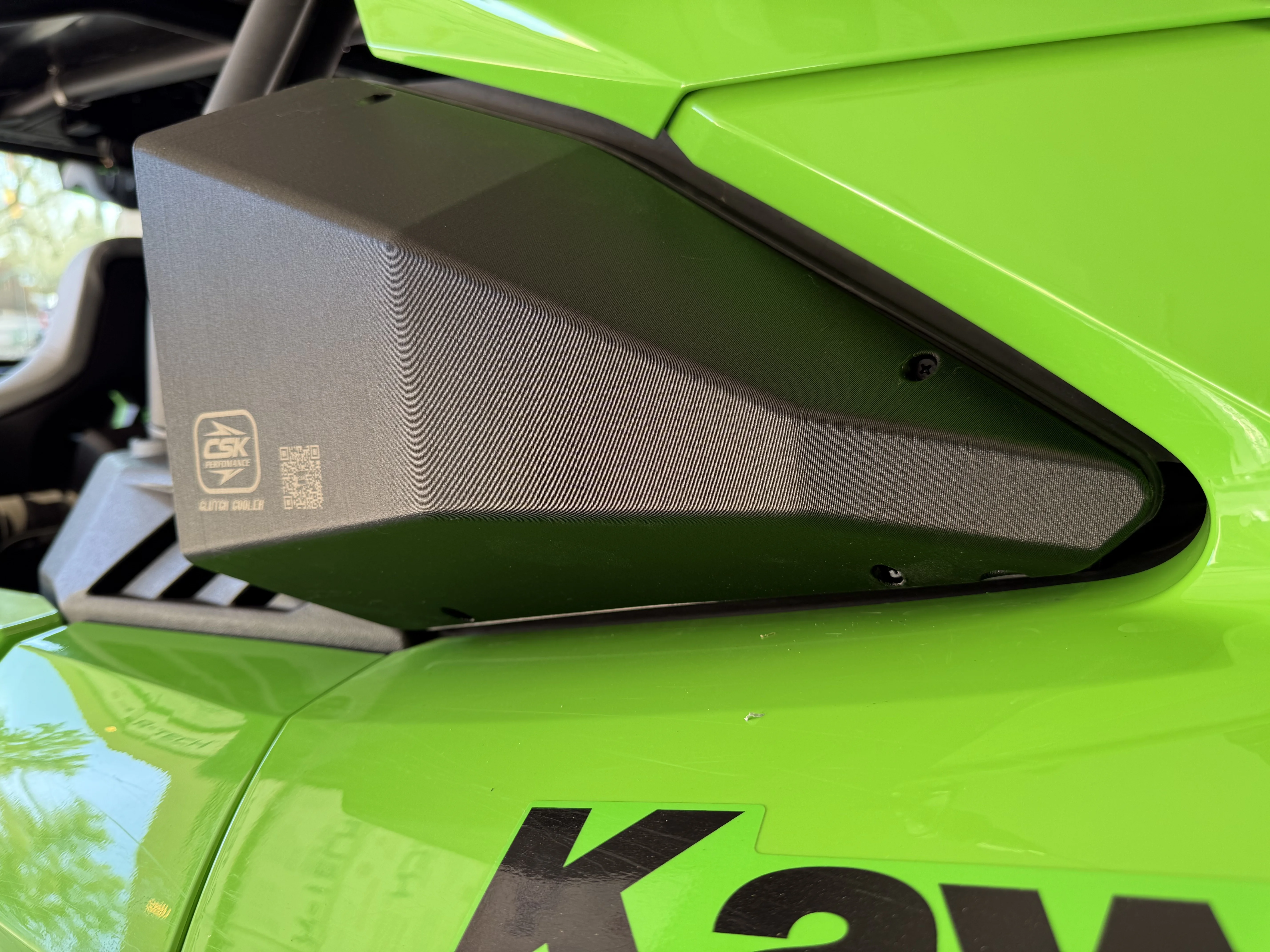

I'm considering one of those inlet fans for the cvt inlet to see what improvements it may provide.
I tried this make shift ram air on the cvt snorkel and it worked a little better above 25 mph, buy may have been working less in the steeper technical terrain.
I know this post is pretty old, but have a look: https://www.cskperformance.com/shop/p/product-2-5c6mb-j8mng-zsl73-se8lp
I think a few companies are out there that also make electric fans for cooling the clutch. RPM:
If you had both I imagine it would help a lot for the dune blasters.
